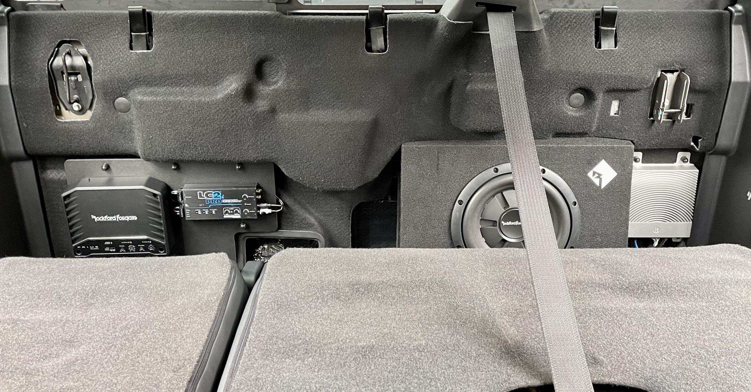

TJ how did you end up wiring the remote on?
And did you do a dedicated power?
I ran dedicated power and ground.
The LC2i-Pro senses signal from the old speaker (sub) wire input to turn on the lc2i-pro and amp
Understood so your really just worrying about speaker inputs and power ground, makes it even easier so it seems.
you run right to the engine compartment for power ground?
TJSparky
Oct 18, 2021
133
WA
2021 F150 XLT (302A) RockyRidge K2
Yes. Both positive and ground are ran directly to the battery. I did this due to the aluminum body and I may add a NAV TV Zen A2B to replace the stock amp in the future.

Hey guys, so I did most the leg work on this unit tonight. The kicker hideaway plus the LC2i.
mounted everything ran my power to the battery and found my ground. Question beingI have to have constant power to both the Hideaway and the LC2i correct? Reading the hideaway literature makes it sound Like I could get a 12v feed from the remote wire?
Currently just have power from battery to LC2i.
Curious about this, as well. One power run to the battery (positive AND negative) and then to a distro block? Use the distro block for powering the LC2 and the amp? Or are you splitting the power some other way?
Actually found a few diagrams where people are running the power from the battery (8 AWG) directly in to the amp and then running 18 AWG wires from the power terminals on the amp to the power terminals on the LC2 with a 1AMP fuse in between.
Still curious how others here have done it.
Actually found a few diagrams where people are running the power from the battery (8 AWG) directly in to the sub and then running 18 AWG wires from the power terminals on the sub to the power terminals on the LC2 with a 1AMP fuse in between.
The LC2i only draws 150mA and calls for a 1 amp fuse. I'm planning to tap off the power from the oem dsp/amp unit. That way I'm not relying on the sensing remote on, I've heard any DC offset on the inputs can make them turn on inadvertently.
This is what I decided to try, ordered a distribution block on Amazon (positive and negative split) 8 gauge in from battery and will split 10 gauge feeds one set to the Hideaway (amp for some) and one set to the LC2i. Would not see why this wouldn’t be a clean easy solution. Will let you know
Do you know which wire and in which of the two harnesses provides the power to the factory amp?
