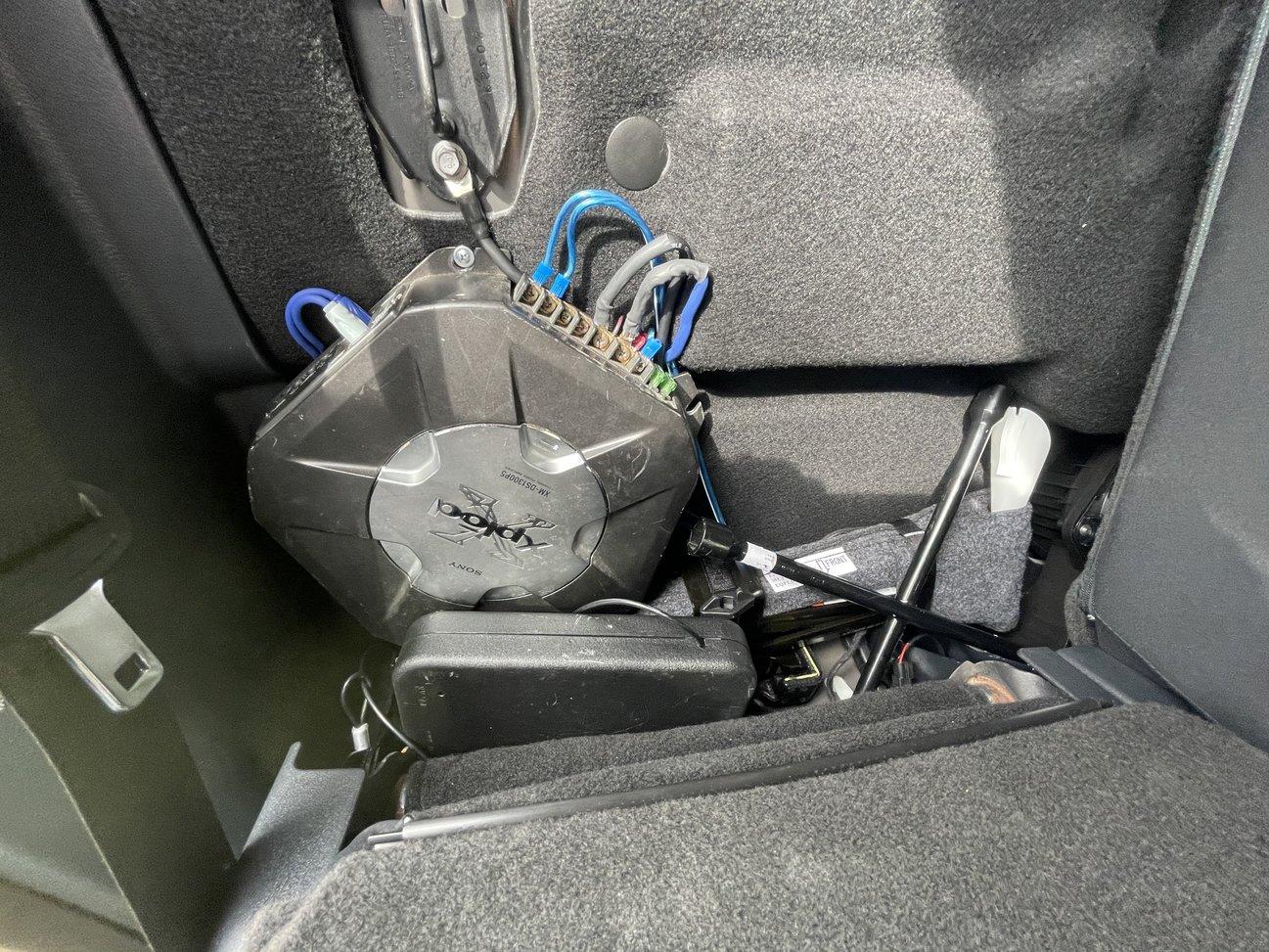

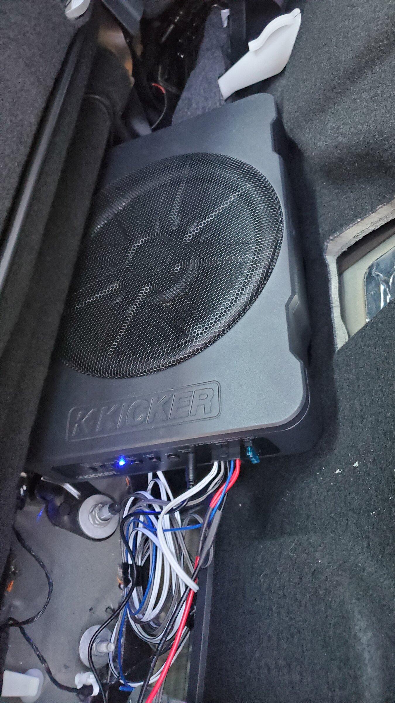

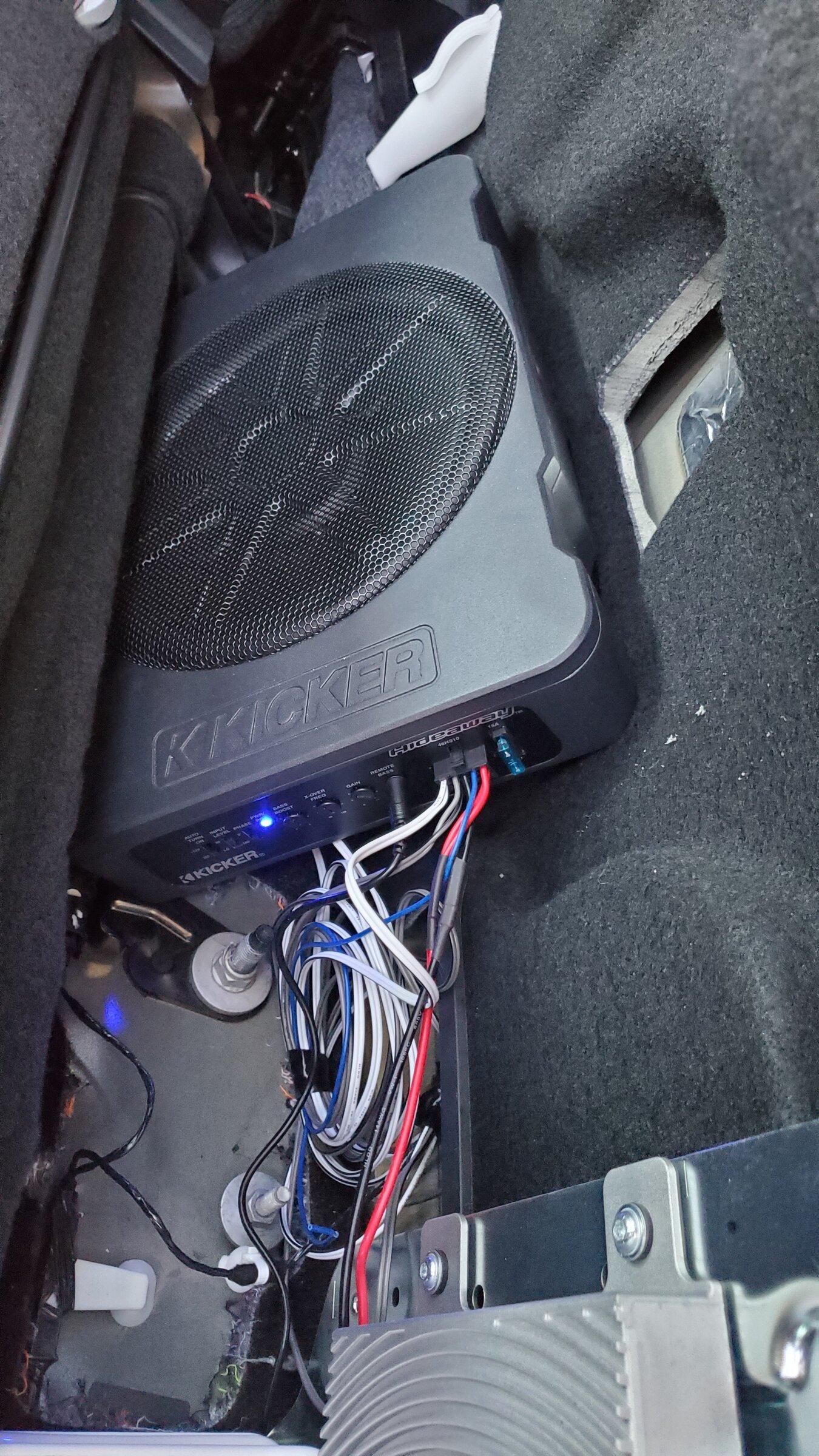

Here are a couple of photos. I haven't bolted the kicker down yet, time was tight. One piece of advice, the kicker positive lead was not long enough to go from behind the SCrew rear seat, down the door jam, through the firewall (used hood releasd grommet) and to the battery, had to add a little more wire.

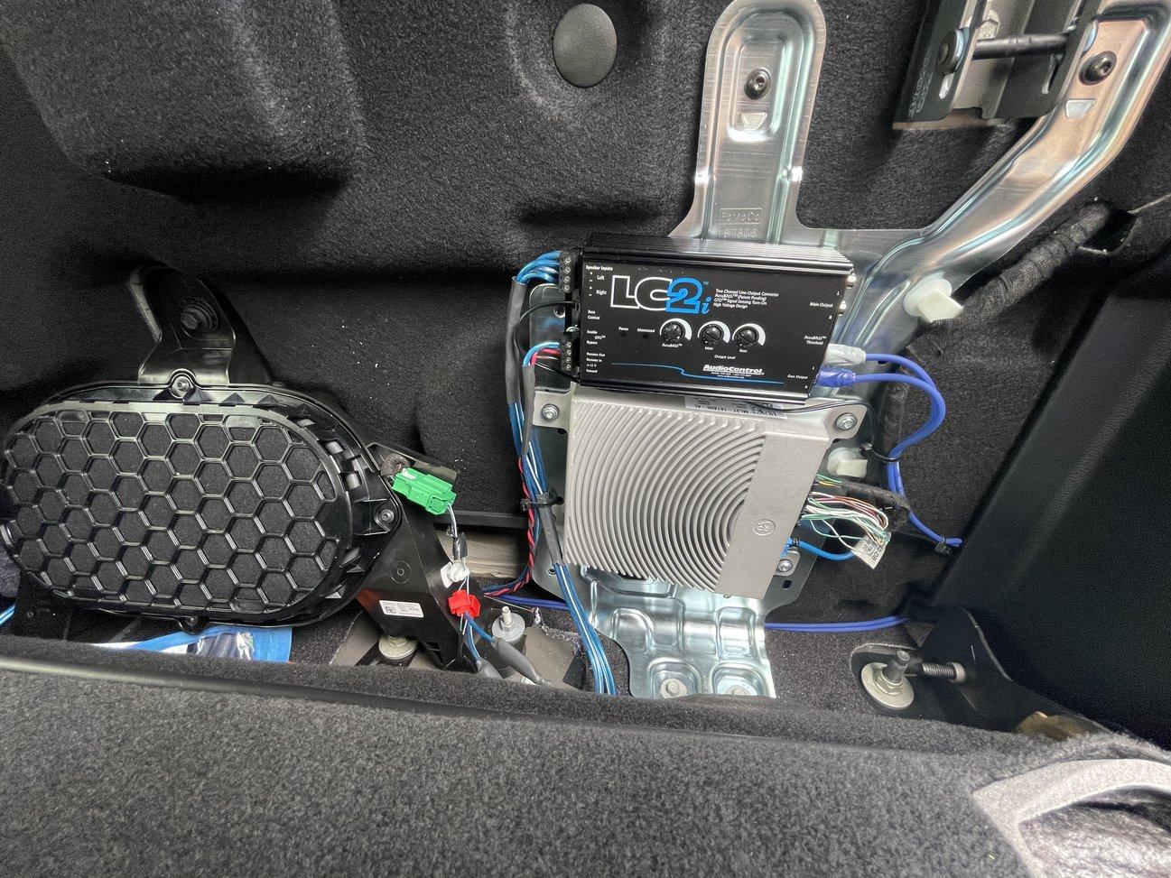

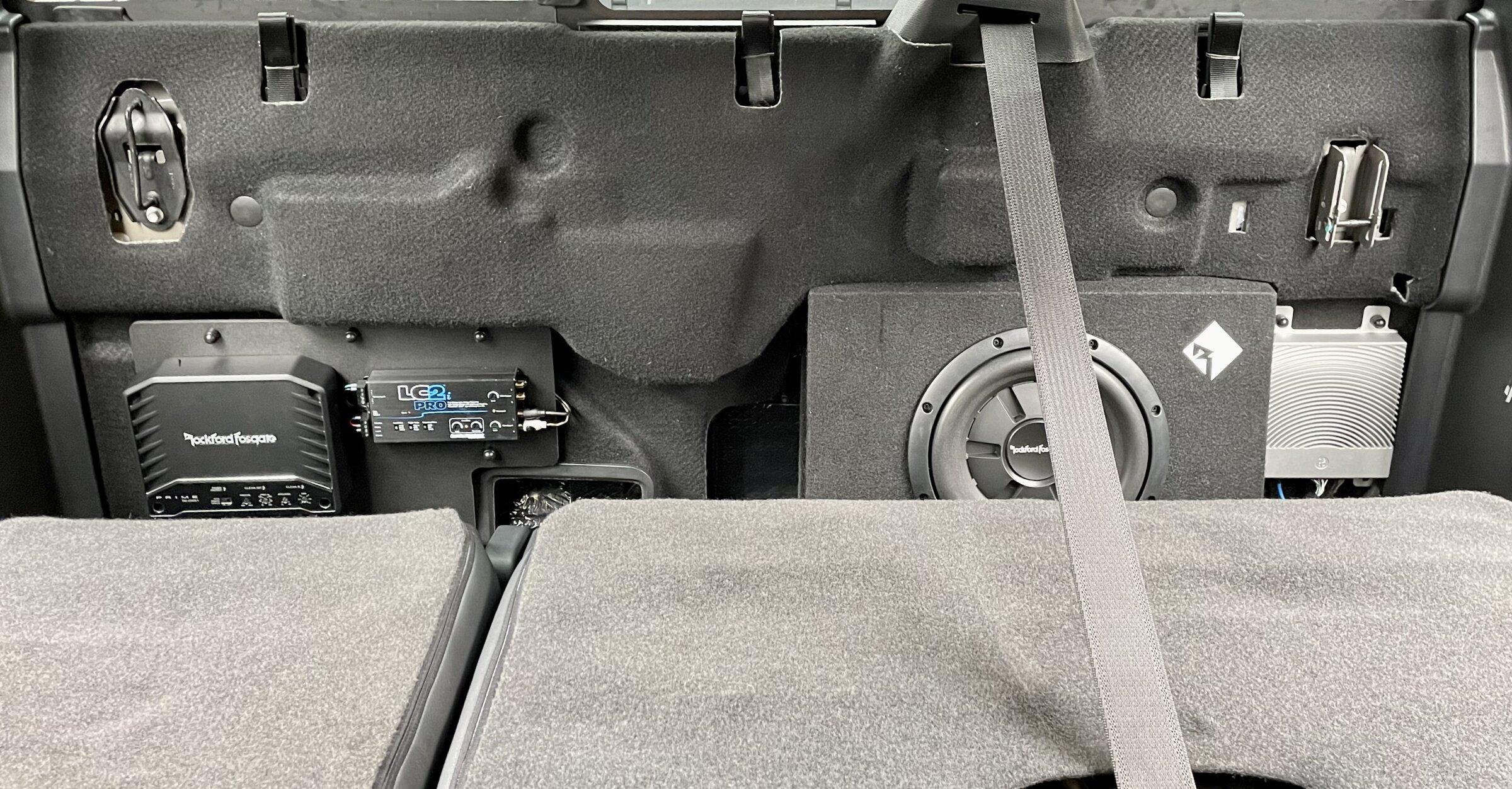

I pulled these from another thread on F150fourm kudos to a 'Oscare' who posted them. This is using a separate amp and sub but again i'd wire it to the kicker hideaway.
This is tapped after the amp just before the stock sub connector. From what I can see he tapped both positives from the LC to the Positive on the stock sub, Both negatives on LC to negative on stock sub.
The rest is a little tough to see, Im no audio guru so these are my uneducated assumptions;
- LC2 remote out ties into the kicker remote on.
- LC2 remote in? would you need to tie in the stock amp remote to this?
- Positive feed, can i pull off the stock amp or better off dedicated/fuse box?
- Negative you guys mentioned threes a few screws for grounding.
LC2 Bass output RCAs to the Kicker hideaway (I was going to add the Kicker KISL RCAs from the hideaway harness so I can just plug them together)
27992e71_dbd5_4461_9b5d_f640b6f60b37_dca214e957e1a7ed9bcd9e354e93481a8aaa9de4 (1).jpeg
"This is tapped after the amp just before the stock sub connector. From what I can see he tapped both positives from the LC to the Positive on the stock sub, Both negatives on LC to negative on stock sub."
This is what I did for mine except I didn't need the LC2i bc my amp has that feature...postive on stock sub is green and grey is negative...Confirmed it works.... Ran a power cable to the battery. Ground to a bolt on the back wall...and the bass is back!
[/QUOTE]
Where did you get remote power from to turn on the AMP?

Thanks all. It definitely sounds better than the baby sub they put in.
