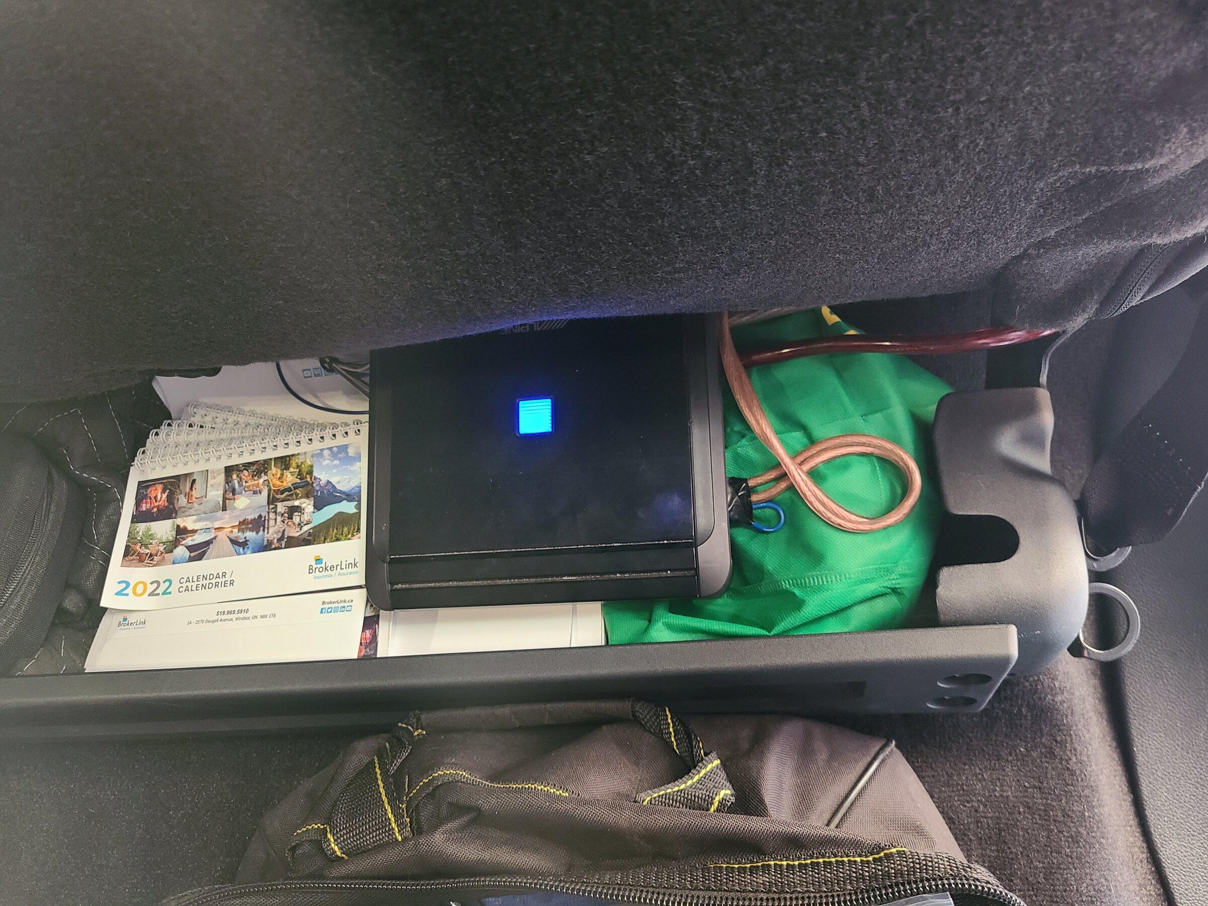

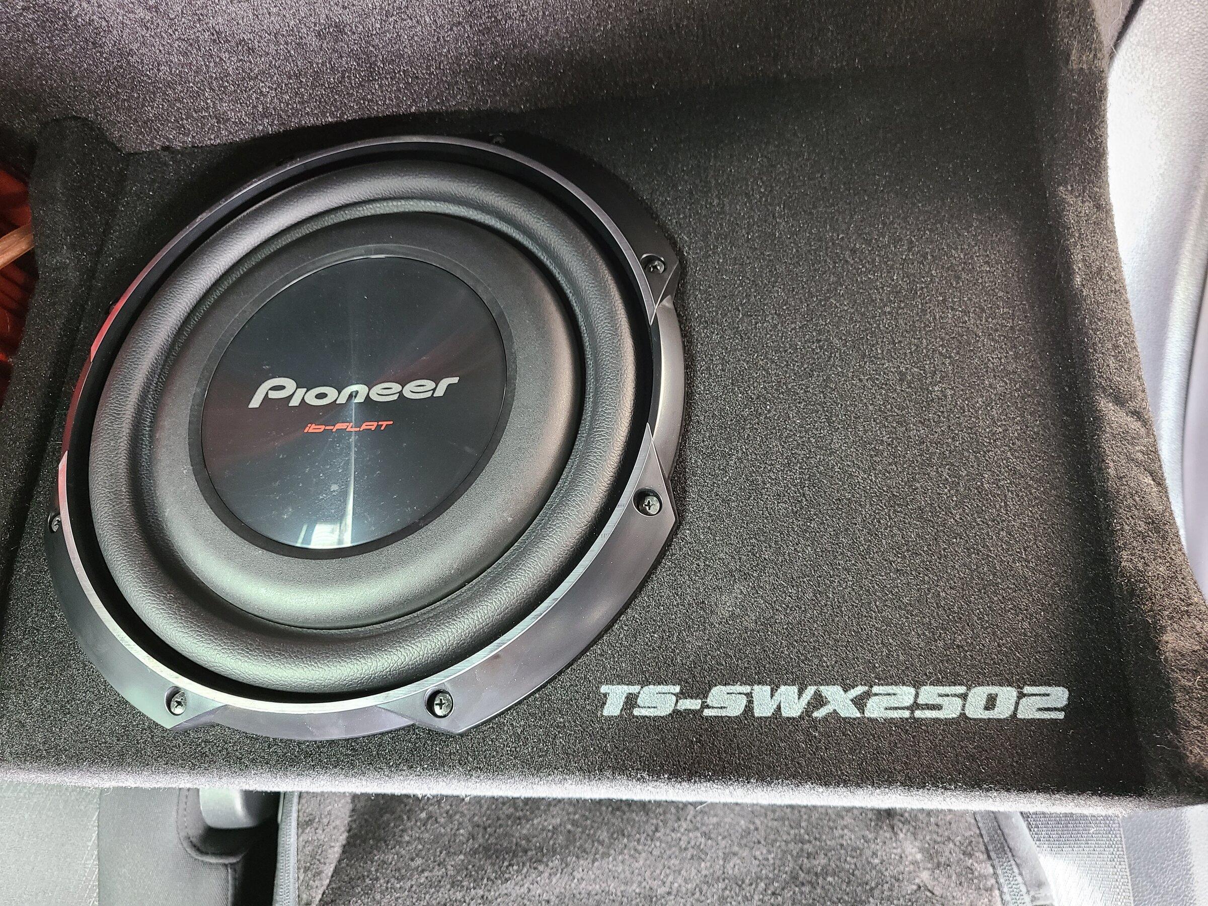

I added my 10" sub and Amp that I had in my 2013 F150. I have the B&O non unleashed. Very easy install. I still have to tidy up the wiring etc but ran out of time today.
Huge improvement over stock sub.

Do you mind me asking what 10" sub you're using? It looks similar to a downward firing Kicker sub I've been thinking about. I like the idea of being able to fold up the seats and still sit something on top of the sub so its not wasted space.

I agree. I have full use of the back except under the 1 seat is this box but I can still put stuff on top of it if I need to.

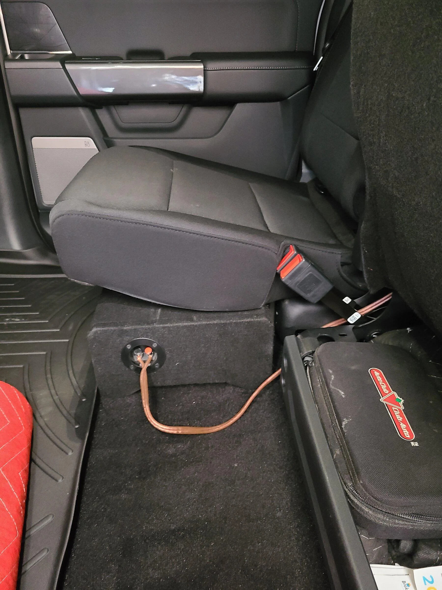

Here are a couple of photos. I haven't bolted the kicker down yet, time was tight. One piece of advice, the kicker positive lead was not long enough to go from behind the SCrew rear seat, down the door jam, through the firewall (used hood releasd grommet) and to the battery, had to add a little more wire.

Sweet, so looks like it will stay at that angle when mounting it? May just have to bend the brackets.
Started looking into power options, there's a fuse bank in the passenger footwell. Looks like it has spare/unused fuses ranging up to 30A. Bought a fuse tap pigtail and was going to try that for power instead.

Used the bolt that holds the seat back release bracket, looking back you could probably use the bolt mounts for the factory sub on the floor.
The angle its at in the photo is the way it sits, i dont hear it moving around when driving but i would like to attach the brackets to the top at least.

There is a factory ground you can use behind the carpet on the back wall. A few inches to the right of the seat bracket
