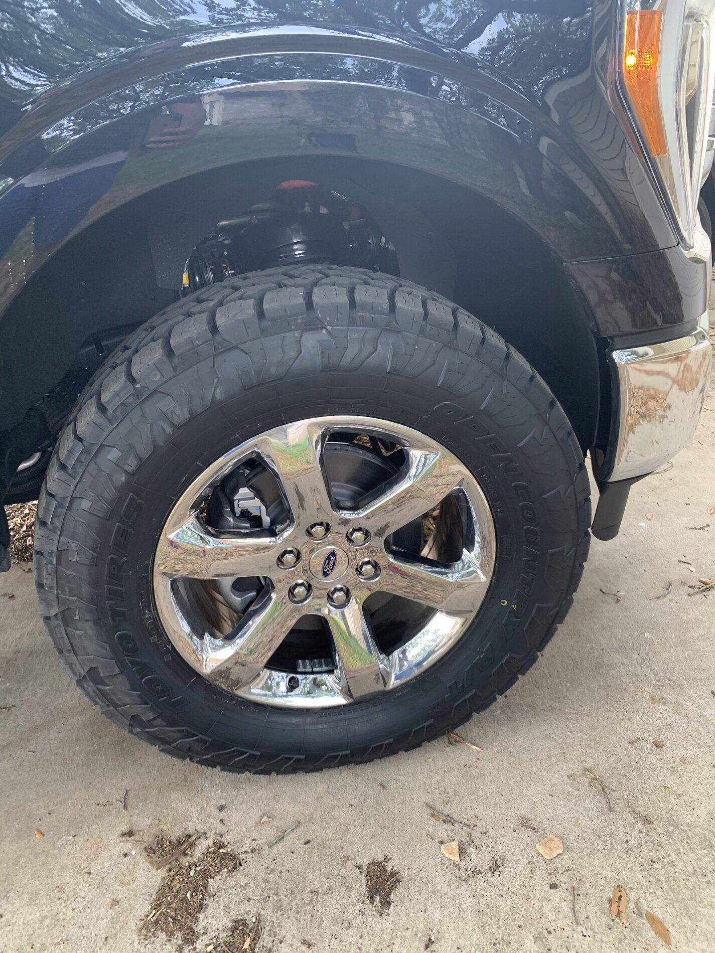

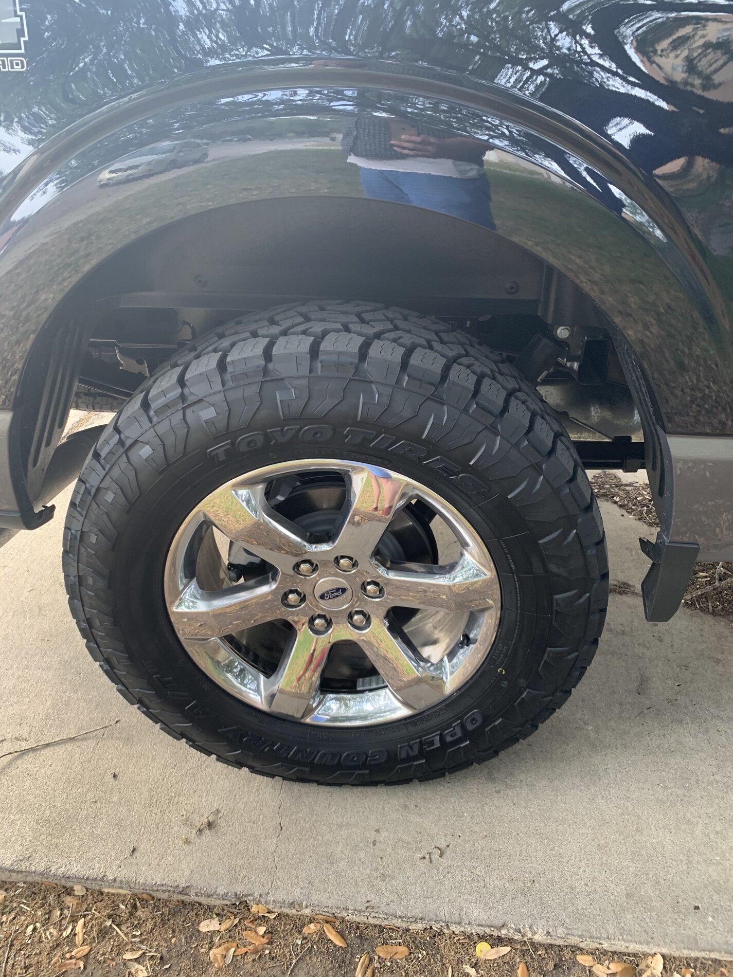

I have just put on toyo at3 295/65 r20 on stock wheels.
I have a 2” level kit.
There is probably a solid 1 inch from the crash bars in the front.
I would say you if I were to be at full turn and depressing the shocks fully I would rub against the air dampener and that’s about it.

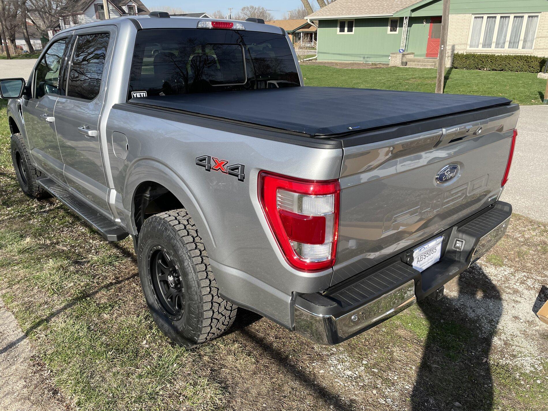

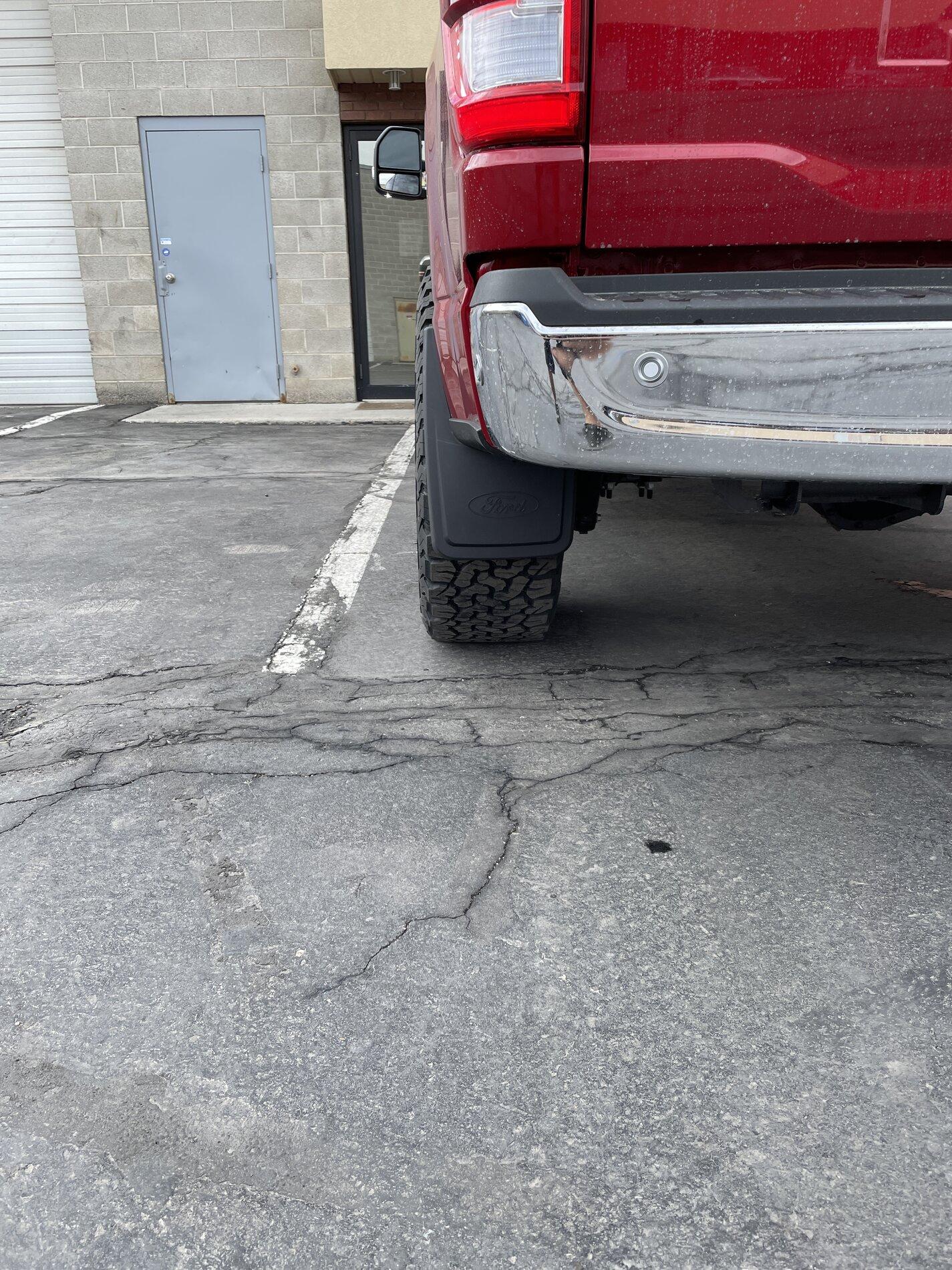

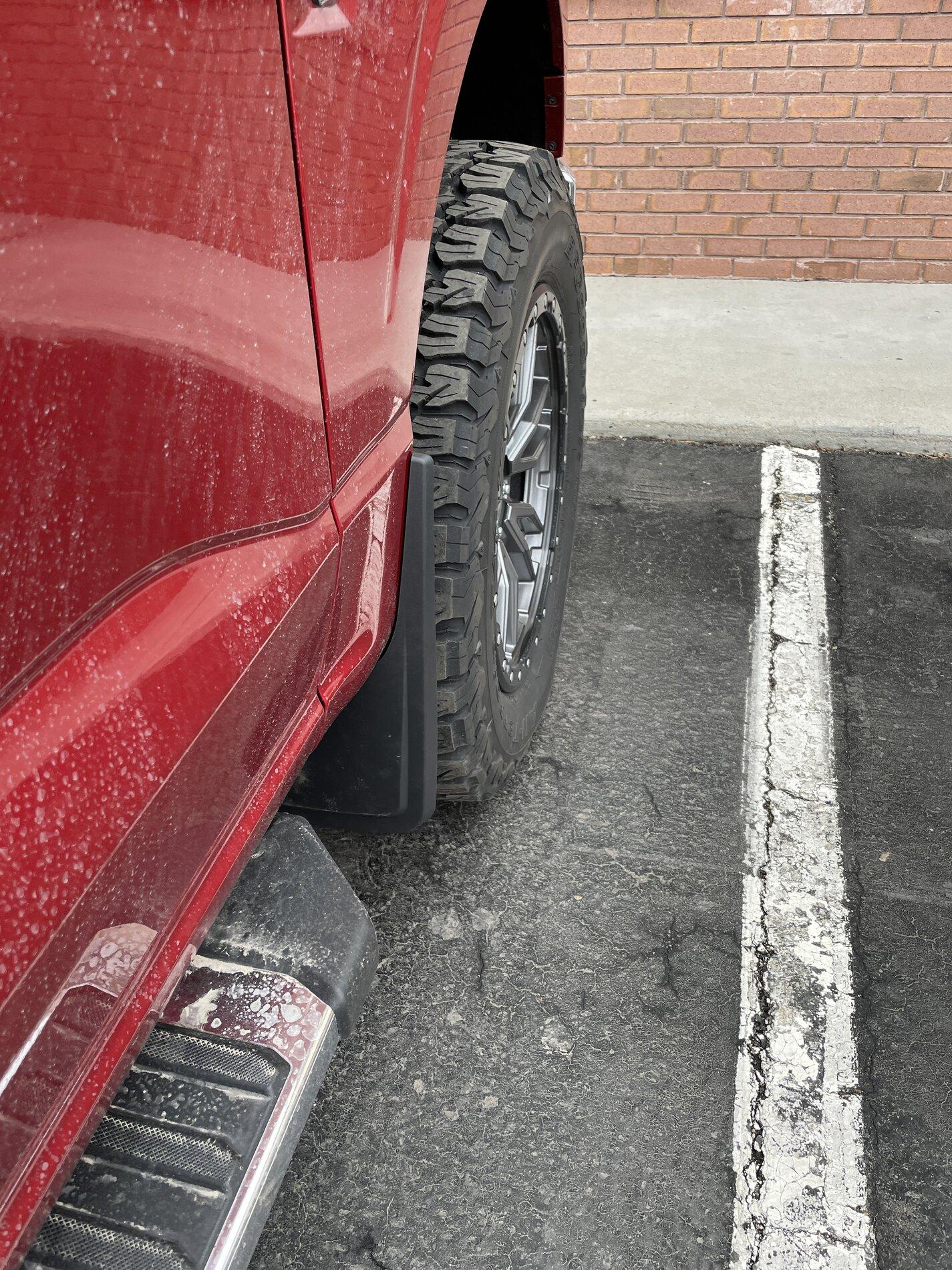

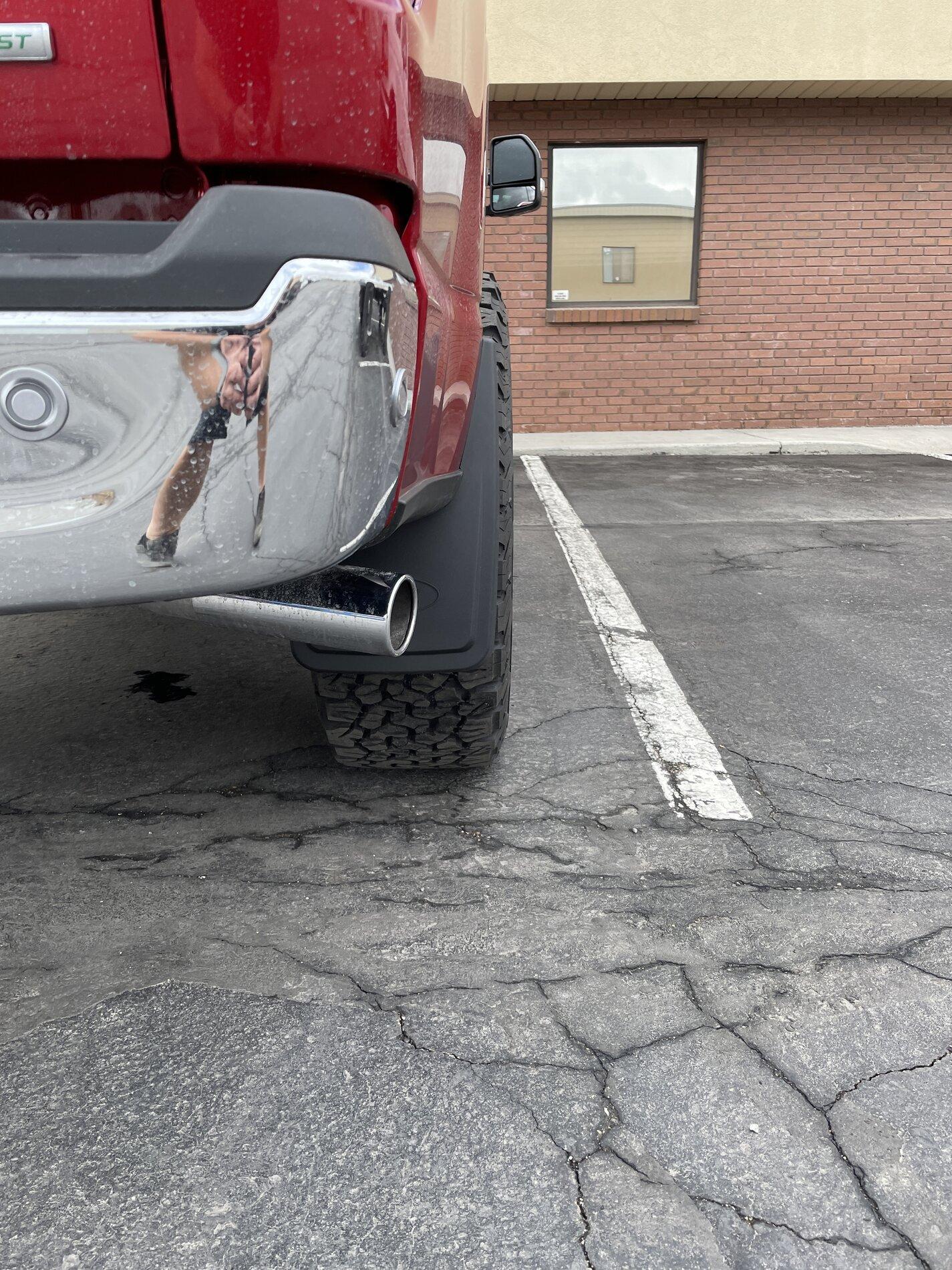

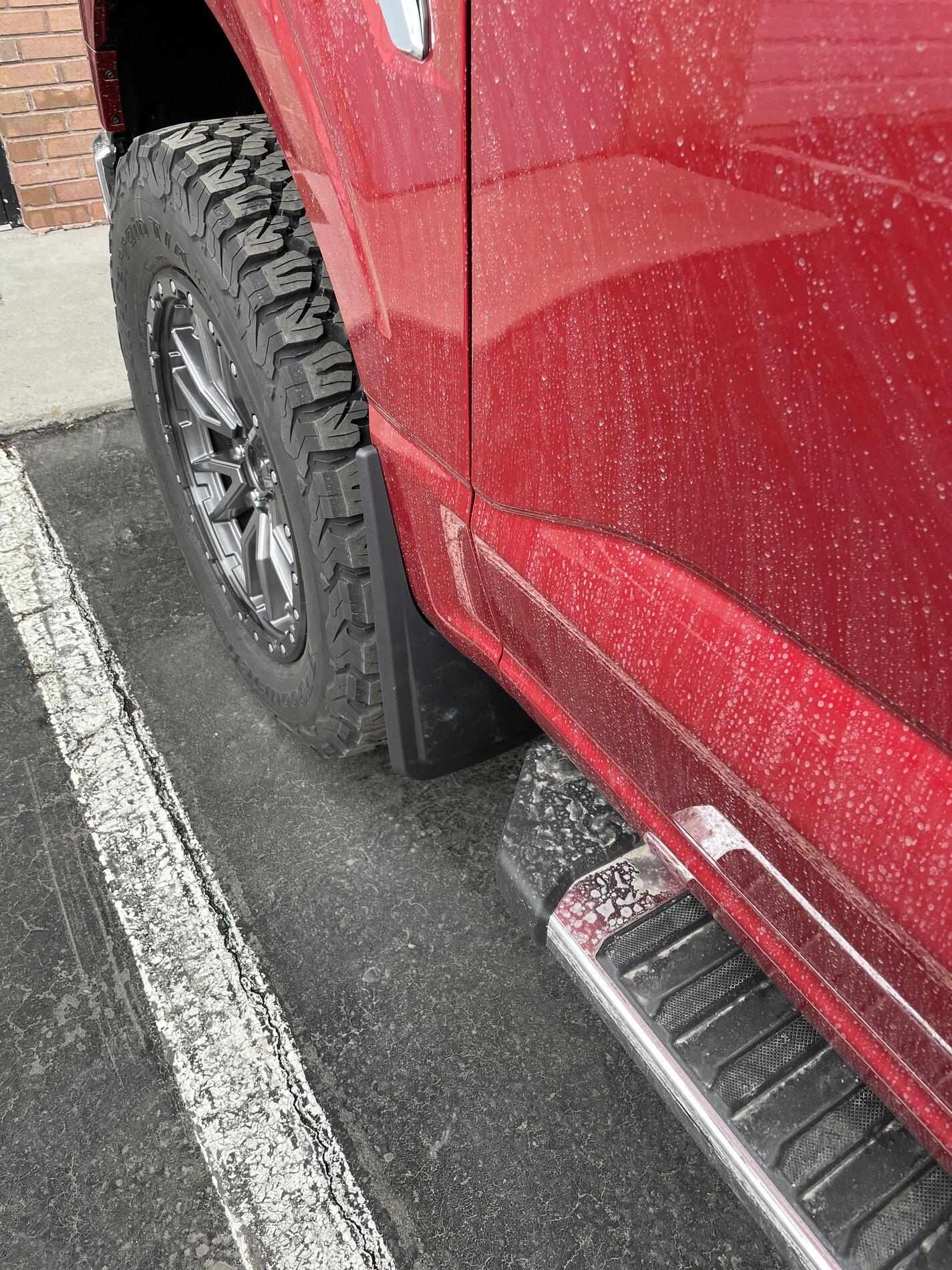

Thank you for all of your info. This is great. You know your stuff. I just need to decide lol. Now with the mudflaps on, the poke doesn’t seem to be as bad as I thought.
Could you post a couple front & rear poke pics with your mudflaps on? I'm still on the fence btwn 285/60R20 & 295/60R20. Thanks

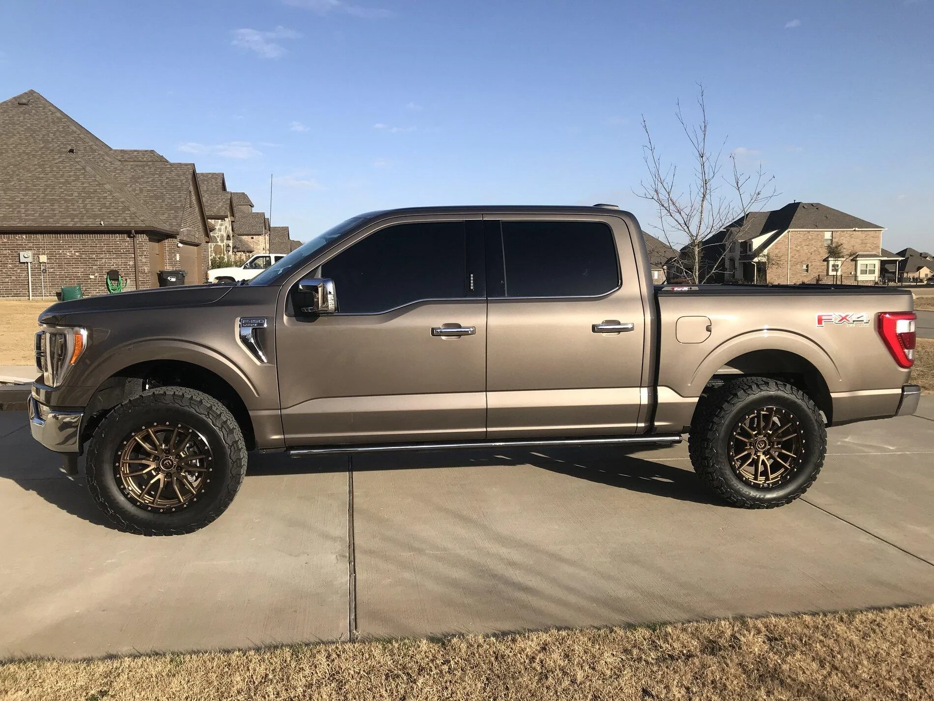

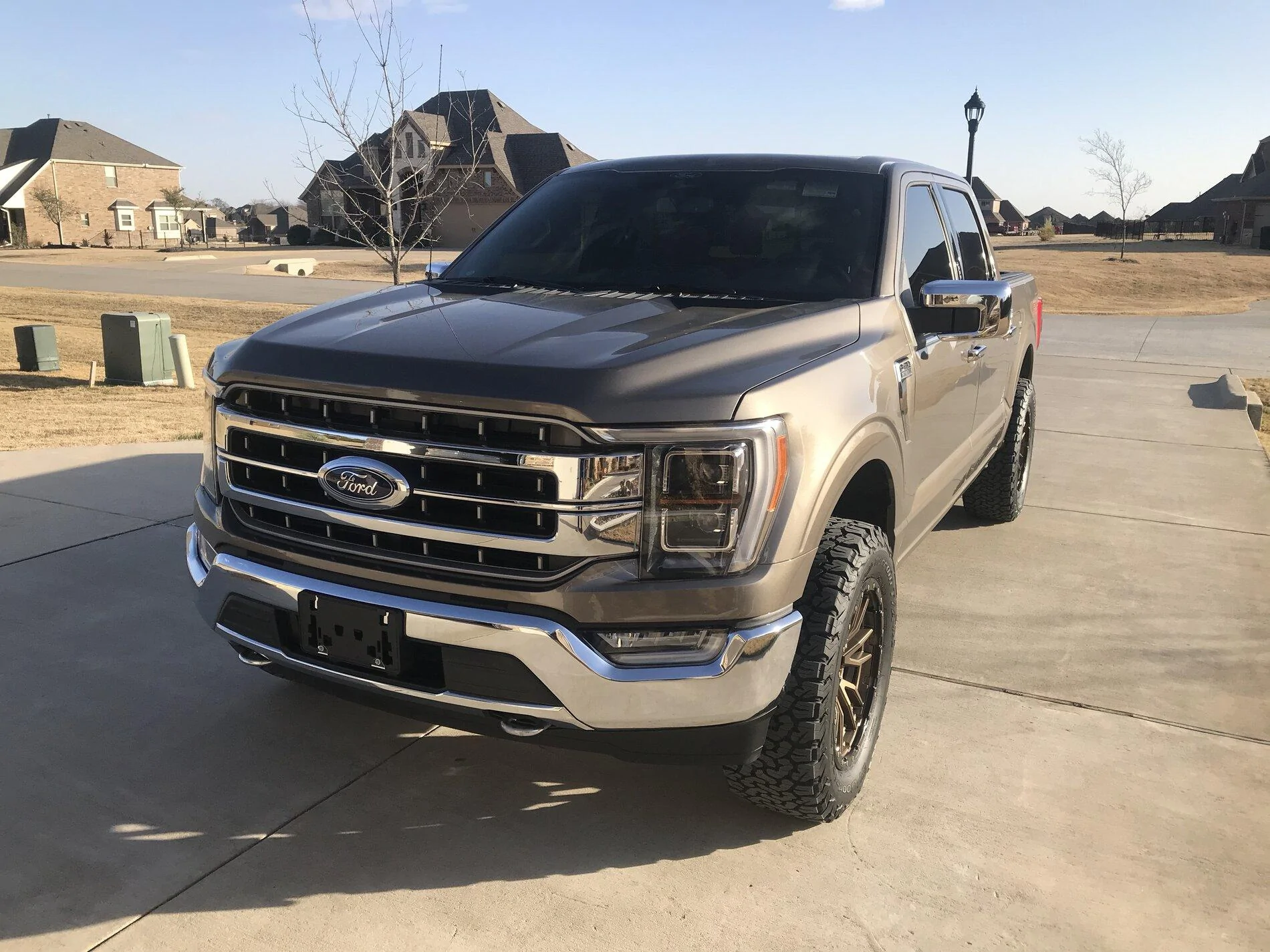

2.25" Readylift Level, 20x9 Fuel Rebel 6 with +1 offset, 295/60/20 BFG KO2 tires. Had to remove the front crash bar and trim the lower valence plastic just a little, but a 34" tire fits.

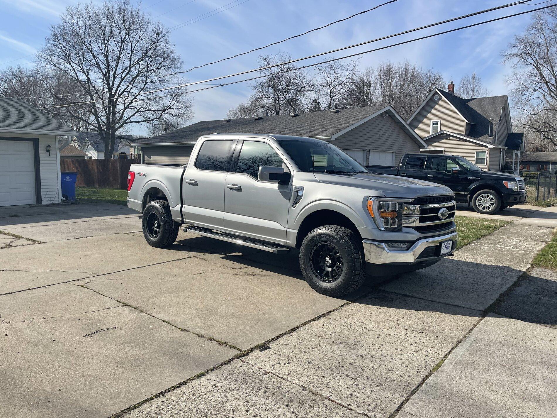

285/70/17 Toyo Open Country AT3 on +12 backspace wheels.
Good looking rig @mason1646
Do you have any lift/level on this whatsoever?
Reason I'm asking is i'm looking at almost identical build however with 285/75 17 with the 2.25" lift
Pretty confident it should accommodate without crashbar removal but your build is an educated guess at what Ican expect

Looks good - how much do they help with road spray?
The poke does not appear to be out past the mud flap no the steps - if the tires are not throwing rocks you might be good to keep what you have
I think you are right about keeping them. I just put the flaps on yesterday, so I am pretty optimistic that they will work. Im torn about switching tires as even though that other size you said should work, it still may not, and these do, albeit a little poke. I think between the flaps and putting a little stone guard on that lower panel, I should be fine.
I have a 2” level. You’ll be totally fine with that size tire. I believe Wild Willy on YouTube had that exact setup.
