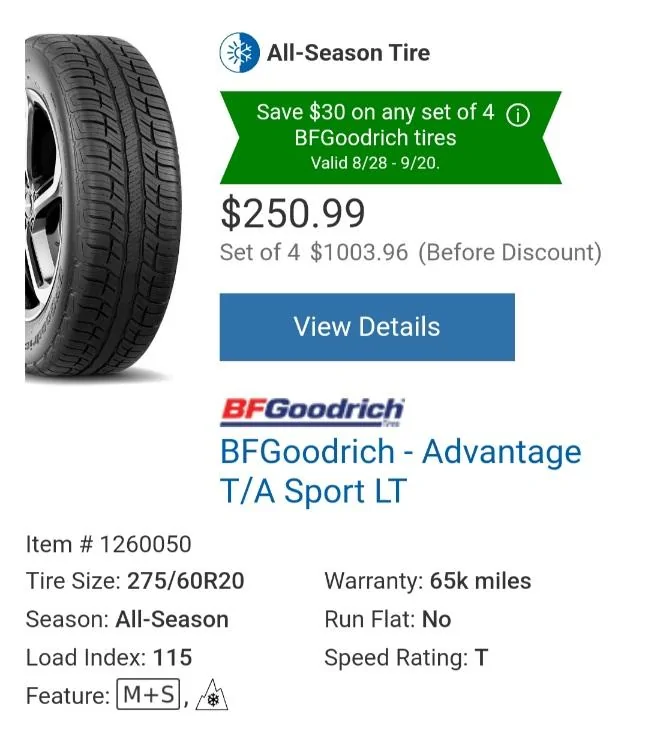

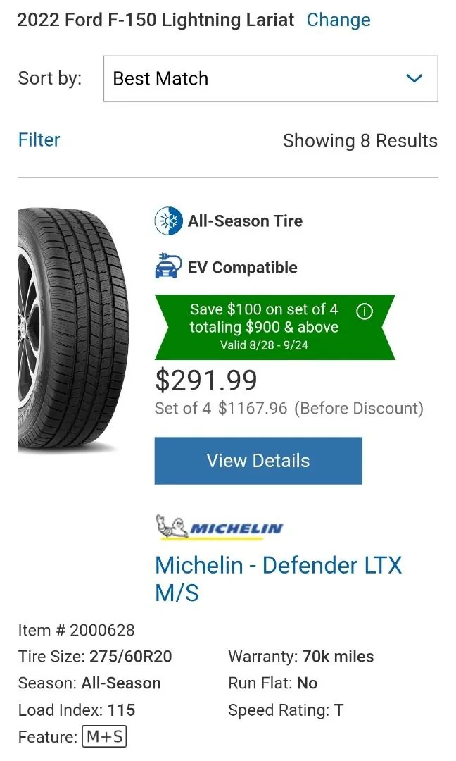

Mike....if you're a COSTCO member, I will look at the Bridgestone or Michelin tires for EVs.
They are better than what is now on your Lightning.
3,741
6,778
Will Costco install them? I've heard stories that the tire has to match the specs on the door jamb sticker or they won't install them. 20" stock Lightning tires have a 116 load raring, and the tires sold on the Costco site are only 115.
I think I am ok on that front. The stock Hancoock ATs are a 115T load rating. If you remember, selecting the AT version when ordering back in 2022 also reduced your GVWR of the truck which I assume was because of the ratings of the tire. I was also going to get an alignment done at the same time which I am not sure Costco will do. From their website it looks like I can get them next week which is better than the local ford dealerships.
Shouldn't be a problem. Never heard of COSTCO refusing to installing tires that are specified for the type of vehicle. Double check with them also to ease your mind.
Make sure you mention to them that is a Lightning and they aware how to lift the vehicle. Make sure they know or damage to your battery pack is inevitable. You only going to get new shoes not damage to your vehicle.

There are reports on the Mach-E forums of Costco refusing to install tires because they don't meet the requirements of the door jamb sticker. That's why I'm asking.
jerock
Jerry
Apr 12, 2022
369
362
Kansas
I've heard the same on Costco, that they are very particular on tires matching the requirements listed for the vehicle.
