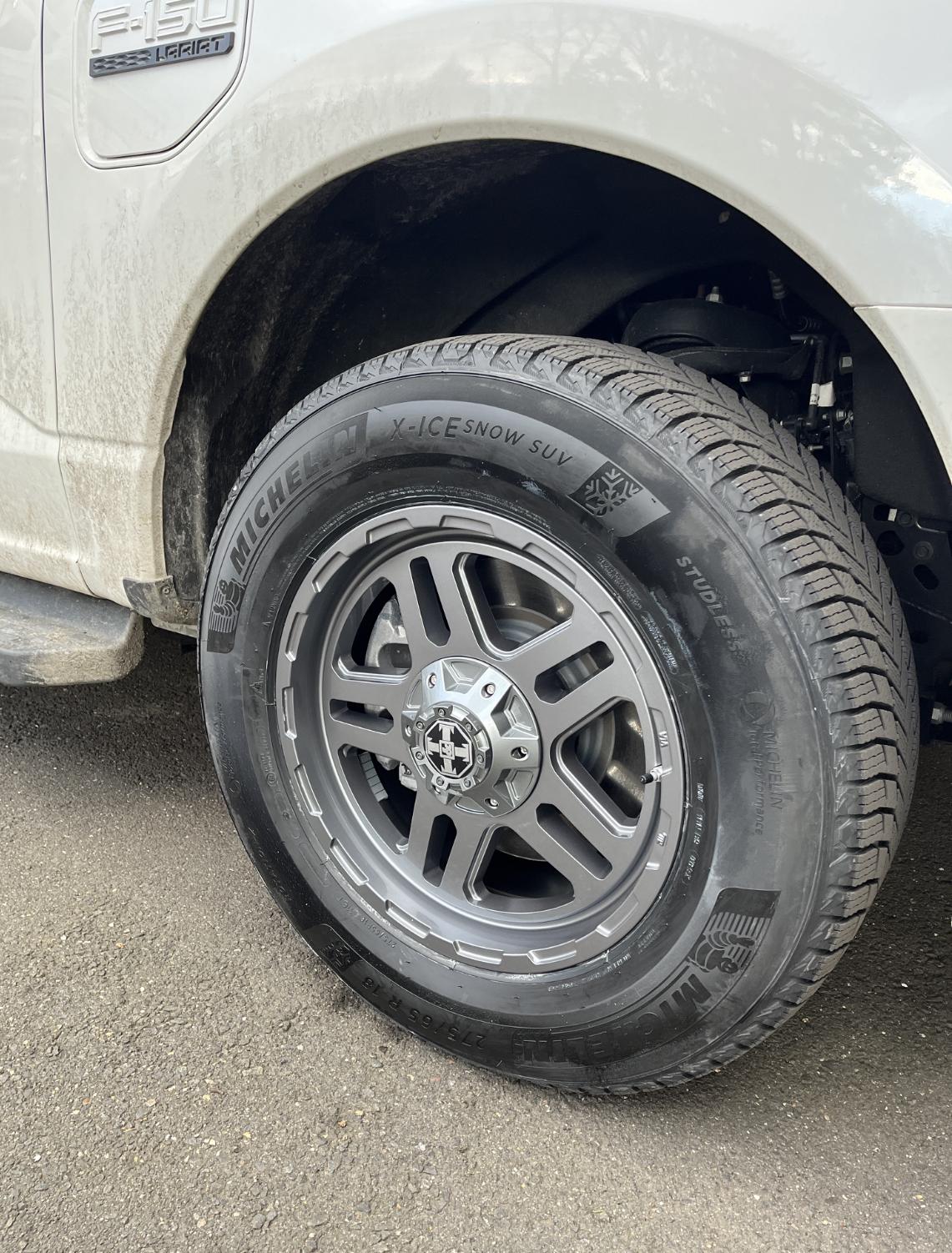

yeah I got turned down at Costco for winter tires that only had 115 load ratings.
They wouldn’t budge on it,
but then they found me a set that had 116 and it all worked out….

yep- those are the ones.
they were awesome too. Great grip - HUGE improvement over the Grabber all seasons , and not much range loss , maybe 5%.
I did the whole package through Costco- me not being an expert at rims or tires, but the tires paired up well with the 18” rims they put them on, though the offset did have them poking out of the wheel wells more than I expected :

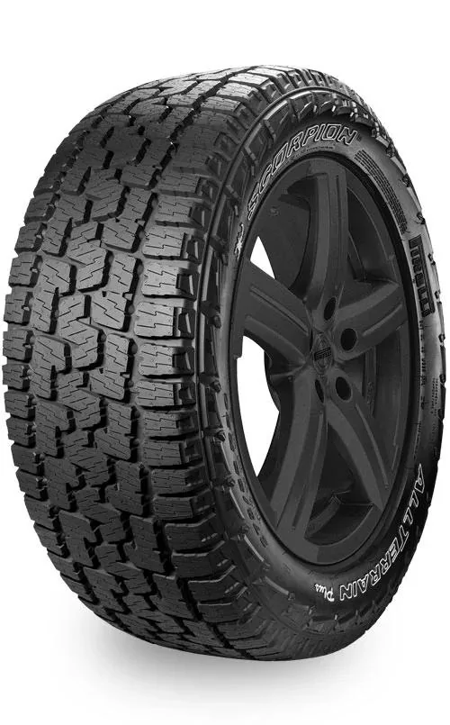

I have the non 'Rivian' version ordered in a LT275/75/18 to match the 20" stock height of my Lariat. I'm skeptical there is a big difference as they look the same exact tread. These are well reviewed, especially for wet performance and also for being quiet despite the aggressive pattern. I need some winter traction (mostly rains here in Vancouver) and snowflake rating for winter HWY laws but overall good wet performance is my goal. Decided to go 18" with new KMC Technic bronze
rims & sensors as well. Supposed to fit without any adjustments or spacers despite 18mm offset and 18x9 rim size.
Excited to get them on. Barring any issues, I'll post once they are mounted and give feedback.
Edit: QUESTION: Should I go with the white lettering or not?
I can only say what I would do. Go black. Touch a curb lightly makes raised-white lettering look bad. One little mistake and you are seeing it every day for the rest of your tire's life.
That's me, up to you.
However, on my now gone Corvette, the white lettering was the only choice. It was a great look.

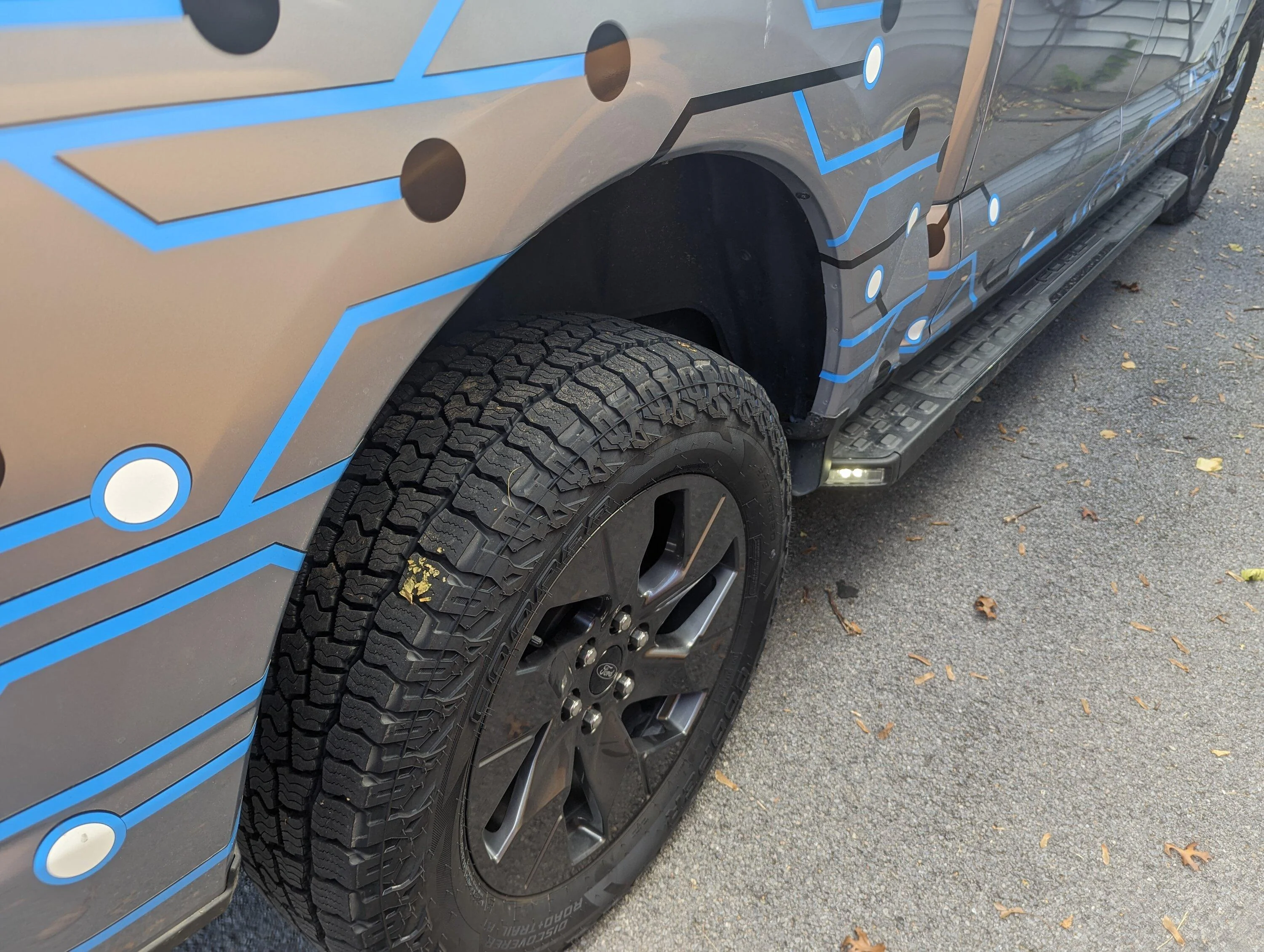

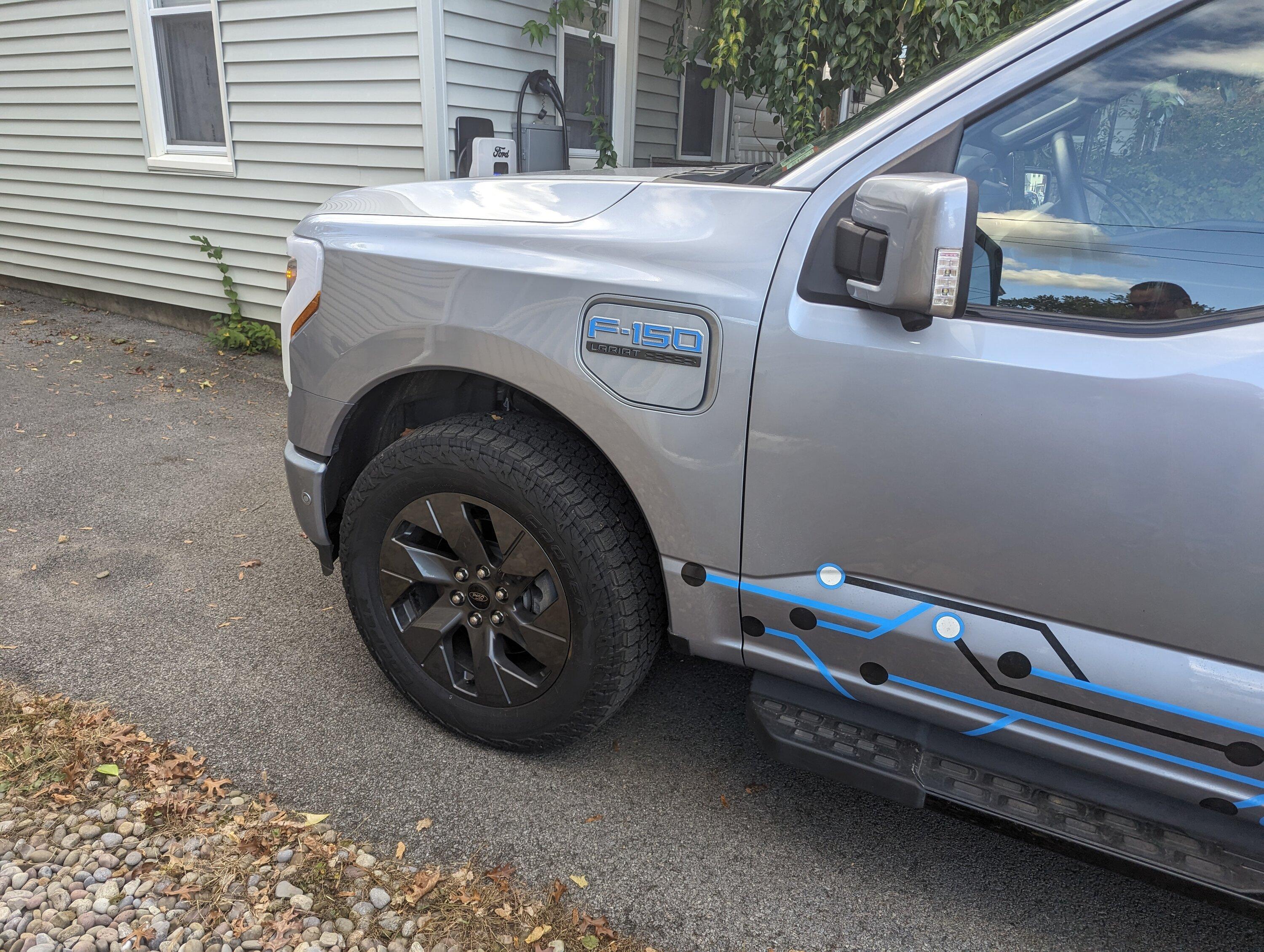

Had new tires put on today. Was going to get the Cooper Discoverer AT3 4S, but the shop got the new Discoverer Road and Trail tires which are the replacement for the AT3 4S. Only had them for a short while and zi didn't get a chance to do a true back to back comparison, so this is just a subjective review.
Noise: couldn't notice any difference from the general grabbers
Comfort: slightly smoother ride and less bumpy than the grabbers.
Traction: able to hold a full launch, but I can spin them when punching it in a corner. Overall a little less in the dry than the grabbers, but they are also brand new and I need to wear them in a bit.
Efficiency: hard to tell with only a little over 30 miles on them, but it seems to be somewhere between 5 percent and 10 percent range hit.
Overall happy with them, but I definitely need more time on them.

Quick update on my Cooper Discoverer Road and Trail ATs. Had them for ~400 miles at this point and just did my first long(ish) highway trip on them, ~175mi round trip taking my daughter back to college. I was...underwhelmed. Average efficiency on the drive was between 1.5mi/kWh and 1.6mi/kWh. ~75mph on average / ~45F temps / remote start but no preconditioning. That was a bigger range hit than I was expecting. I am hoping it was a fluke and had to do with headwinds or something, but with it being a round trip, I mostly doubt that. Will definitely need another longer trip to get more data.
Overall efficiency over ~400mi (including the trip above) is 1.8mi/kWh as compared to 2.0mi/kWh for my lifetime average, so much closer to the 10% hit I was expecting.
Still very happy with the tires performance besides that. traction, comfort, and noise have all been great. Haven't had a chance to test them in anything worse than a heavy rain yet though.
