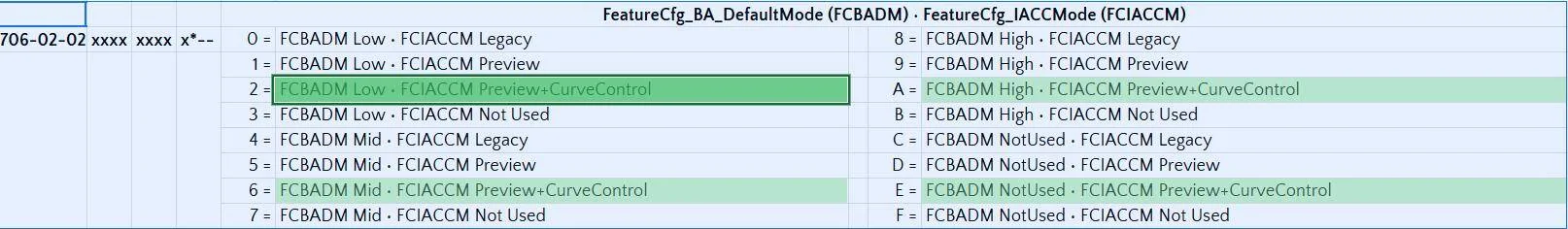

Neat that you can turn off curve control... didn't see it in the infotainment.
The fact that there are all these updates, and no real "documentation" from Ford on the features, how to use them, and best practices, is hilarious to me.
Yeah based on the little pop up for Predictive Speed Assist, one would think it was controlled by toggling that off but that just stops the truck from adjusting to speed limit signs. I updated the below from 2 to 1 in the IPMA and no more wonky curve control.

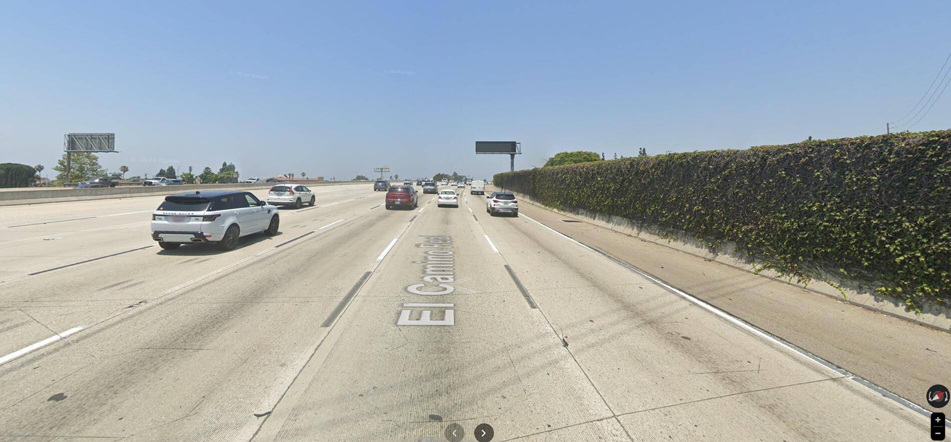

Interesting... I have the speed limit sign toggle off, but it still slows down on full speed gentle freeway curves.
Very sharp curve example:
