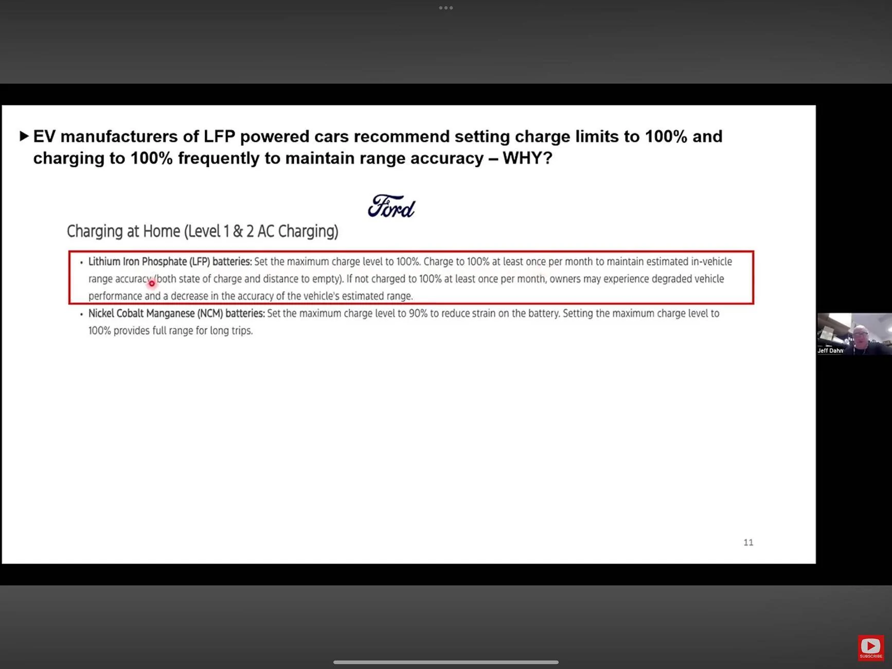

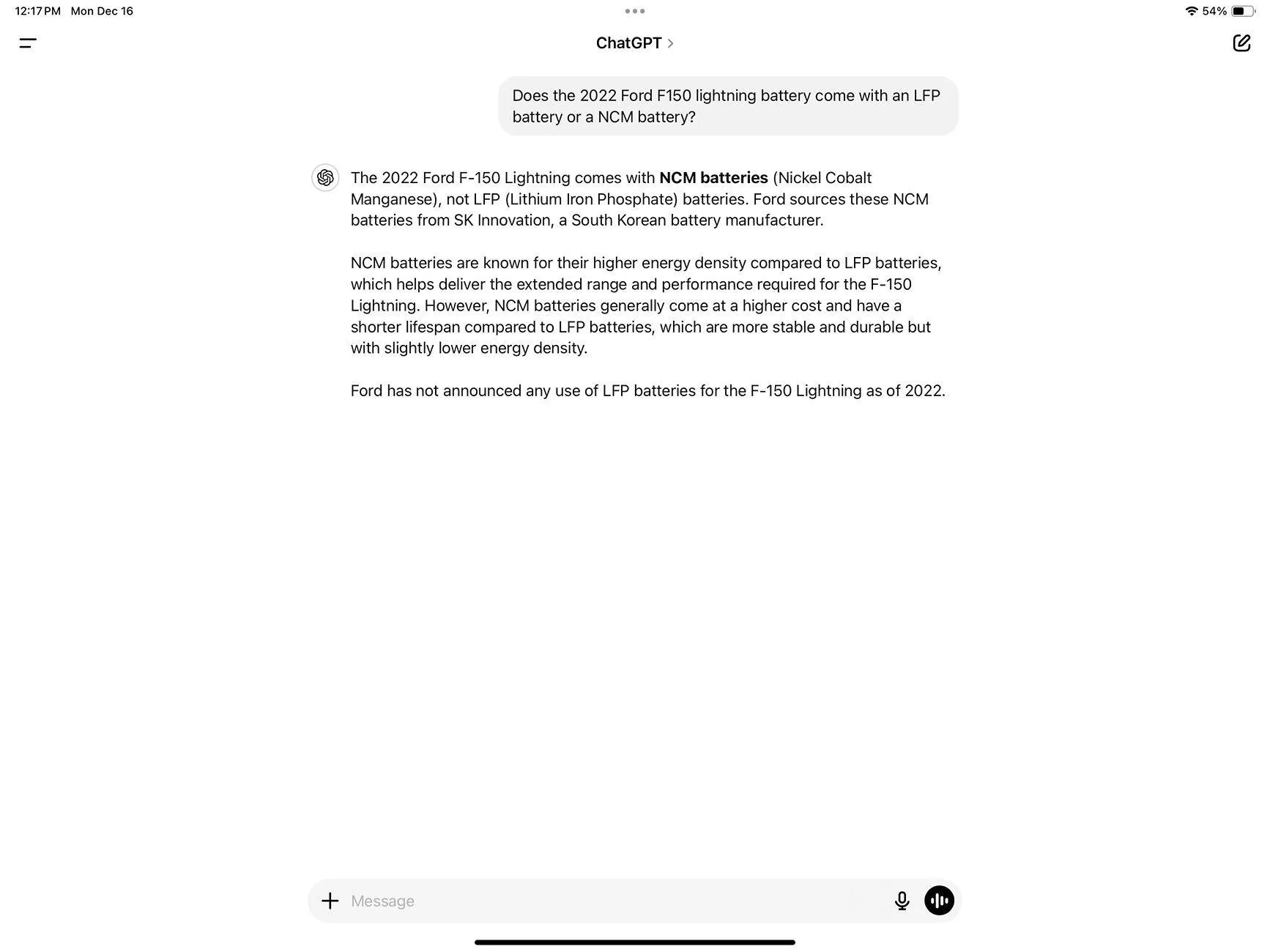

Hi - Thank you. So it turns out that there was another battery pack that has failed and needs to be replaced. This is the second one that has failed In a month. I have owned the truck for just about 6 months and purchased it with 8900 miles on it and now it is at 11,600. Should this be happening at such a low mileage? Is this a result of me never charging the battery to 100% during this time span? I did a road trip and charged it between 90-95 a couple of times and that‘s the highest I have charged it during the time I have owned it.
I also learned that the Lightning Battery is a NCM battery and not a LFP battery which Ford recommends keeping it at 90% for day to day whereas the LFP appears to be more in line with your suggestion of charging to 100%.
I was mainly keeping it at a 50%-70% range because my goal was to prolong the life of the battery and it was mainly off of the seminar I reviewed from Jeff Dahn which shows what happens to the battery over a smaller charging range and how it can produce an truly extended battery life -

Thank you Ryan!
Your link was very helpful with the Technician and it validated the issue and they were working to correct it and realized another cell has failed and I need to get that replaced.
