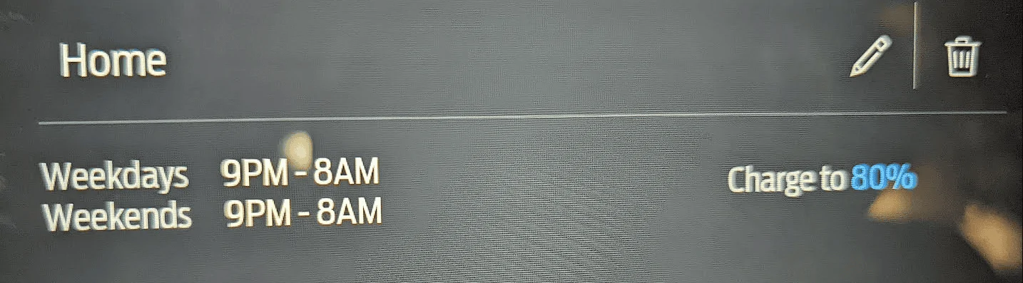

Another odd one last night opposite of the previous nights issue, it went from 62% to 99% when my home charging location is set to charge at a max to 80%. I did get the software update for the recalls yesterday evening so not sure if that somehow effected it but that seems like a bug.
4,204
5,576
Did you verify that your locations are still there? They are often wiped out by updates.
parabellum85
parabellum85
Austin
2022 F150 Lightning
yeah its still there, the slider to turn locations on and off seems to have disappeared though.

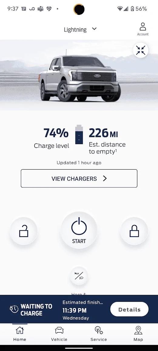

Well that was short. It did not charge last night again.
Ford F-150 Lightning Scheduled Charging Issues(preferred charge locations) 1660264551075
After 9PM still waiting to charge.

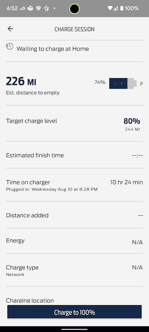

6:52 in the morning still waiting to charge.
Ford F-150 Lightning Scheduled Charging Issues(preferred charge locations) 1660264656014

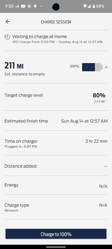

Did not charge again last night Saturday Night. Had to change time range to anytime to get it to charge.
Ford F-150 Lightning Scheduled Charging Issues(preferred charge locations) 1660500665932
