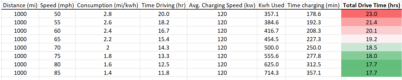

Depending on WHY you want to increase range, it might not "matter". Let me explain:
a) If you are worried about making it to the next available charger, or your destination, and risk "running out of battery" without making it, then by all means, conserve energy.
b) If, instead, you are just trying to reduce your total charging time at stops, then I have an alternative consideration for you. If you have plenty of charging opportunities along the way, you might consider a "who cares, drive how you want" attitude to some extent. I say this because the charging speed at a working, DC fast charger is much faster at providing energy than the speed of depleting your energy by going from, say, 65mph to 75mph. I used to try to hypermile on highway trips but reducing speed doesnt make as much of a difference as I thought when I realize if get energy back at 140kw, it doesnt make much difference in terms of "time spent at charger" so I *almost* drive at a normal-for-my-ICE-driving speeds. I try to keep it under 80 for the most part for what that is worth.
Here is a little chart I made to show what I mean in point (b) above. By varying driving speed (which ends up varying consumption), what impact do we have on total driving time? I am happy to share this little Excel sheet so you can play around with charging speeds and consumption rates.

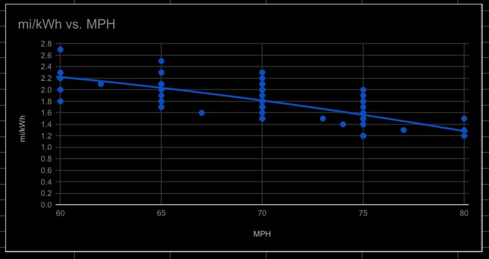

As said above, it’s a balance between drive time and charge time. There is no magic speed that will be optimal for everyone or every trip. Here’s my real-world data (Pro SR with platinum wheels). The variation at each speed is mostly explained by air temps and wind speed.

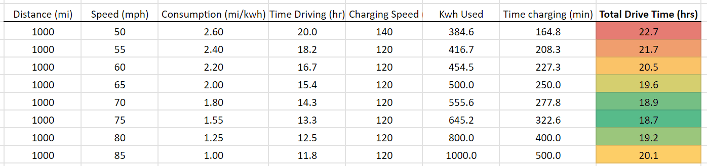

Thanks for this additional data! I updated my table to try things out with your data. Interestingly, it does change the picture from what I stated in my Point (b) further up and there does become a "Sweet spot" at 75mph assuming your consumption and also assuming 120kw charging speeds. Obviously, higher charging speeds raise the driving speed in the "sweet spot"

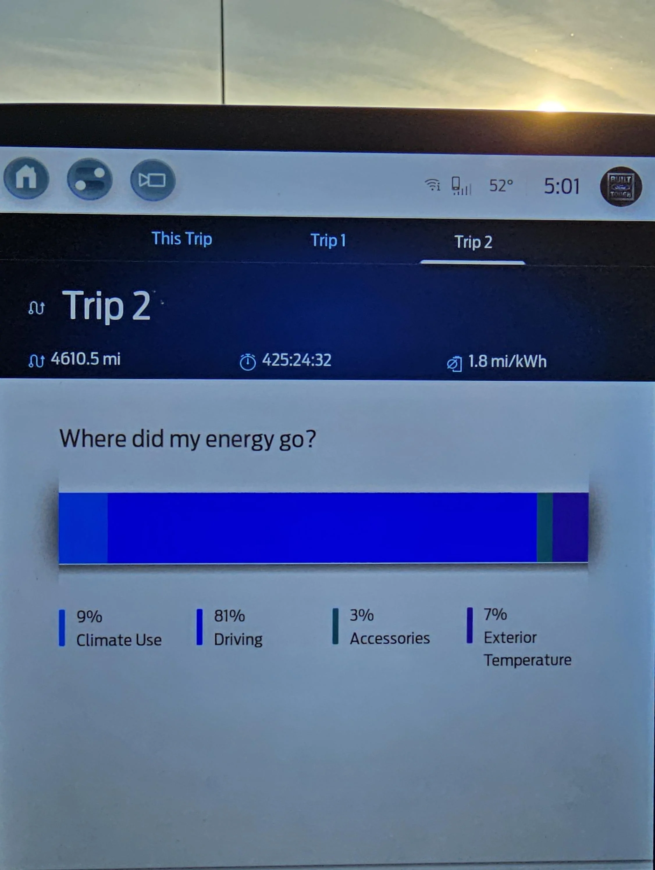

This is my running total since about Christmas.

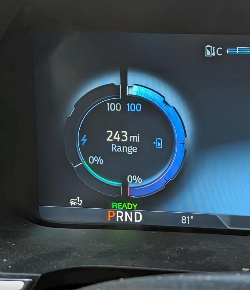

It’s warming up in SE texas and I noticed a big difference in range from when we had a cold snap a few weeks ago. I did a road trip from Houston to Austin with my standard range XLT. I started the trip at 100% and the range estimated at 243 miles. Normally it shows closer to 230-235 at full charge. Austin is uphill from Houston and door to door the trip is 165 miles with an elevation gain of about 800 feet. Certainly not mountainous but uphill. I drove mostly at 70mph and arrived with about 45 miles on the range gauge (trip plus remaining range was 210 miles vs the departure estimate of 245 miles. Since this was all highway driving I was pretty pleased.

Generally agree - unless driving a little more conservatively can save you an entire stop, it's not worth trying that hard if getting where you're going is priority 1. However, if knocking 5 or even 10 mph over 100 miles means you don't have to stop, then do that.
