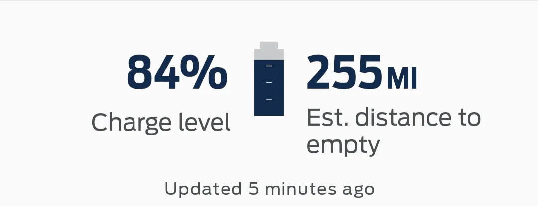

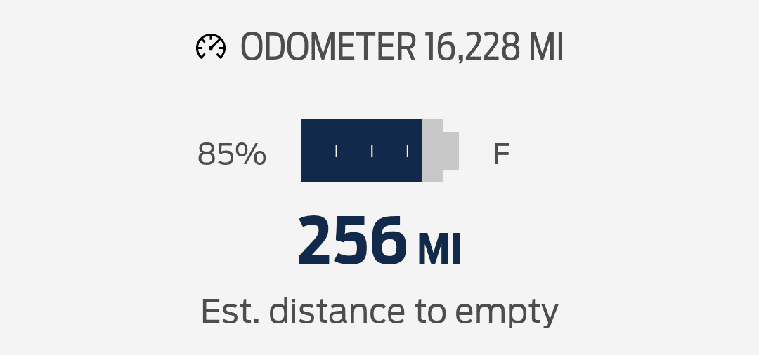

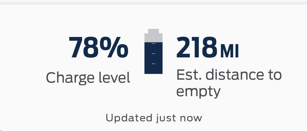

An example of the inconsistency of the GOM per SOC
Ford F-150 Lightning Best way to drive on the expressway for maximum battery life? 1708891109741
279 max range [218 / .78]
Ford F-150 Lightning Best way to drive on the expressway for maximum battery life? 1708891193777
273 max range [218 / .8]
Ford F-150 Lightning Best way to drive on the expressway for maximum battery life? 1708891232709
304 max range [255 / .84]
Ford F-150 Lightning Best way to drive on the expressway for maximum battery life? 1708891247437
301 max range [256 / .85]
