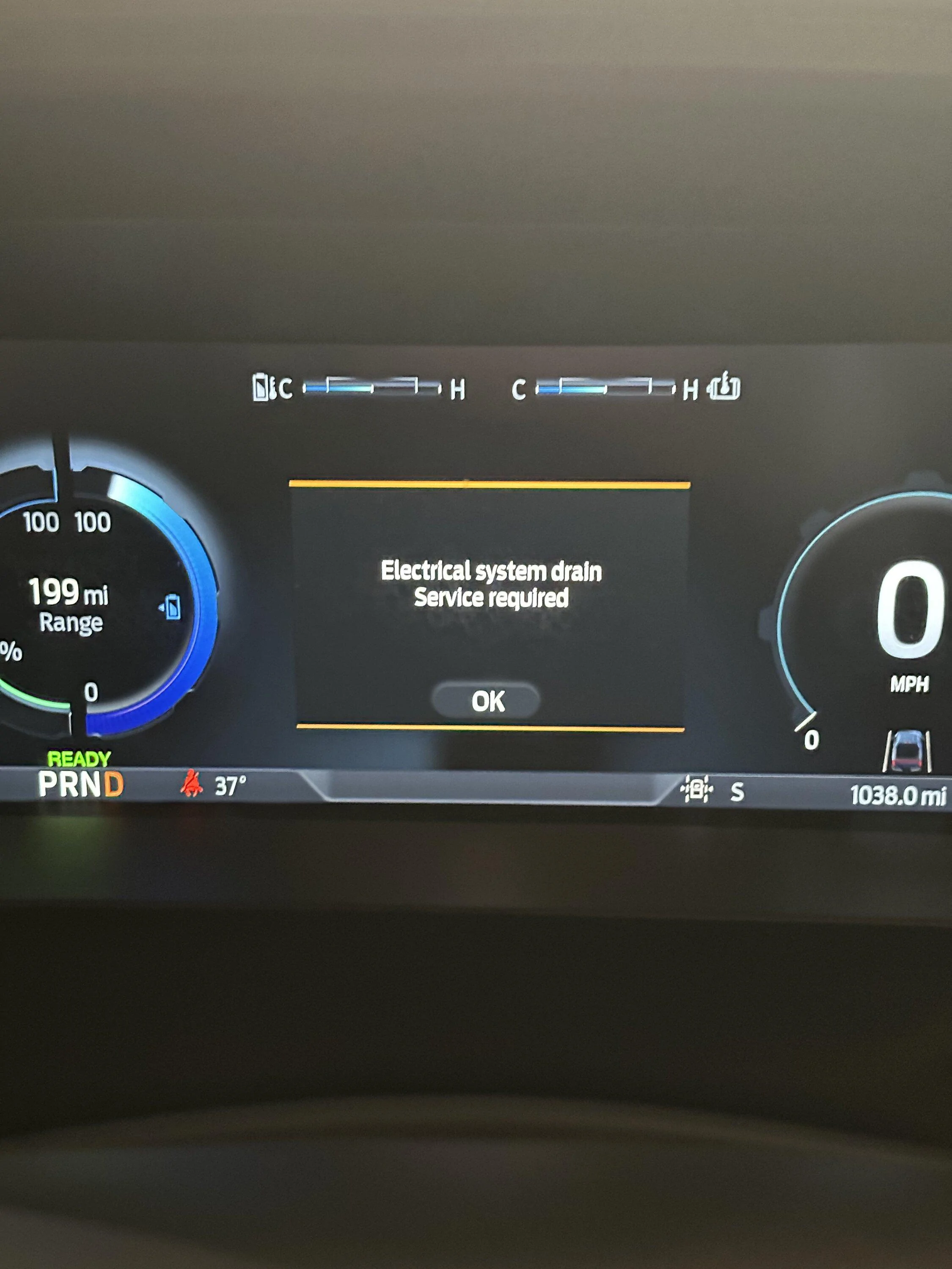

Anybody run into these issues? Or know how to resolve or troubleshoot? Truck is clean so dirty sensors are not the issue.

Dealer appointment set for next Tuesday. This is a new alarm that doesn’t make me feel great! Anyone seen this one yet!?!

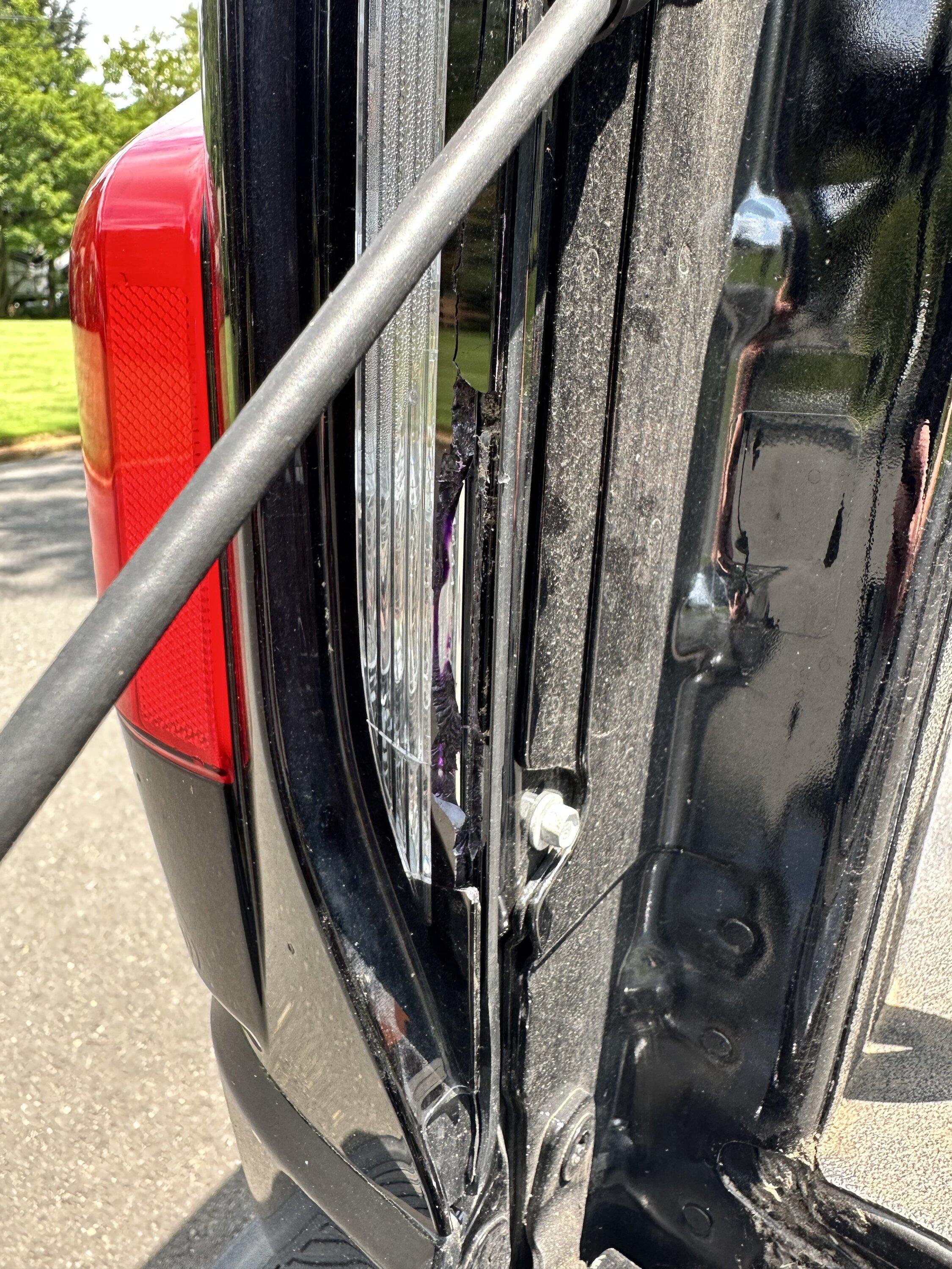

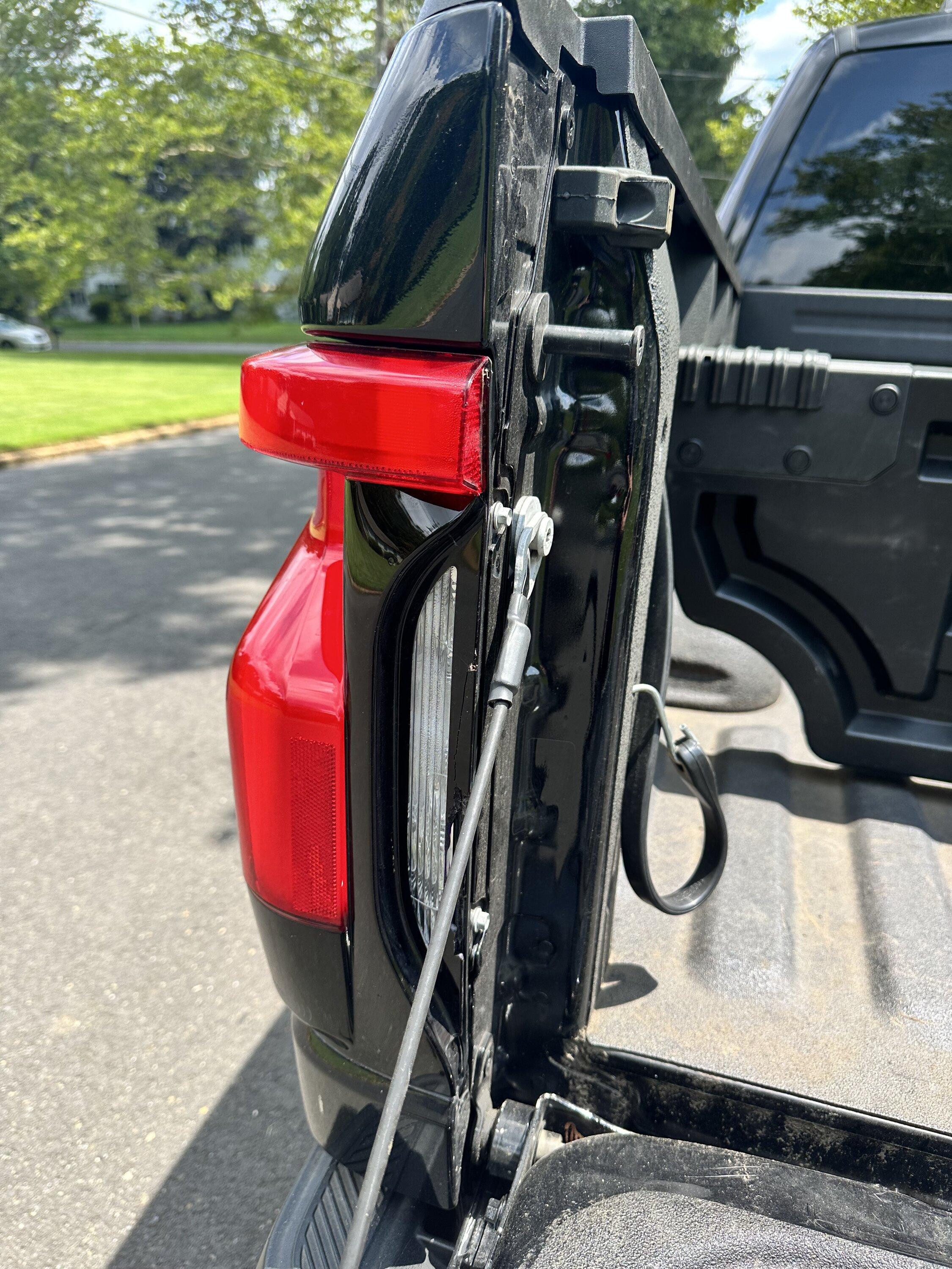

Based on this thread, i took a look at my rear tail light to see if there was any obvious problem - and i noticed a crack.
A few months ago, the metal end of a bungee strap got stuck in my tail gate, and when it closed it cracked the tail light. This in turn looks like it has caused moisture to accrue within the light, which probably broke the sensor. This is a pretty bad design because the tail light wraps the corner and can be cracked by the tailgate closing. Any rocks/debris in the tail gate could easily break this flimsy plastic. Do all F150s have this same light shape?
This part is $1300.
Does anyone know if anyone has had success in removing the moisture from an assembly like this? and if moisture was removed, could the sensor still work?

Recap: I have a crack in my taillight. Taillight works fine. Water got in there, and my BLIS sensor stopped working, throwing error codes.
Update: Dealer wants $3100 to replace the taillight assembly. They are unwilling to replace just the sensor. I tried to talk them into replacing and coding the sensor, and I would silicone the crack in the light. The service manager mentioned some BS about it being an EV and electrical issues so they need to do the entire light (which is 100% lies).
I plan to replace the sensor myself and figure out how to use forscan to code the new sensor and then silicone the crack in the taillight. i will create a new thread once i get this all figured out.
