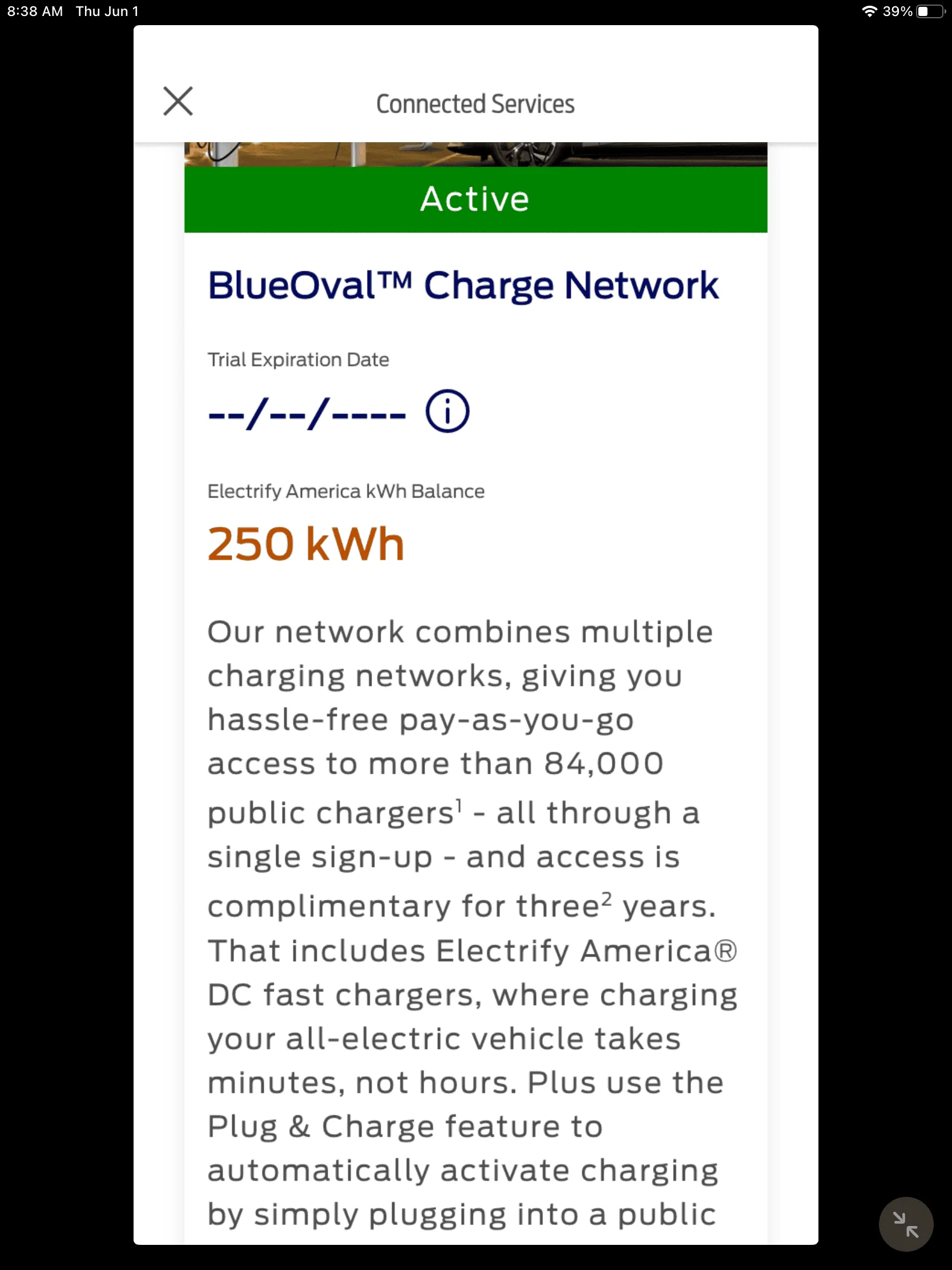

Just checked again... It says it's active and even shows the 250kWh with no expiration shown.
But, I've used 2 EA chargers and it didn't recognize me.

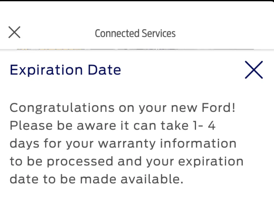

PS... I was curious about the blank expiration date, so I touched the (i) symbol and it said this:
Ford F-150 Lightning BlueOval Charge Network Trial Extended One Year Complimentary 1685623383123
To be clear, I took delivery last fall, so the 4 day window has passed. I wonder if the blank date has something to do with why it doesn't work for me.

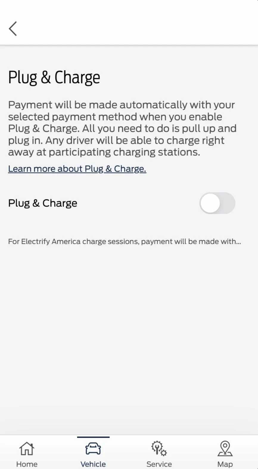

On my app there is also a plug and charge menu item that you have to open and check to enable plug and charge.
I have a Pro and the latest software update is 4.2.4

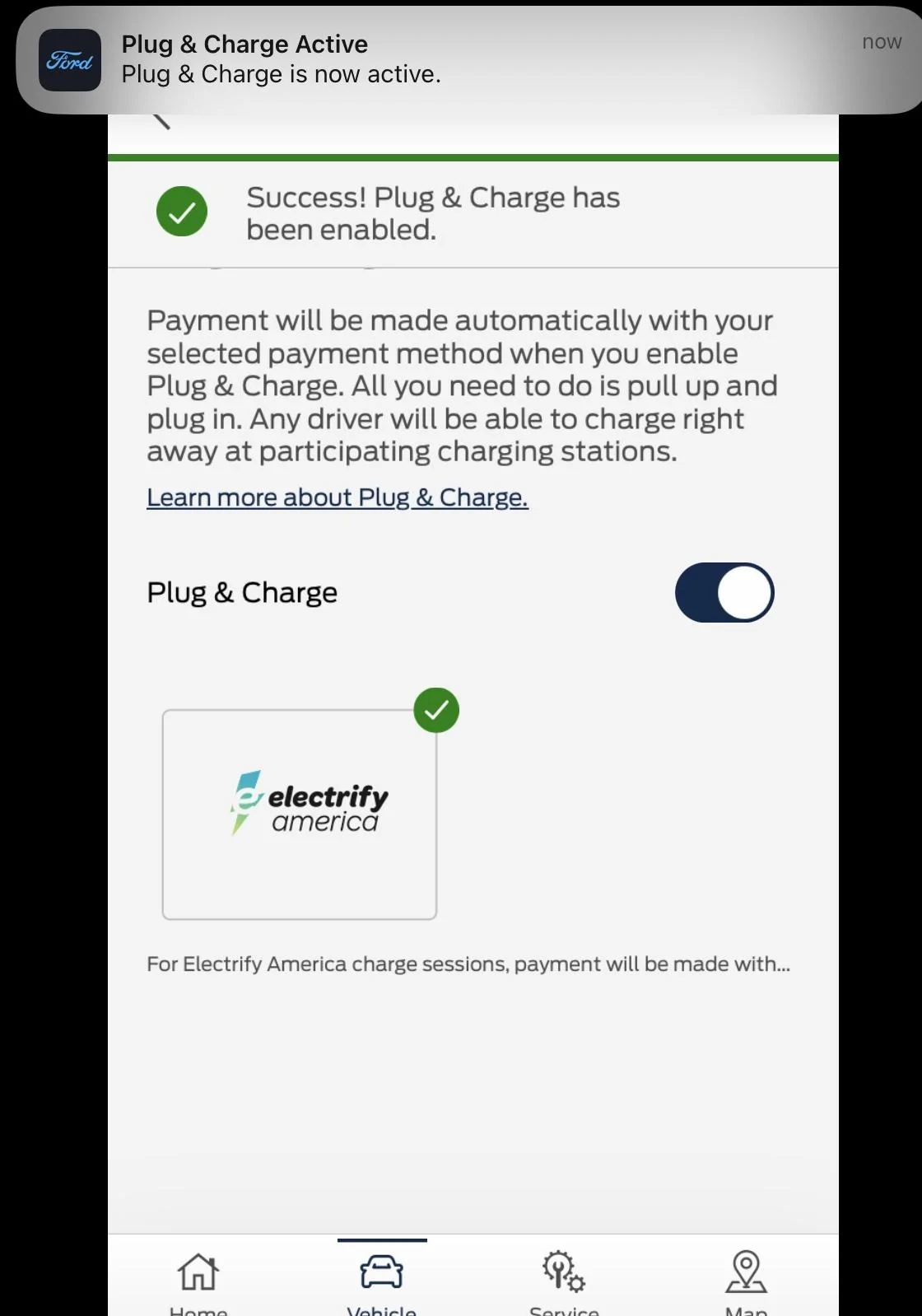

AHA! That’s it. It was turned off and I never knew it.
THANKS!
