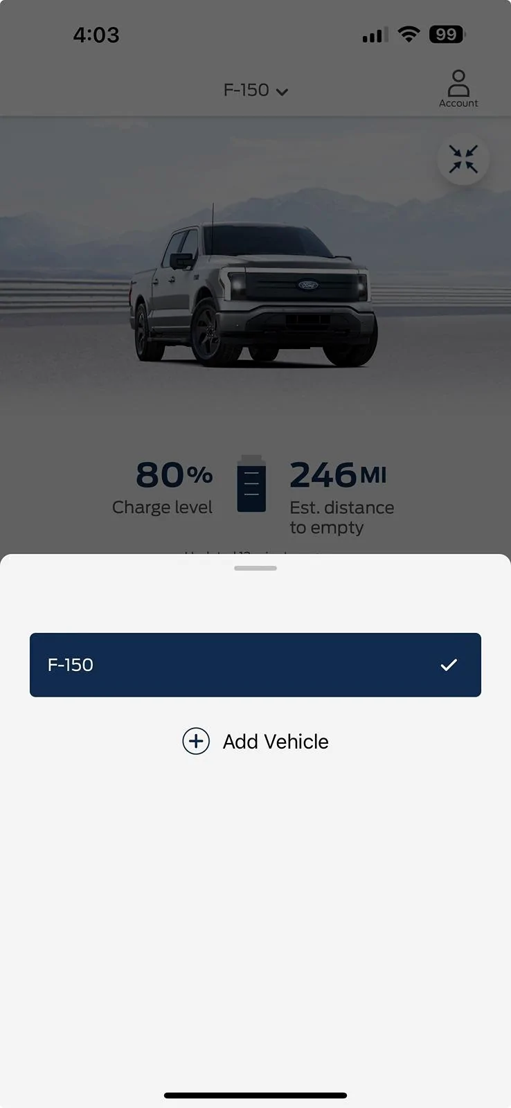

I wonder if you have multiple vehicle profiles, hopefully it's only listing one for your truck.
Click the drop list next to your vehicle custom name, do you have access to other Ford vehicles or maybe a ghost entry?
I only show my Truck.

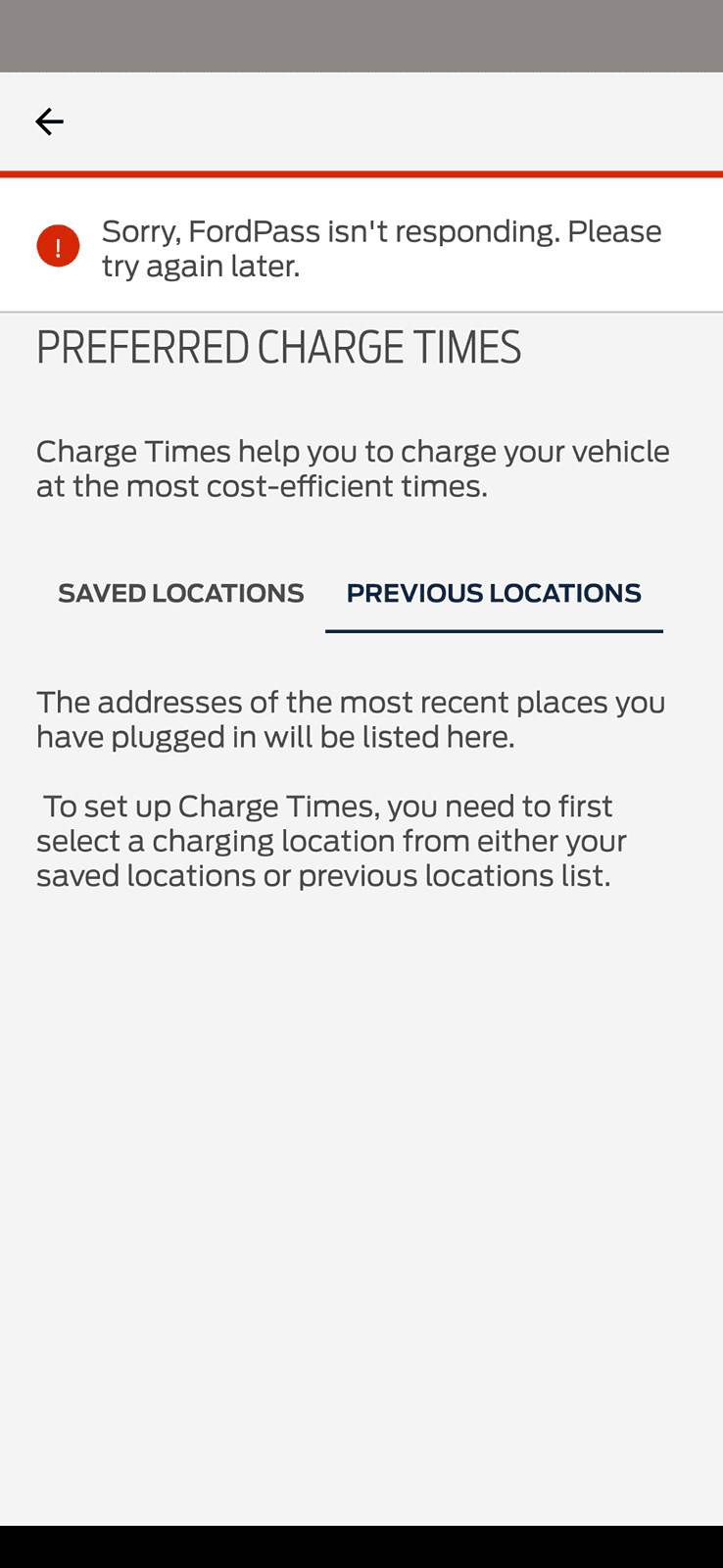

At least I'm not alone..... This my exact situation since about a week or so for now. It all started when I started to lose communication between the FordPass on my Android Pixel 7 pro and my 2023 F 150 Lightning Platinum; I couldn't get the battery state of charge and the estimated mileage for some reasons.
So, I started the classic truck master reset by disconnecting the 12 volt battery for few minutes; but no change. Went to FordPass app, cleared the cache, the data later on, again no change. Uninstalled the app from the phone, shutdown the phone before reinstalling FordPass. After setting everything up again in FordPass (kind of painful...); same thing still no communication with the truck other than the Bluetooth stuff (PAAK, remote start.... All working).
Finally attempted factory reset on the big screen and the pain to reset the entire driver profile with all the features. Now I can receive the battery s.o.c and the estimated mileage but no more possibility of scheduling the home charging location. System keeps telling me that I have to charge first at that location before assigning a schedule time. The charging logs are posted the following day with my home address but the address location doesn't get saved. Then I thought maybe I need to charge the truck at an EA station which I did; address of EA station gets reported in the log but not saved in the FordPass app. Talking to Ford support, I was told that the only to charge the truck for now is to use the one time charge limit on the big screen in the truck, in my case I want to limit the total charge to 85% from 11:00 PM to 5:00 AM to take advantage of the off peak hour rate of $0.08 / KWH. I have to do that manually from now on since I'm not able to use the charge scheduling in the FordPass app or in the truck; the automatic scheduling way was what I used since I bought my truck six months ago and it was working flawlessly...

While tinkering with my FP, I'm seeing this frequently while viewing the [Vehicle] tab or after requesting a data update: Maybe more server issues at Ford today??
I opened my app to check and have the same thing. Must be an issue on their end.

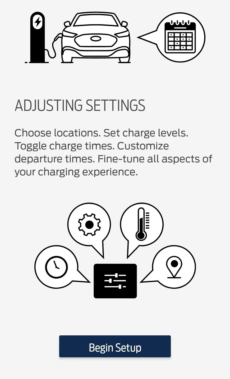

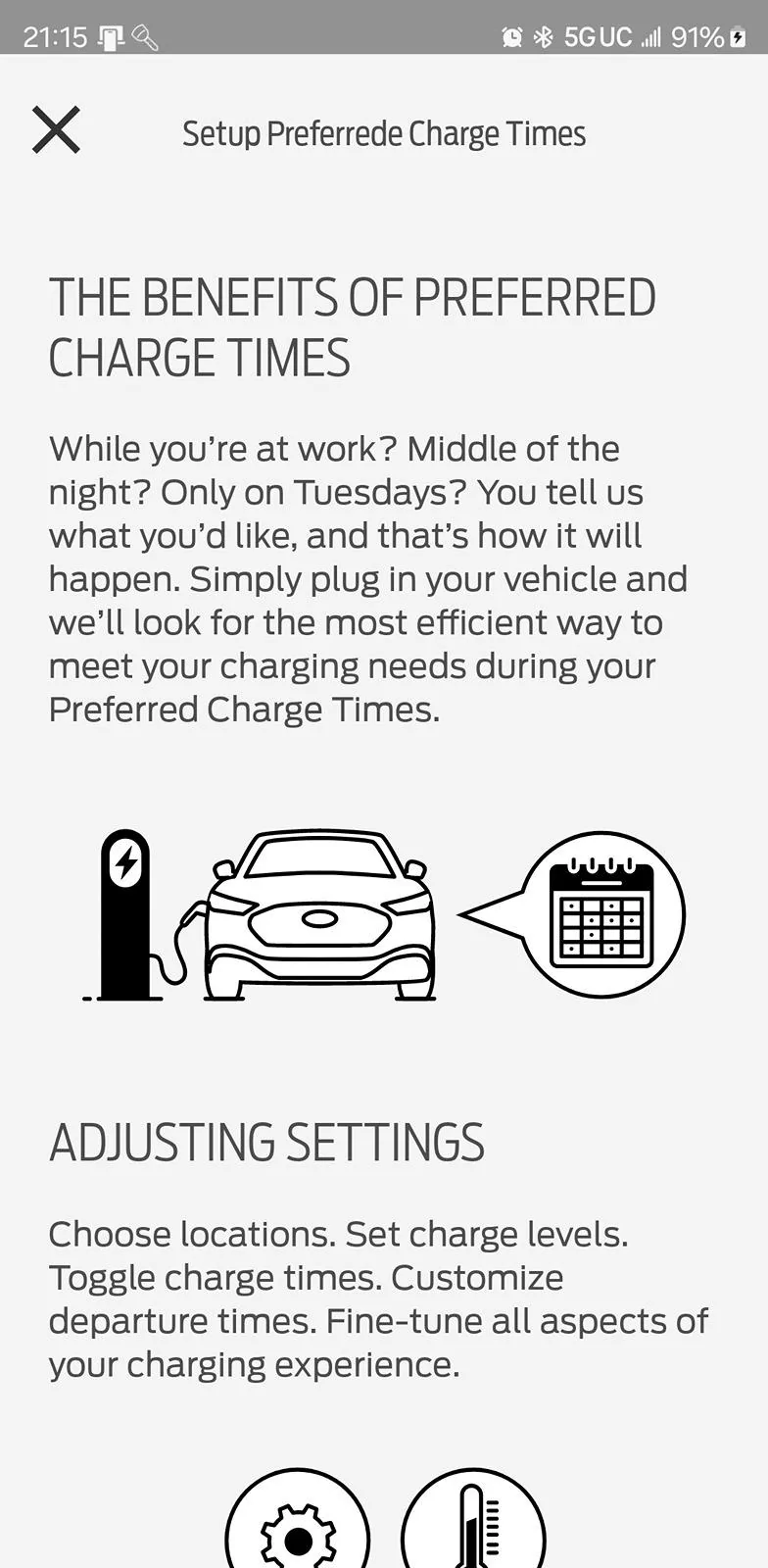

Weirdly, this information screen is always popping up as if I were a first-time user of preferred charge times!!
Ford F-150 Lightning Can’t set charging location at home -[fix post 42] 1715995094376-3j
When I click Begin Setup, it brings me to my previously built profile which I can edit.
Ford F-150 Lightning Can’t set charging location at home -[fix post 42] 1715995149393-qq
