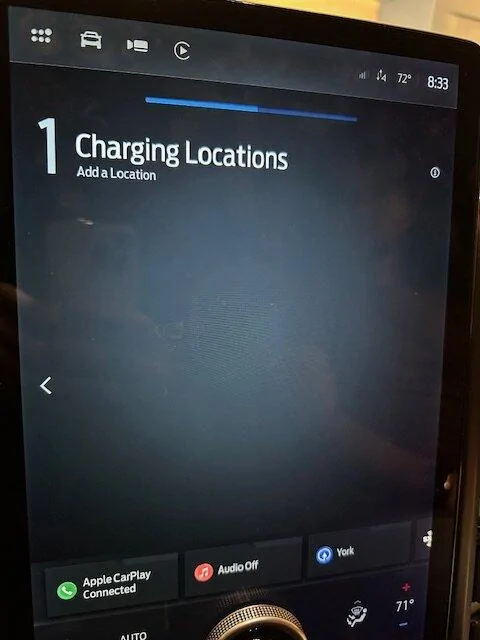

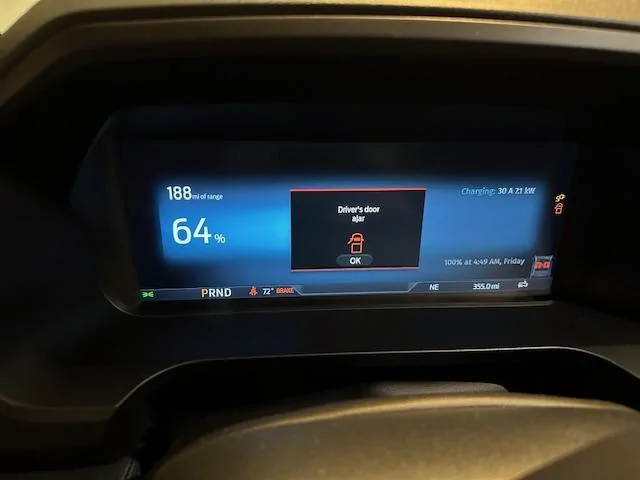

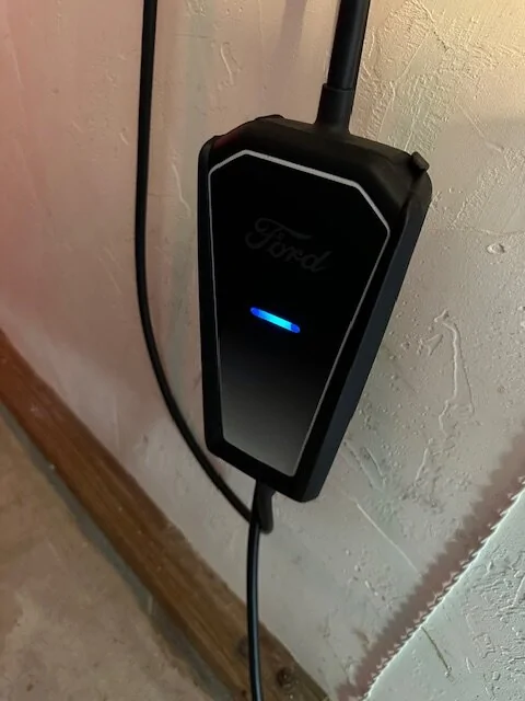

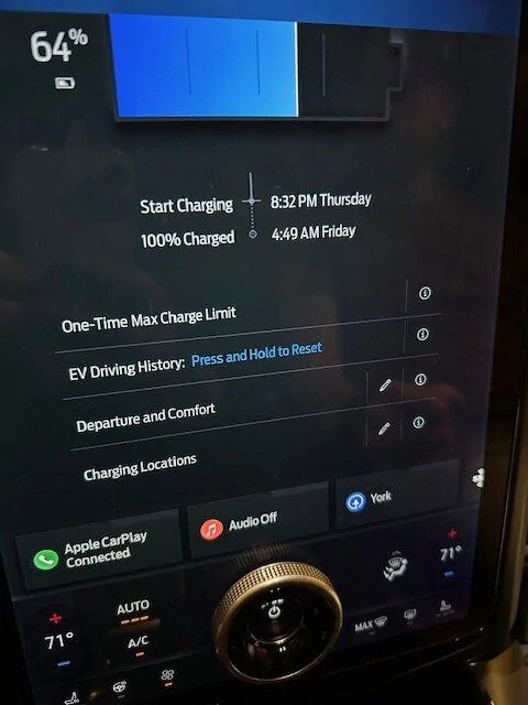

Thank you for the response. I will keep trying and try your approach. So far no matter what combination of events I do the add location Button is never present as shown in my photos.
May 3, 2024
PA
2024 Ford F150 Lightning Flash
Alright So I tried again. The Truck is at 64%, I plug in and it starts charging immediately. I check the Charging menu, and the option to add a location is still not there.

To me the key is that you cannot also use the built-in navigation while charging. That seems to be the root of your problem. If it is not able to get GPS coordinates while charging, then there is nothing for it to add i.e., no coordinates to store for the location.
Have you tried a Sync Reboot? May also try to disconnect negative cable for a few minutes then re-connect (10mm wrench).
May 3, 2024
PA
Are you saying I should force close the Navigation app that is running in the background? I'll try it, but that also seems strange as I am not actively using it for navigation routing.
Edit: I did a SYNC reboot and force close the Nav App. No change.
2,644
3,741
No not saying that. I am referring to your post #10 and #13.
I am not sure if it related but I am also not able to use the Navigation features at all even though it is enabled and the service plan is active.

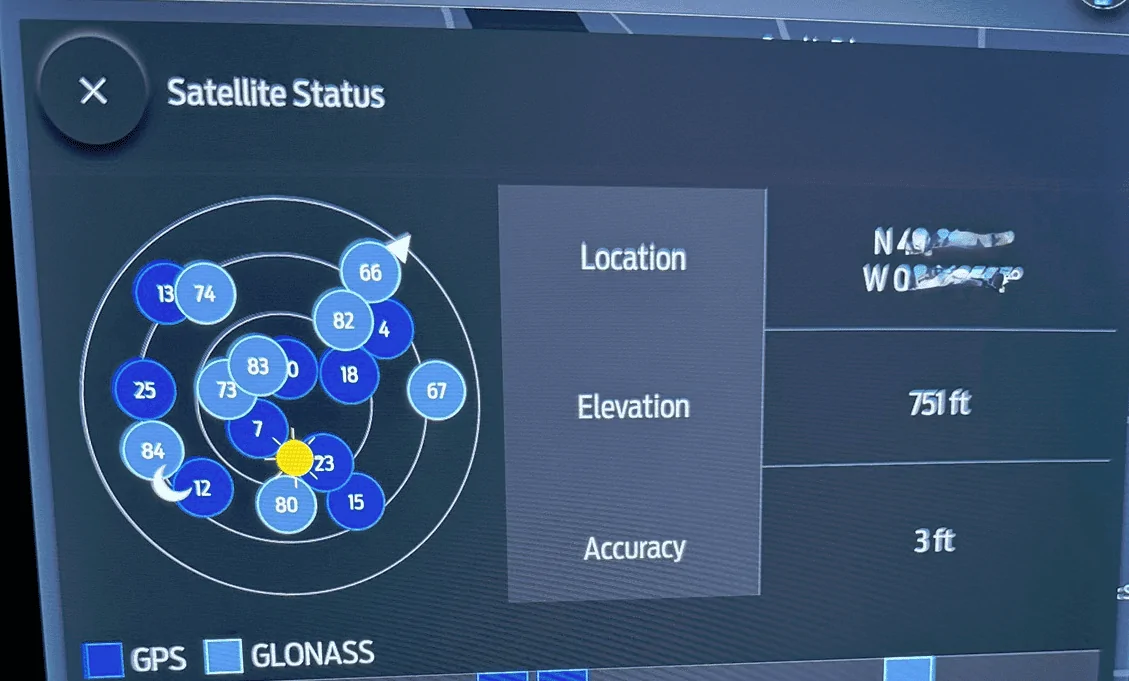

It's funny I just found this. Nav and Satellite Status will work if I unplug the charger. Getting great Satellite signal in my garage.
I can't see how you can save a charging location (GPS coordinates) if you don't have GPS working. So my suggestion is to reboot the entire truck. Did you click the link in my post on how to Reboot Sync? (holding down certain steering wheel buttons)? And if that doesn't work, pull the literal plug by disconnecting the 12V battery for 10 minutes.

Apologies, I now have GPS working. I should have posted that in enabled the 3 Connected Services options it requires. The truck knows its coordinates, and my Fordpass App also knows its coordinates.
2,644
3,741
Hmm, then I'm not sure what's going on. Just to confirm, while you are plugged in and charging, you see satellites and there are coordinates listed like this screenshot?

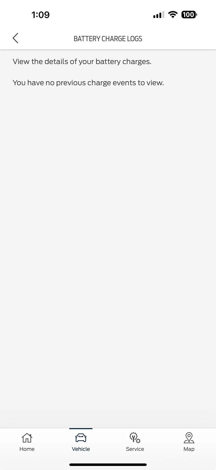

I would also like to add another datapoint to this issue. In my app there are never any charge logs. It is signed in, and linked to the Truck. I can see its gps location and everything. I've been charging at home for about 3 weeks now. See photo:
Ford F-150 Lightning Can’t set charging location at home -[fix post 42] chargelog
206
15,144
16,785
It is signed in and linked to the Truck.
See photo:

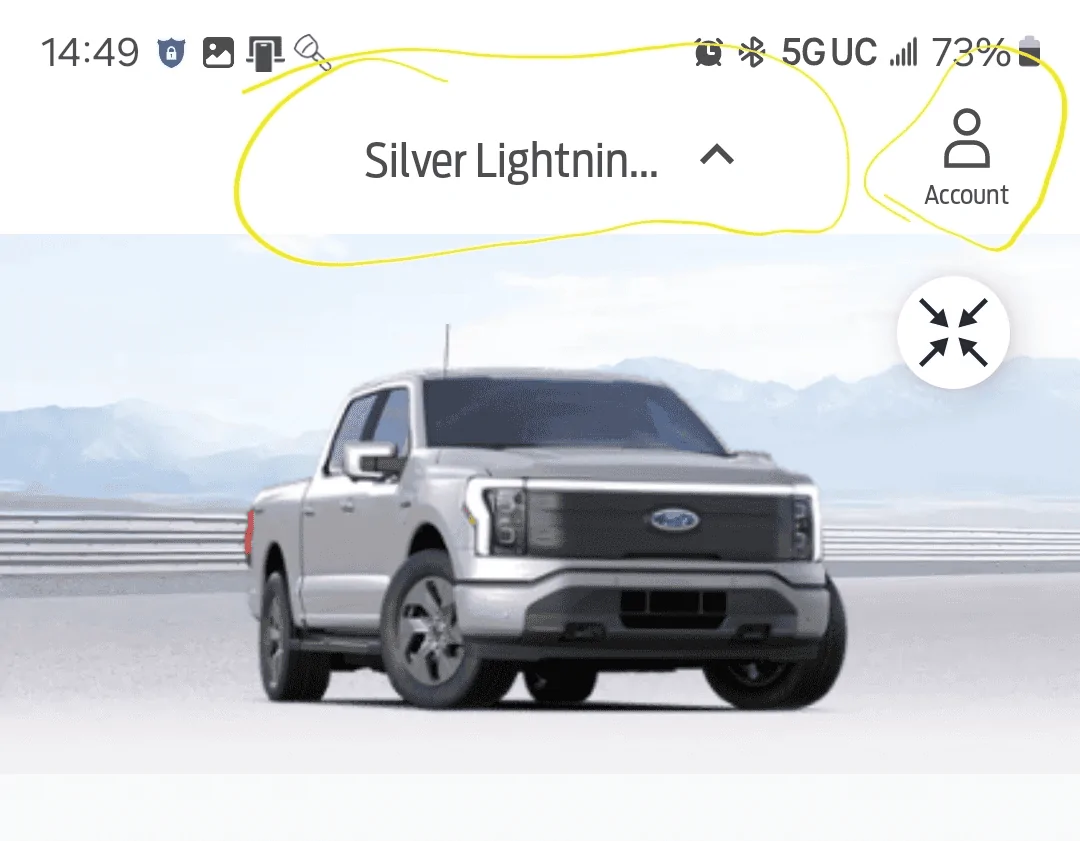

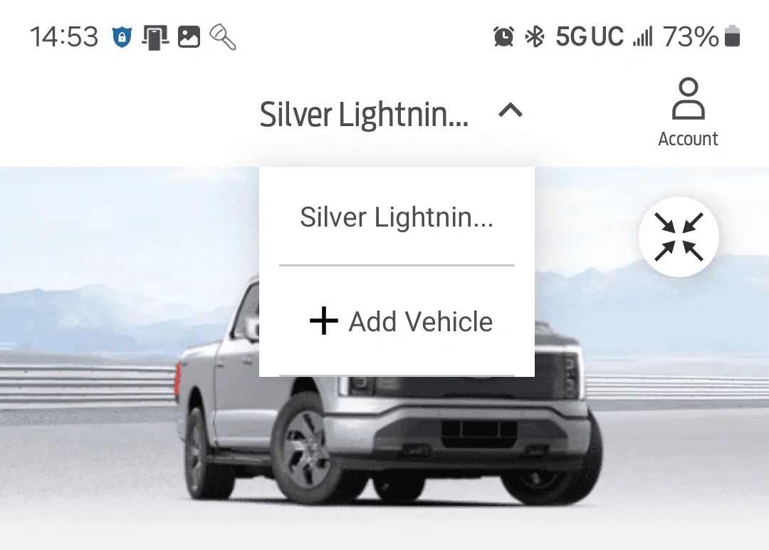

This is a secondary issue, you should be able to see charging records, they typically post about ~12 hours after unplugging from the EVSE.
I wonder if you have multiple vehicle profiles, hopefully it's only listing one for your truck.
Click the drop list next to your vehicle custom name, do you have access to other Ford vehicles or maybe a ghost entry?
