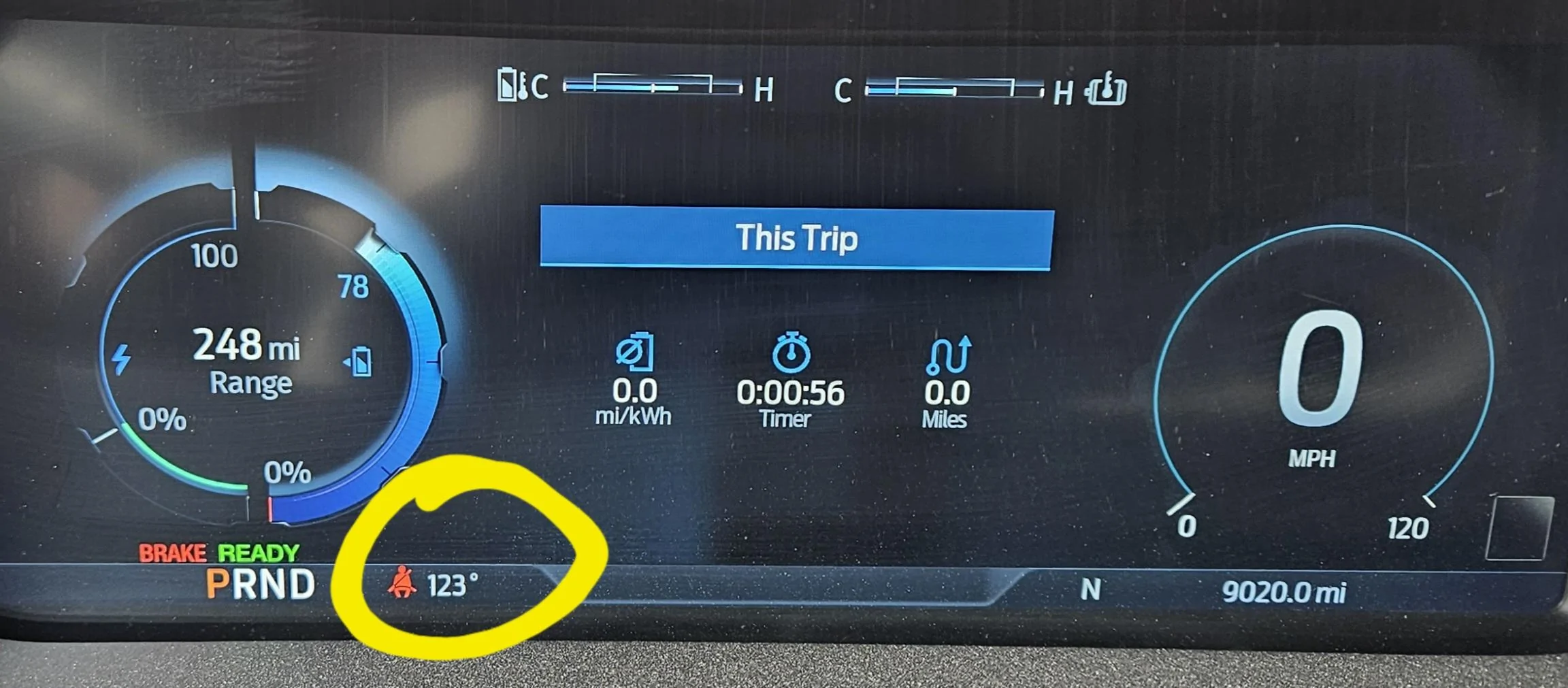

Hottest day so far, feel bad for you guys up in Phoenix. Battery gauge is about as far right as I've ever seen it.
Here's what I saw when I got into my truck to go home.
Ford F-150 Lightning Can The Lightning Cool Its Own Battery in Hot Weather When Not Plugged In? 20230725_153825
Only dropped to 117 after getting on the freeway. Home weather station indicated 114.
