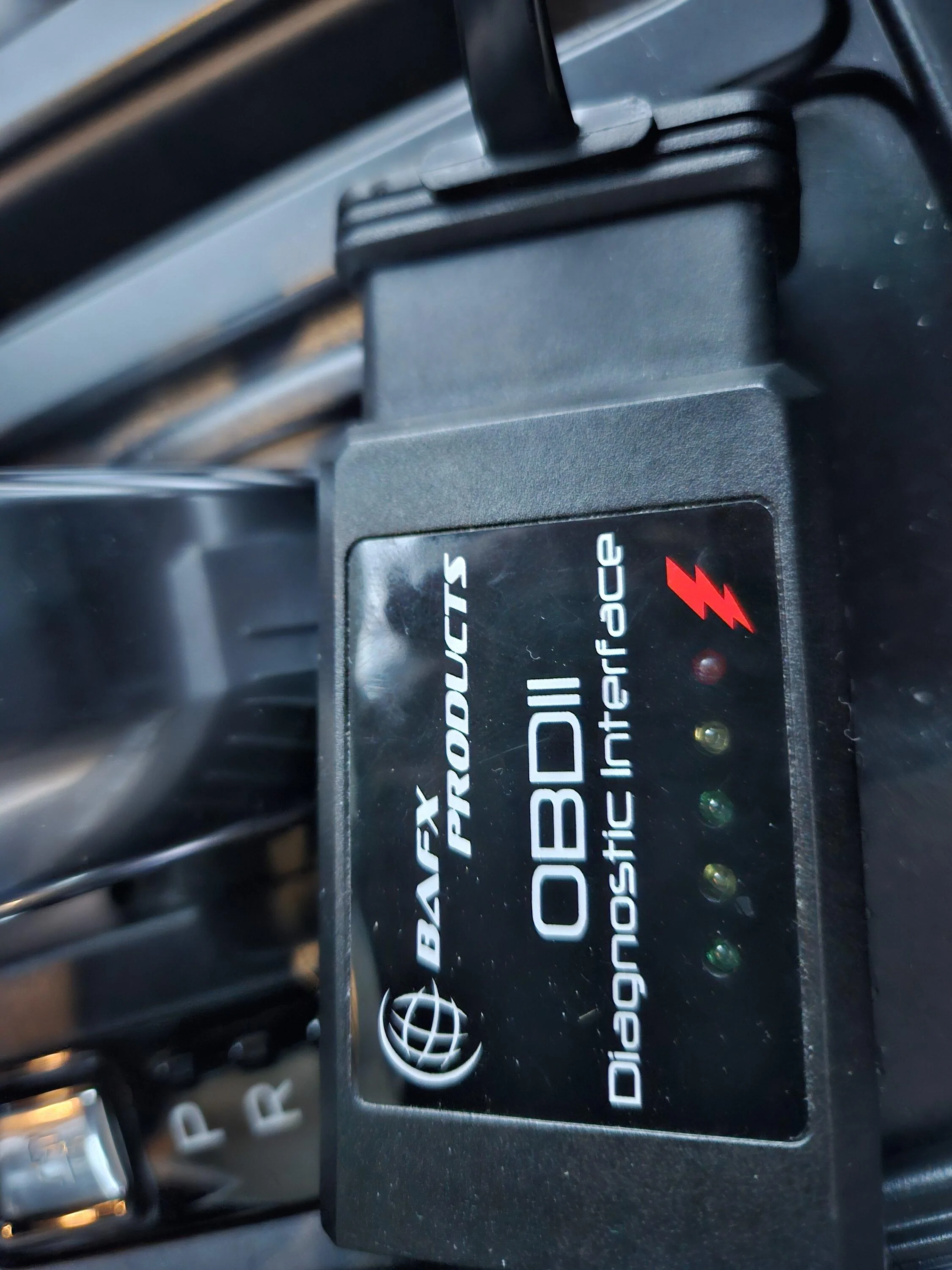

Are regular OBD2 adapters compatible with the Lightning? I have an old Bluetooth OBD2 adapter that won't turn on when plugged into my Lightning. I'm wondering how much time and effort I should put toward troubleshooting.
Theoretically any adapter should work, but there's quite a few knockoffs out there with sub-par chipsets, software emulators and whatnot, so I personally wouldn't waste much time troubleshooting as it's an "either works or it doesn't" kind of thing.
As for adapters I can highly recommend OBDLink (I've got nothing to do with them, I've just had good results).
MX+ Is the best (IMHO) wireless solution for phone/Car Scanner, Torque use
EX (USB hard wired) is better if you want to tinker with ForScan
CX+ is nice in that it does work with ABRP, BUT it's Bluetooth LE (Low Energy) so while it's easier for apps to control (because you don't need to pair with it) it's also slower than regular Bluetooth, so if you're logging a lot of stuff you might run into bottleneck issues, but for general use you're probably fine.

Just so nobody spends time trying to find it, there is no CX+. The BlueTooth LE version is just the CX.
I got this at $27. Now showing at $32. With free car scanner app, it’s was plug and play. The app already knew Lightning. Only you can be judge of if $32 is worth your time. I didn’t even try my old OBDII since it had no interface with my phone.

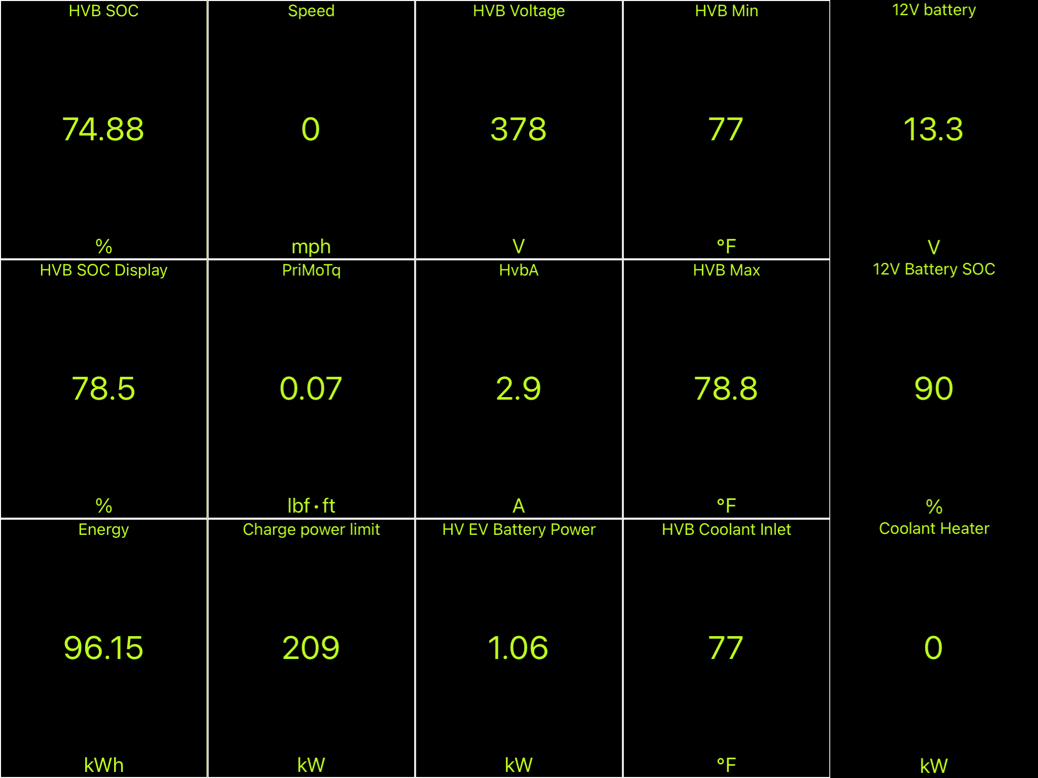

To bring this thread back to life, I connected my truck to this app to my Lariat ER and got the following readings using the default dashboards:
Being new to looking at this “raw” vehicle data, there are a few things I don’t know how to interpret:
  1. The “Energy” reading…..I assume the current energy in the battery?
  2. The “HVB SoC” vs the “HVB SoC Displayed”. Why the difference and how do they relate to the “Energy” reading
In addition to the above, to me, the math doesn’t add up given the stated 131 KWh rating of the ER battery.
I’m trying to reduce my level of ignorance….thx in advance……

LVB State of ChargeLvbSoc0x224028A
0​
100​
Here is the PID information for the low voltage state of charge
You may have to manually input it into your program.
0​
100​
Thanks!
I finally found it. I had a scanner firmware update and app update yesterday, and I found the LV SOC after those updates. Since I was not familiar with either the scanner or the app, I could have just missed finding it on the first attempt. I appreciate the assistance.
