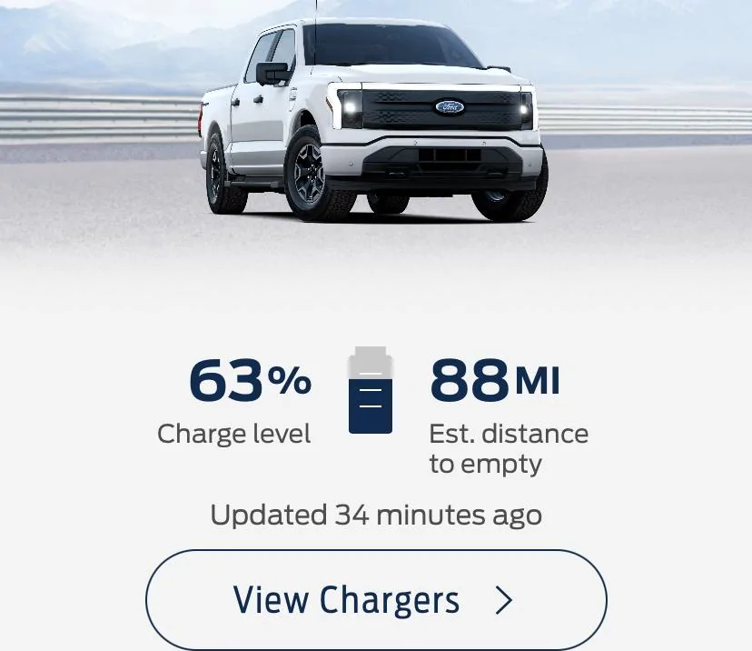

My Lightning is supposedly capable of being charged to a range of 220 miles. This works as intended. The other day, as a test, I charged to 100% and the range estimate was 218 miles…pretty close to the spec. However, as I drive the percent does not match the range estimate…not even close. For example, you’d expect to have 50% charge remaining when the range estimate is about 110 miles, or so. However, my current range estimate (parked) is 88 miles and the charge level percent says 63%. It should be well under 50%. Is this normal? Is it a bug with the software that matches range to charge level?

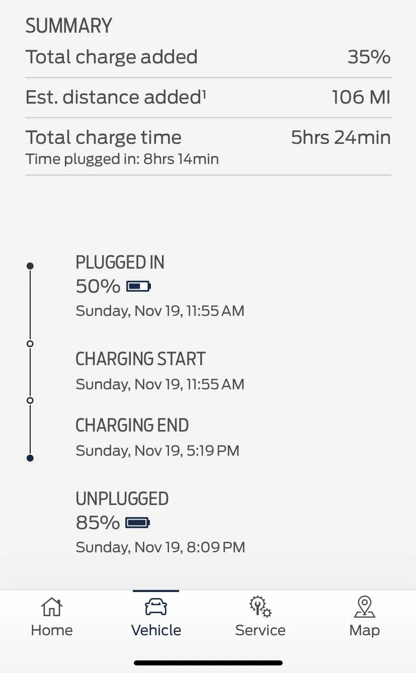

Related to this is the charge log in the Ford app. It can show charge level increases that are far above the range miles added. I’ve attached an image that shows 35% added when the range added was 106 miles!
Ford F-150 Lightning Charge Percent Indicated is Wrong IMG_9690
Seems like the percent is almost random. This is not simply on the app…the charge level indicated in the truck is the same as the app…i.e., wrong. Any thoughts would be appreciated. If no one else is seeing this, perhaps my truck needs service?? Thx in advance…

Many factors affect range, especially cold weather. Forget the GOM and just pay attention to the MPK and SoC.

The "range" number is referred to as the GOM (Guess-O-Meter) for a reason, it is rarely accurate and is the truck's trip computer guess at best. A variety of factors affect this number, including but not limited to: external temperature, battery temperature, driving style, driving speed, highway vs city driving, wind/weather.
We get posts seemingly weekly about people not realizing this distinction.
Focus on your actual battery percentage and your efficiency value (Mi/kWh)

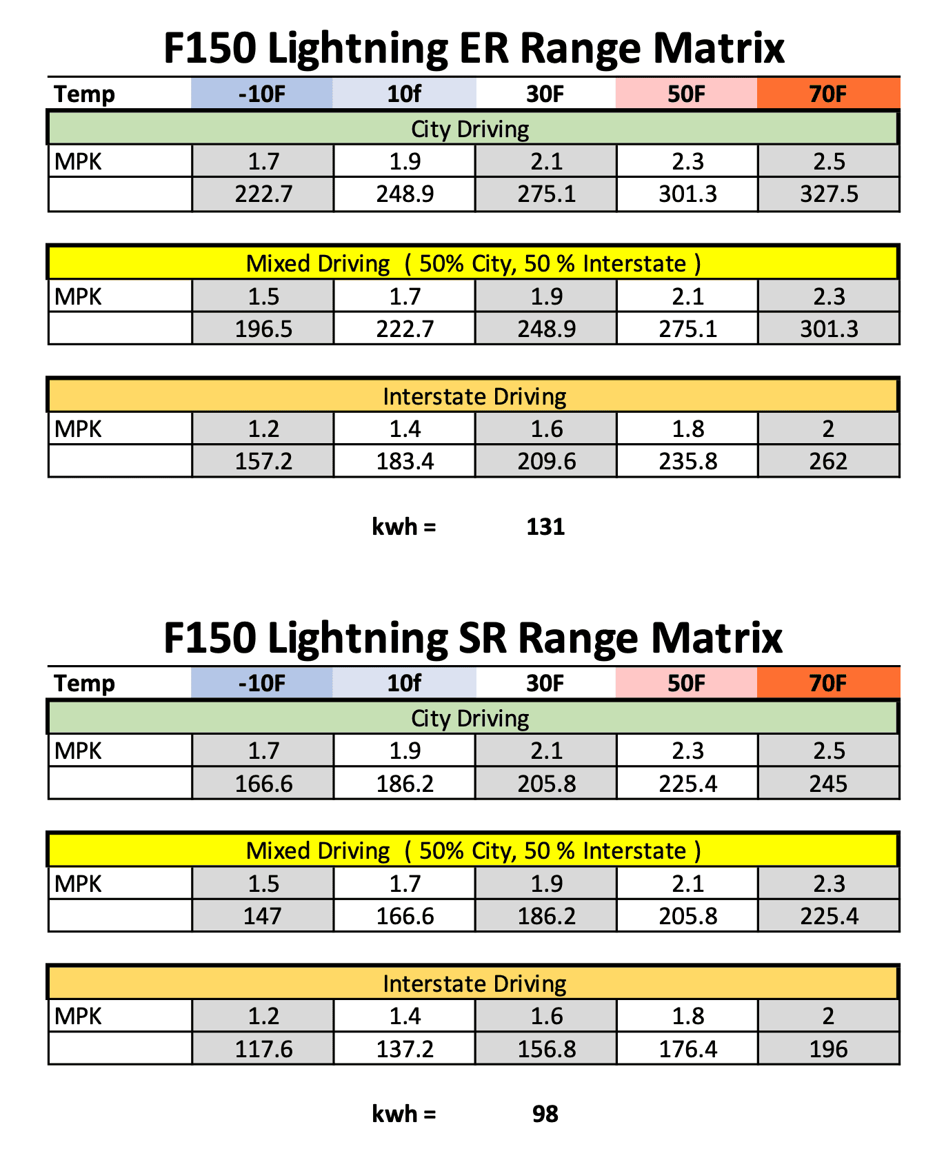

Here you go. I put this together for my own amusement. Laminate and put on your dash.
The SR MPK might be a little more efficient (less weight) but this is a good guideline. Im sure the MPK numbers could be debated a bit, but it's definitely better than the GOM.

The percent number is totally accurate. 63% of the available potential of the battery, as it exists at that moment. As the battery warms, more energy is available, and the range would go up. As it cools, less energy is available, and the range will go down. But that percentage - that's right on the money.
Thanks. Very helpful.
