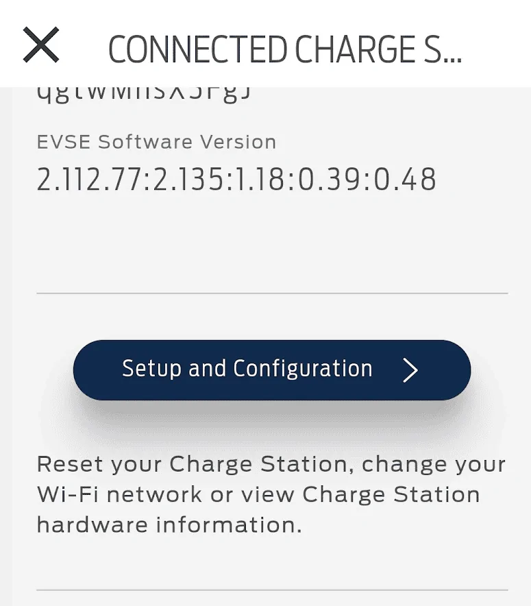

I know the FCSP does not issue push notifications regarding updates, pending or processed, the only way I know it's been updated is to compare a current settings report with the historical threads on this node.
