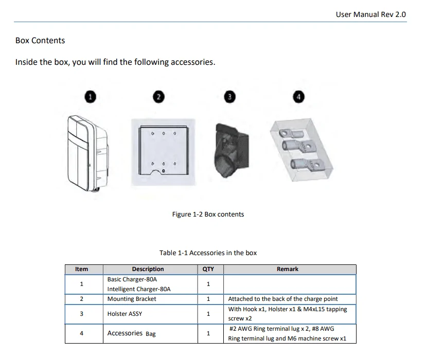

The install requires #2 copper, it would run hotter with #3
That’s completely wrong. The requirement is for a 100A branch circuit, which corresponds to #3 unless there is some unusual derating involved. The terminals on the FCSP are rated for #3 max.

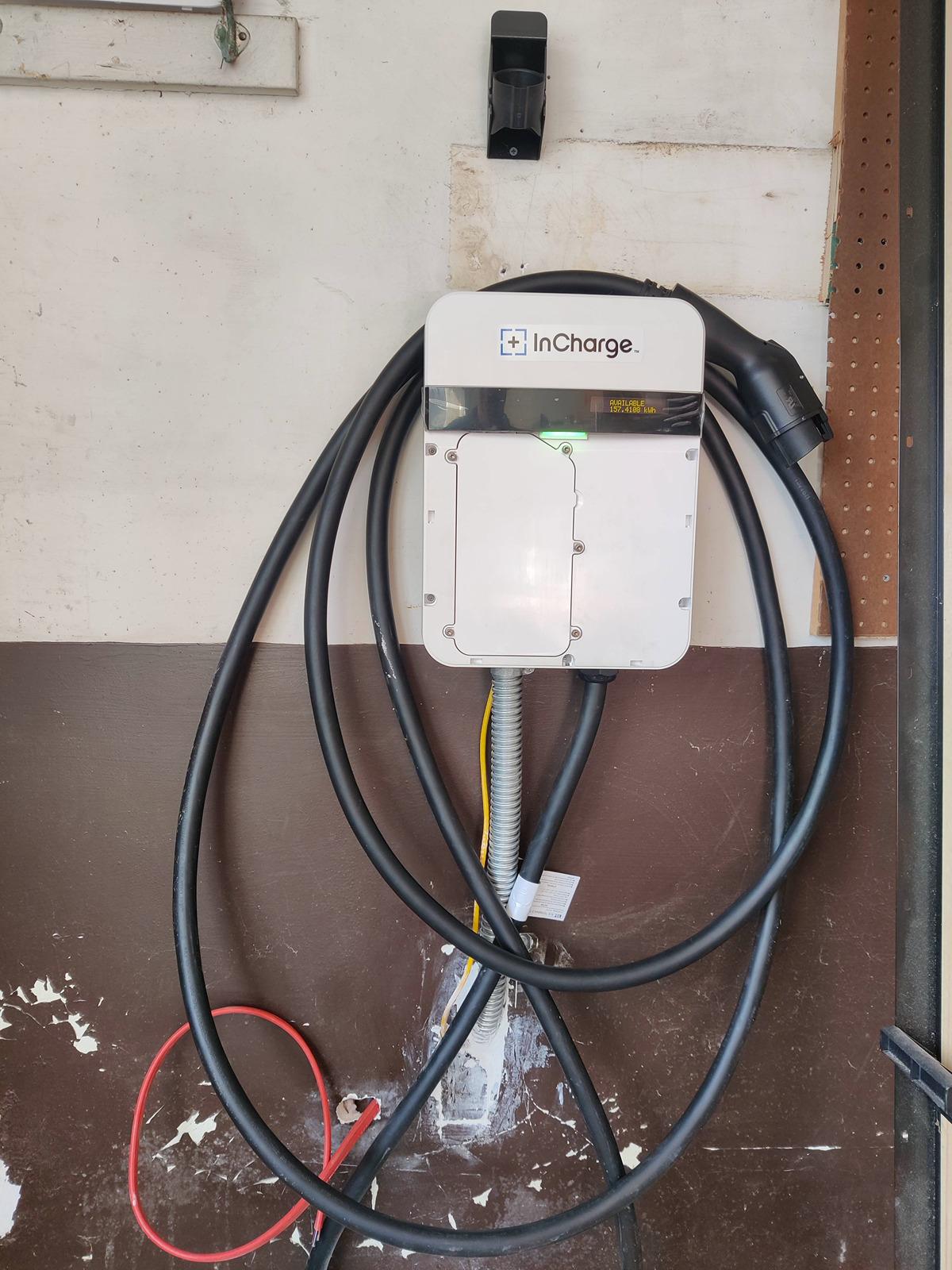

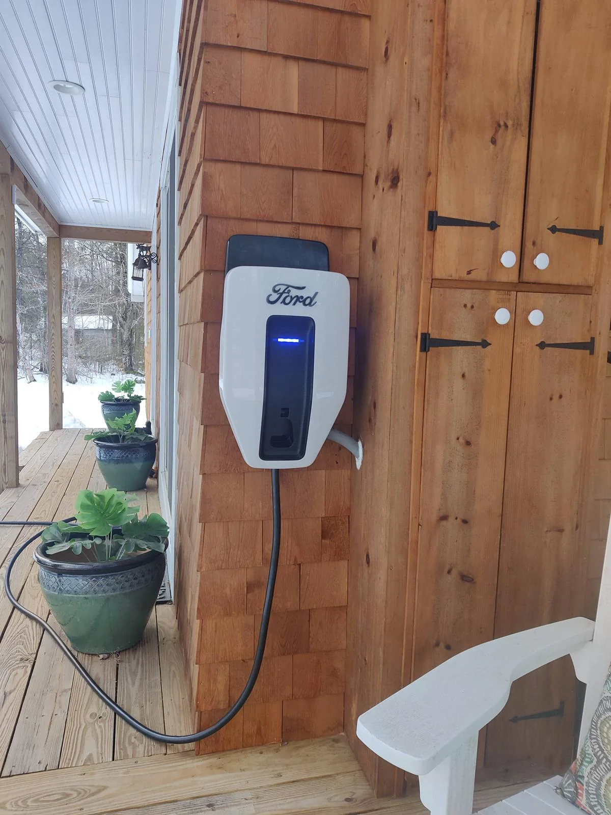

You're right. I installed an 80 amp commercial version (based on the Liteon EX-1193) similar to the Ford commercial one which required #2 wire. Thank you for the correction. BTW, I used #2 for the Ford Pro I installed at our place in Maine so way overkill especially for a 7 ft run. Thanks again!!

Bingo! Funny how the same input/ouptut chargers have different requirements. The run for the EX-1193 is about 65 ft. When I get some time I want to play around with getting the OCPP info from the InCharge one.
