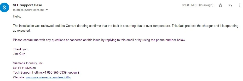

Finally got a response from Siemens. Pretty poor response in my opinion.

Ford just followed up with a phone call reiterating what Siemens response was and washed their hands of the situation. They said there is no more they can do and to just deal with Siemens directly going forward.

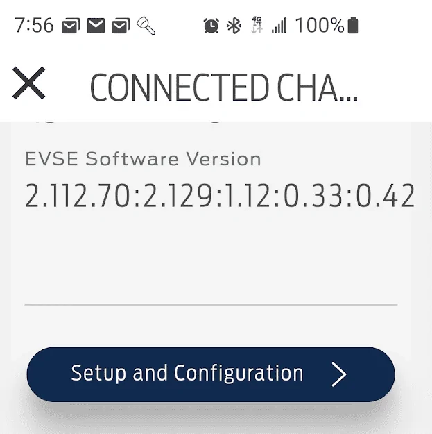

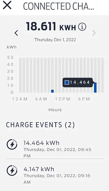

That was quick. Seeing new version in FordPass. It’s nearly identical to yours @TaxmanHog . Max charge current now shows 80A. There is a data point from Wednesday only for 30.722, other days didn’t populate.
2.112.70:2.129:1.12:0.33:0.42. (The 33 and 42 are switched from yours).
im At 80% right now so I’ll wait until later to cycle again , wait 30, then charge.
That's great to hear, the old data might be lost, no big deal, this point forward you should be good to go, data reports and bar graph only update after the EVSE is unplugged from the truck.
My SW version as viewed in the FP app shows as yours does, the previous screen shot I shared was from the FCSP setup utility, you can log into the device as well to see the SW version.
Here is my version as viewed in FP
