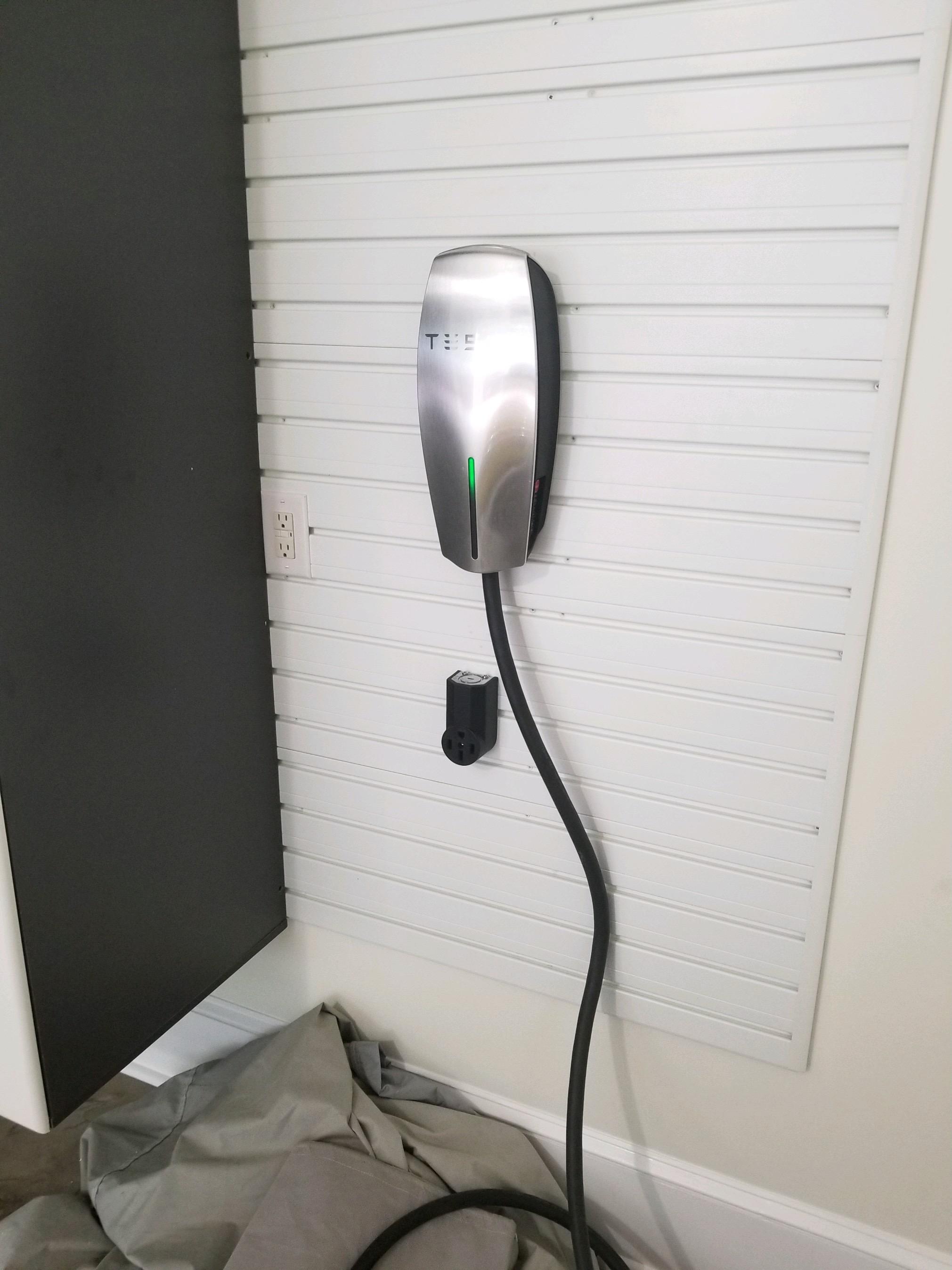

Wise choice. I did the same when my Teslatap mini converter adapter wouldn't work for my Tesla wall charger.
That looks like a gen 1 HPWC. I ran into a problem with it trying to charge my Lightning through the TeslaTap due to some J1772 incompatibilities... when set to 80A charging, the truck errored out. When set to 72A charging current, the truck saw the pilot signal as only 24A - and successively smaller settings generated even less current, all the way down to 12A.
Even the new chargers Tesla is using in their cars can't be charged with a gen 1 HPWC, it errors out on our new charger replacement in the 2016 Signature X (but it charged my 2012 Signature S, 2016 S and 2018 S just fine).
My TeslaTap was also defective initially, in that it didn't work at all on either gen 1 or gen 2, and after replacement I saw the pilot problems.
If that HPWC is set to 80A, that might be your problem?

yes, I sent the TeslaTap mini back to the guy who makes them and he tested it on his Lightning, worked fine with his Gen 1 charger. Both of mine are Gen 1's, very early production, upgraded with the 2013 recall. I believe they are both set at 80 amps. He is sending the adapter back and I will test setting the dip switches lower. He suggested trying 72, then 60, 48 to see where it kicks in. My '19 MX charged just fine up to 80 amps with both chargers, even though the one at my Florida place no longer shows any external lights, assume bad LED circuit. How do you know what the truck is seeing in terms of signal/amps available? I haven't seen any data like that despite looking for it - the only place I've been able to see charge rate/amps is on the DCFC when on the initial delivery road trip.

Mine was a 2012 vintage and I had to do the fuse change too, so we're probably pretty close to same manufacturing time.
My '16 X worked fine with it until the charger in the car failed and they replaced it last year with a newer generation 72A charger, then it gave me the red ring whenever I tried charging with the gen 1.
I can see my charge current via Torque Pro and my OBDLink MX+ dongle. See here: https://www.f150lightningforum.com/...ing-information-data-in-torque-pro-app.11243/
The only problem I have with it is that the current reported gets halved at 30A (when the second charger kicks in to split current). The truck ramps from 0A to 27A then jumps back to reporting 15A (although it's really 15A X 2 chargers, so 30), then makes its way up to fluctuate between 38A and 39A with the FCSP. when I tried to use my Gen 1 HPWC set to 72A, it would only go from 0 to 24 and then stop (dual chargers didn't kick in). I need to find a PID for dual charger activation.

I suspect your truck will probably charge on the Gen 1 set at 72A, but very very slowly.
