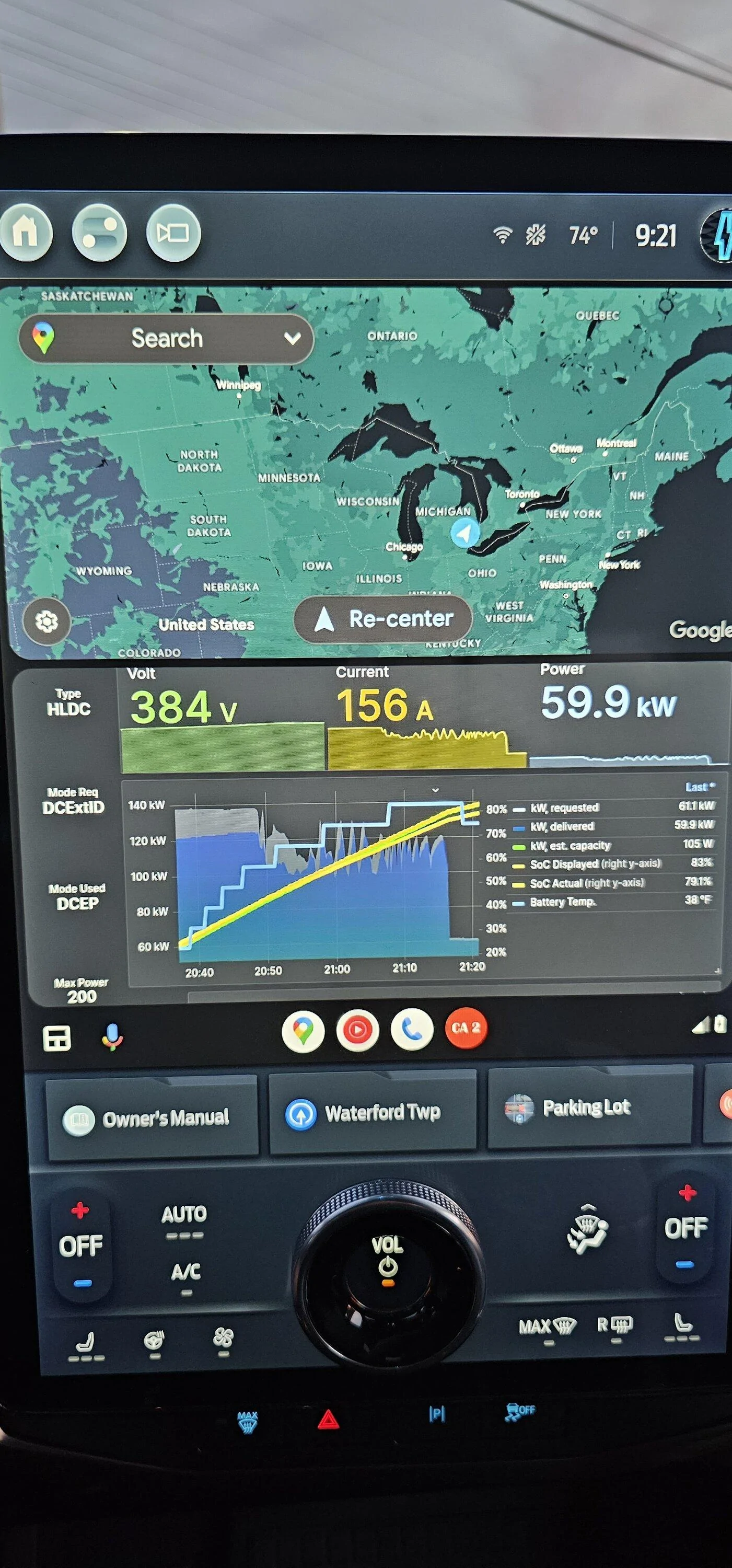

I've noticed thermal throttling in the past and didn't think too much of it at the time. I'm currently at a Red-E charger that has given good "curves" in the past (colder temps) but tonight it started throttling and it's only 74 degrees out.
The throttling starts pretty abruptly (and its not pretty) at about 36.5 degrees Celsius (or 98 F) and in my case it continues until the SoC hits 80% and the charge rate naturally drops off a cliff and allows the battery to cool without throttling. See attached screenshot (can post more detailed graphs tomorrow).
Disregard the lack of conversion (unit says F but it's actually C.

I really wish the truck would give us that info including the rate the truck is requesting.

what is this on the screen? thats awesome having those stats...

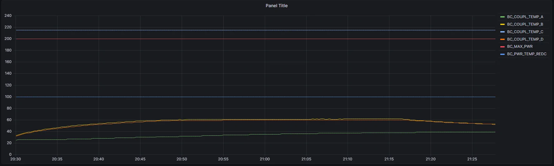

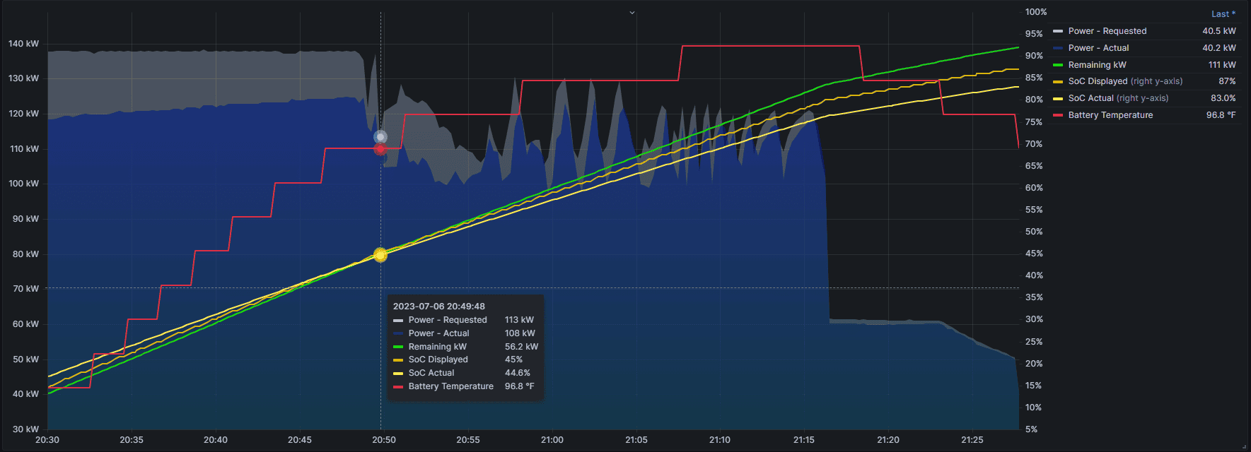

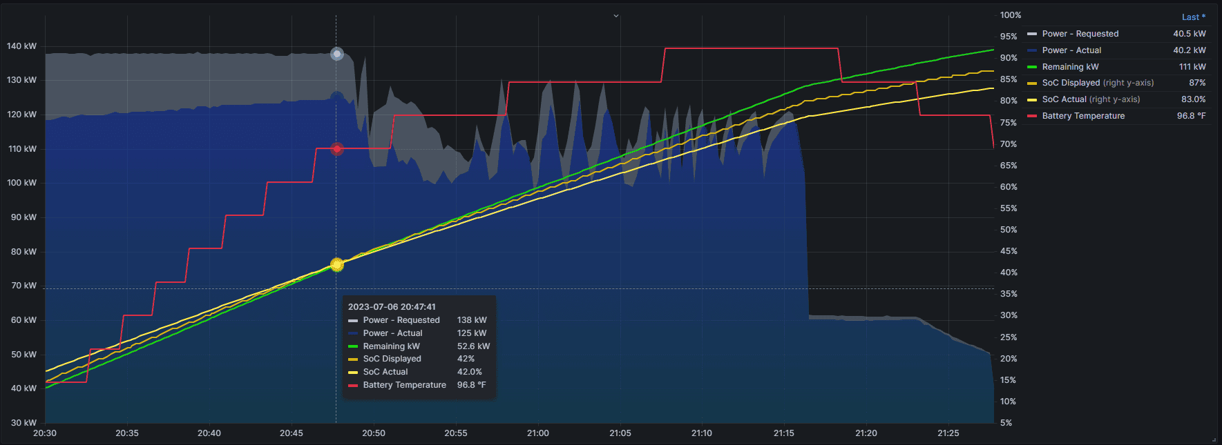

Sorry for the delay, seems Zprime beat me to the answers.... that link explains my setup.
The more detailed logs is below... note the difference between the two, that it's the truck that is requesting a reduced (throttling) charge current. Each "step" in the red line (battery temp) is 1 degree Celsius (data doesn't have better resolution than that).
Also check out the last image, I haven't had a chance to "finesse" the graph, but the darker blue shows thermo throttling from the charge side and in this case it's not doing it (value remains at 100% output).
