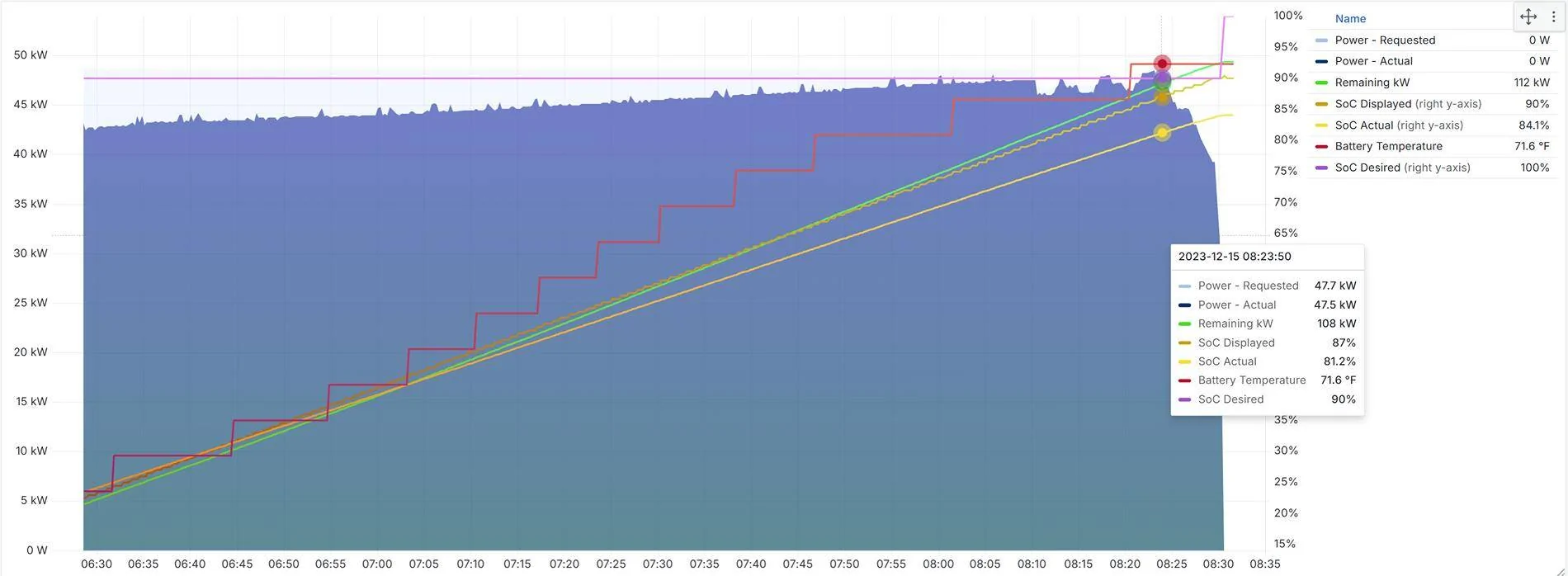

Ford F-150 Lightning Charging rate at 50KW ? 1743779472887-g6
Here's a charge curve on a 50kW charger going from 20% to 90%

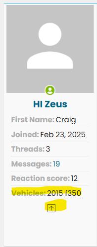

Yeah, cause I plugged that sucker in for hrs and fuel level didn’t budge! 😂
The lighting is a future purchase for a Hawai’i move, in part to provide power for build/camp site until the solar is up and going. There is a 50KW charger 10min away. No 150kw.
thanks everyone for the info. Charging while I have a long lunch every few days sounds like it will easily keep me in business.
