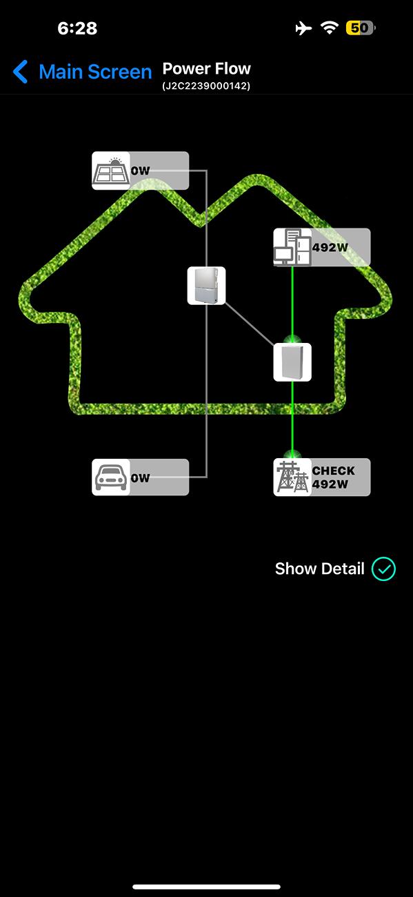

Please try something...try rebooting the delta inverter one time. I was working today with another person who just had the V34 update, and they had the same issues as you. After completely rebooting the inverter (you have to turn off the Dark Start battery) their system worked again. That was the only thing we tried which seemed to work. On my system the .34 has always worked, but it is highly probable that I had rebooted my inverter because I was also wiring and testing the LG battery.

How did you turn off the dark start battery?
Get the M Professional app from the iOS or Android app store. Launching it will give you a DEVICES screen that says "No Device Found." Tap the Search icon (magnifier at the top right of the screen) and be near your Delta unit. Your unit should appear on the screen as "E4_BDI SN:xxx."
Tap the device line. After a "Connecting ..." logo, you'll get an entry box that says, "Enter date code of the device." It's a four-digit number on the serial number plate on the cover of your Delta inverter unit (that you should look up before running the M Professional app!). On the main screen, if the firmware is not the latest, you may see an update pending notice. Update the firmware if you want. Tap the MENU option at the top right, and tap "Advanced Features." Pick the "DS Battery" subitem. There should be a Shutdown button. Tap it once or twice and if all power has been cut off to your FCSP and inverter set up, the solid green LED on the FCSP (which was being powered by the Dark Start battery) should go out.
If you're like me, when you first try to shut down the Dark Start battery, you may find you get a configuration warning out of the app. IIRC, the error message gives a hint as to where to go in M Professional to fix the problem and be able to make the DS Battery shutdown work. Good Luck!
A cool thing about the M Professional app. Down at the very bottom of the Main screen (scroll down!), there is a Power Flow item. Tap on that. Tap details. You'll get an animated graphic that shows how current is flowing (or not flowing!) in your system:
