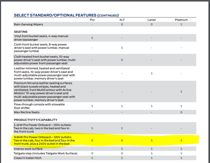

If you are thinking about buying a Lightning, you need to buy one with Pro Power OnBoard. I bought a 23 XLT Lightning with the PPOB and no other options, not even the $500 charging cable. The PPOB system should be standard on the Lightnings in my opinion.
PPOB 9.6kW - is an option on some - was on my 2023 Pro.
They all have the 2.4kW version standard, some have the 9.6kW standard.
