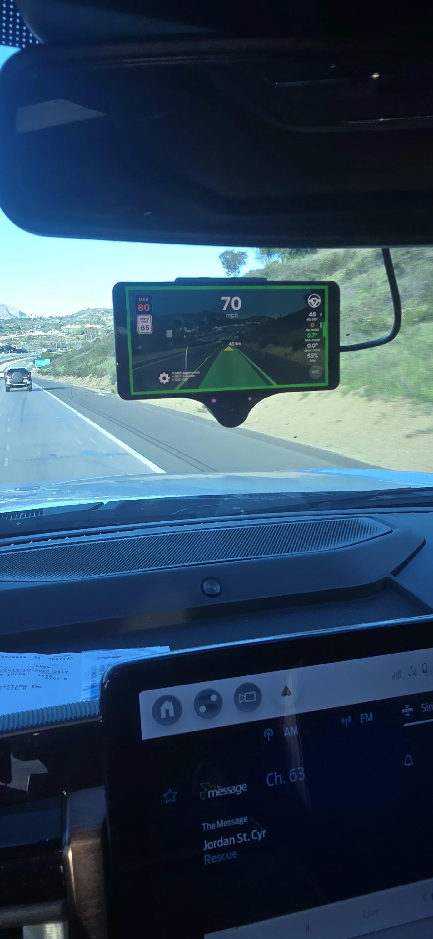

Just got the comma 3x running in my truck. I'm having some start up faults while the comma 3x is booting. The lighting throws steering, related sensor codes. Then after it comes on line within 20 seconds it all goes away.
First impression is that this is powerfull tech. I need time to get used to it's abilities but it's working. Way more stable on freeway and it works on side roads. I'm not comfortable with it driving me fully on side streets with stop lights quite yet.
Looking for solutions to get the warnings to go away. I was told the lighting has lots of electrical interference. I may try adding a ferrite core around the usb cable to reduce the interference.

Thanks guys. I had a major hand injury on Sunday . I have to park this project for a few weeks. I need a surgery in a month so thus will delay me a bit but I can tell the comma system is getting really advanced with each update. It's really good up to 65mph. I'm still having ping pong issues. Could be. 1. Micro vibration on the windshield mount. 2. My tinted windshield. 3. Alignment issue. Or 4. I need to recalibrate the ipma as some sensors from Ford the comma may be using are out if whack.
Ajzride from f150 forum made a lengthened harness with a resistor so us lightning owners don't get interference on start up causing can bus errors. This is out for testing with another lightning.

You need the new comma x3. And ford q4 harness.
Right now there are guys working minor bugs out for wiring so we don't get errors on start up. This may be solved soon with modifying the q4 harness ( it's easy, just lengthening a few wires and adding a resistor).
I can pass on the usb cables and other minor items I used.

I'll post the usb cable that worked for me. You also need a 6 inch cat5 patch cable. Any will due. Keep in mind. Once the bugs are worked out with the modified q4 harness we will not need the usb cable. The supplied cables should work. I don't have any idea when but it should be soon.
