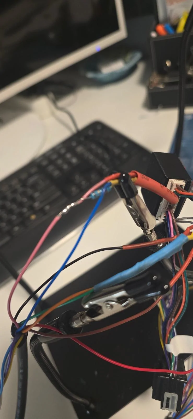

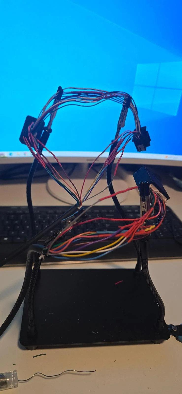

You need a modified harness. Ajzride has a prototype made and it works. I'll have mine modified in a couple weeks. I can modify them for others once I'm comfortable with my own

I just modified my q4 harness.
