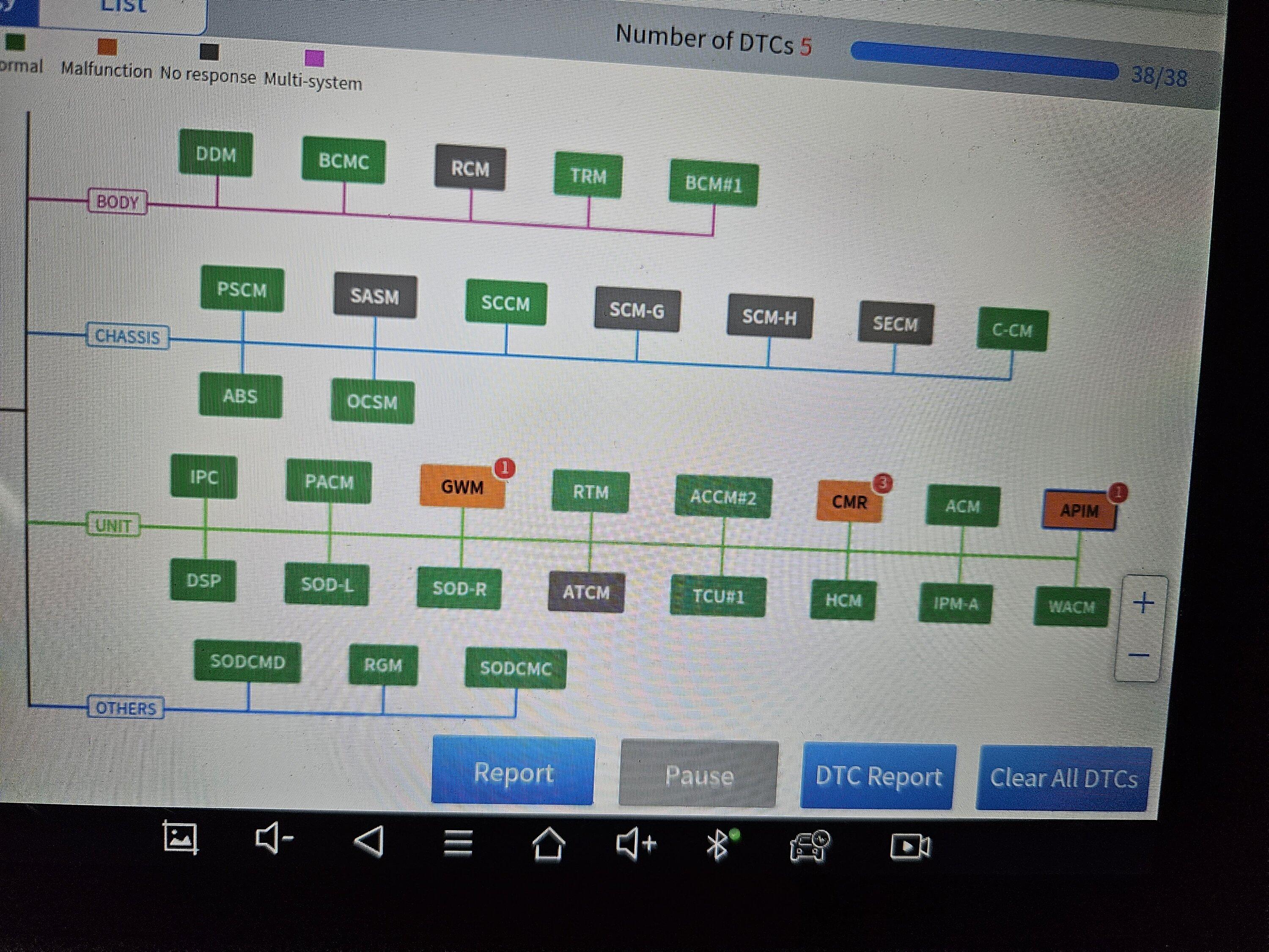

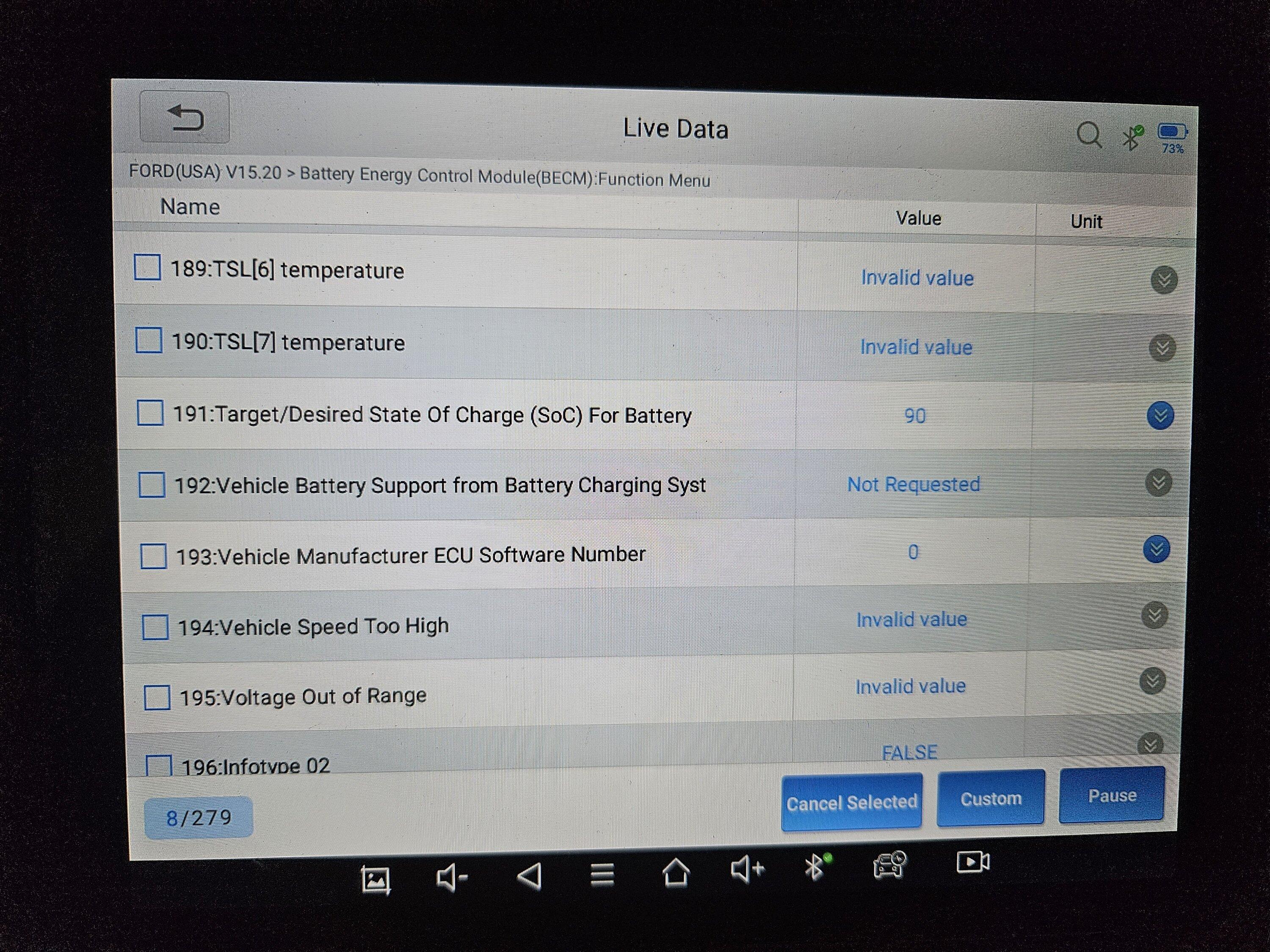

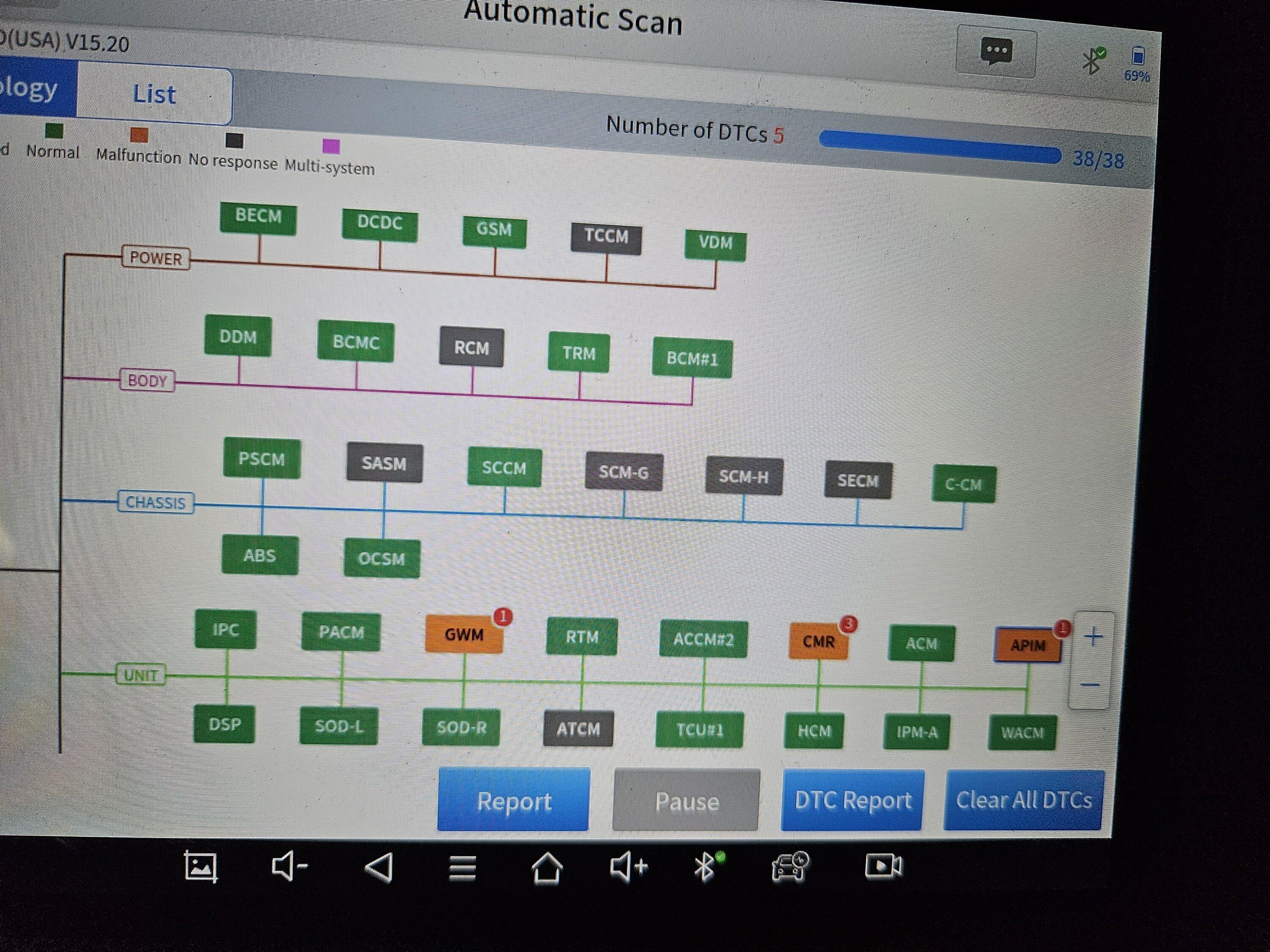

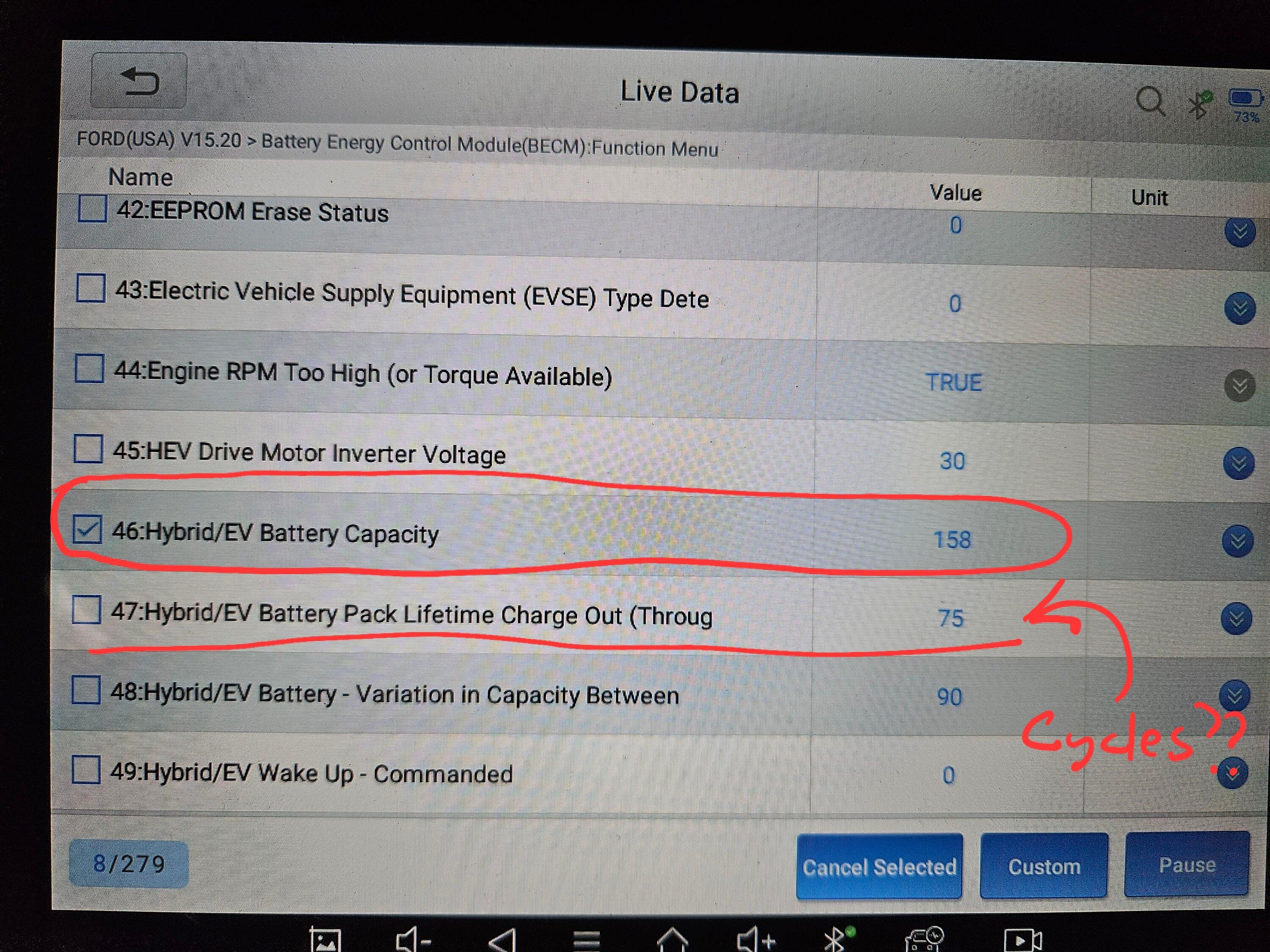

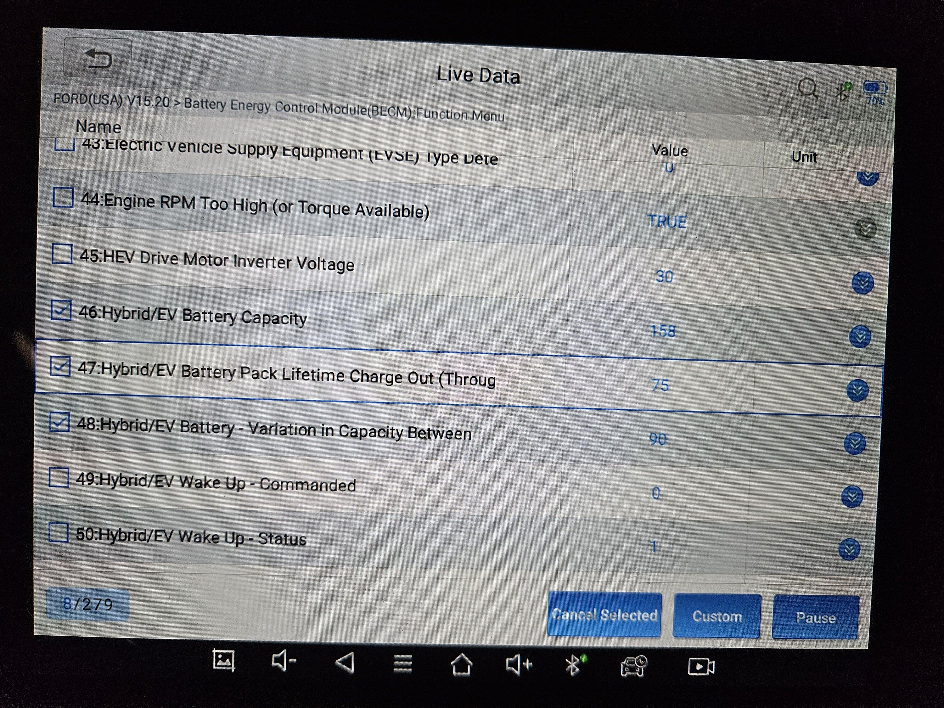

Also I was debating on whether or not I should start a new thread for this, but I think I can just leave this here. My XTool scall tool recently got a new update that gave it full compatibility with my Lightning's systems and I finally got around to trying it out last night.
I did a full scan and other than "silent" (don't illuminate a dash light) codes related to my TCU being unplugged (privacy/security concerns), I didn't see any other codes. I went into do a full scan of the BECM and here's some of the live data I saw. As of now, doesn't seem like this can get quite as granular as FDRS with individual cell voltages and module breakdowns, but this is still nice to see.
Also at least per the BECM it appears the actual pack capacity is 158KWh. If true, that is a significant buffer that Ford built in. That certainly boosts my confidence in the pack having a longer cycle life, especially if it's only charged to 85% or 90%.
There's also one listed value that looks like it might be cycle count, but my scan tool for some reason won't allow me to view the full text field and based off of what I can read, I'm not sure. Any ideas?

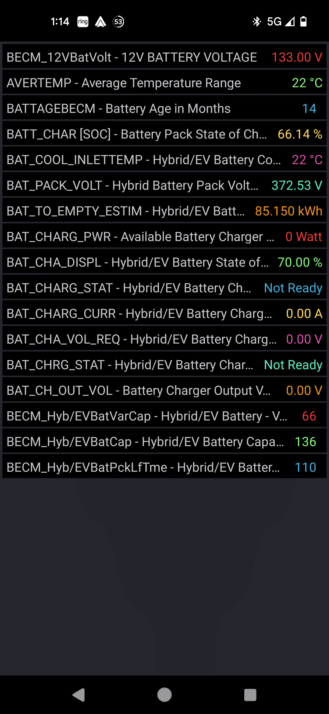

So I just got an adapter and forscan light and still trying to figure things out, but to your point. A few weeks ago I was seeing 131 for the capacity and last week it changed to 136 after one of the updates...
Oh wow that's cool data to see, glad we can compare some of the more detailed metrics. Okay so I'm fairly certain after seeing your value that EvBatteryPackLifetime has to be cycle count. Although Ford doesn't let us see it in the UI, good to know there's at least a way to see it.
And I see, that's interesting. Yeah I'd almost say that 136 still seems too low for overhead. I vaguely remember some engineering data or something mentioning something like 141KWh or 145KWh. But yeah to me 158KWh seems like an exceptionally large buffer, but I guess it's possible?
I think we need to defer to @MickeyAO for an expert opinion on the matter and the numbers we're seeing!
