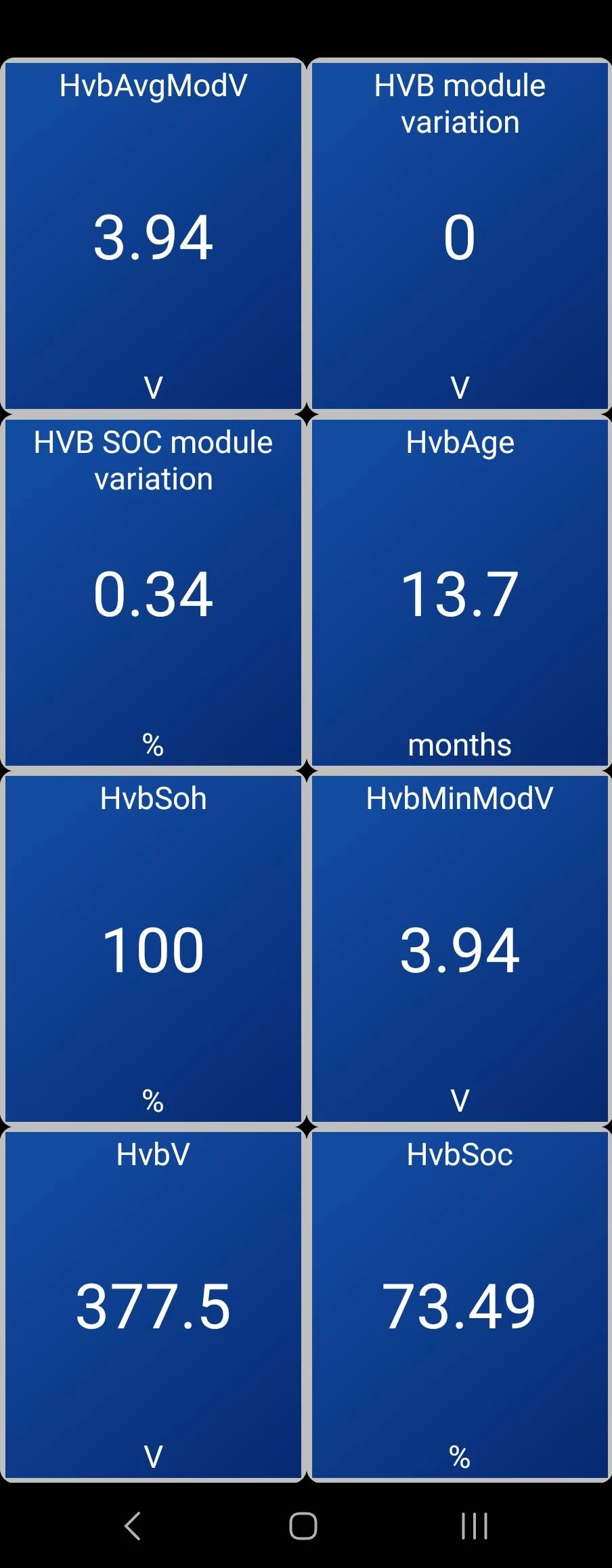

Well all this talk of battery module issues and failures had me concerned so I rechecked my battery stats live data from the BECM via my OBDII dongle and it would appear that my battery is still healthy as a horse.
Any of you guys have an OBDII dongle and wanna compare data?
My SOH 98.5% but battery age is 4 months younger. My battery Voltage shows 328.25 V (at SOC of 42%), HVB SOC MV 0.36 HVB MV 0VM.V

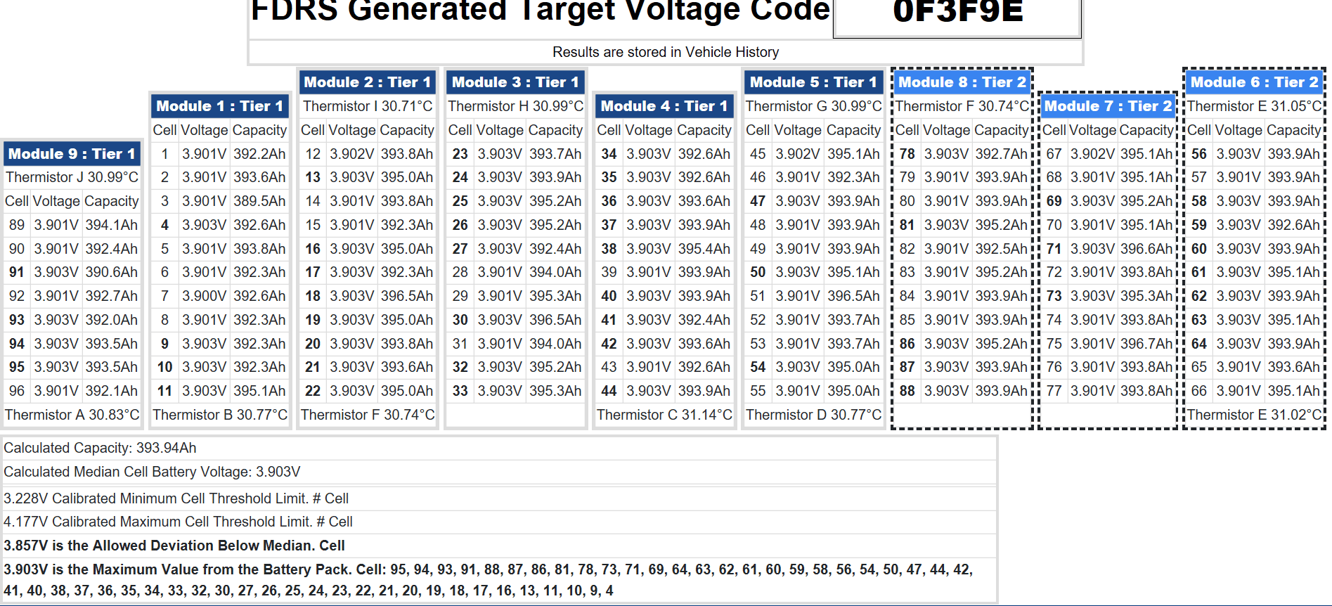

Went ahead and did the updates with FDRS then ran the battery health check. Deviation looks good as all are within .004 of each other. But what do the cell capacities tell me? Is this the capacity of each cell at 100% or does it reflect their current SoC (I was at 71%)
Ford F-150 Lightning CSP-23B57 for High Voltage Battery Notice Screenshot 2023-10-03 000031
