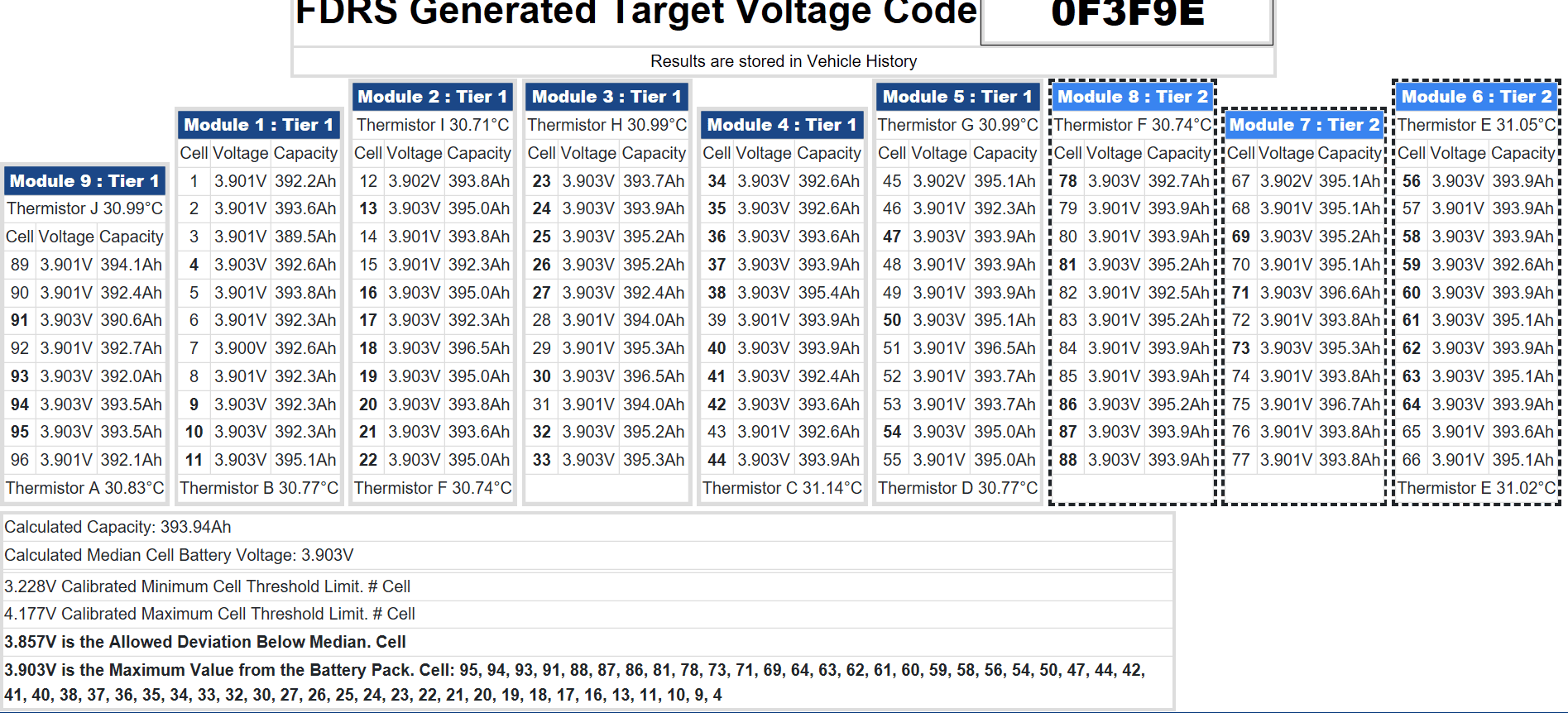

Went ahead and did the updates with FDRS then ran the battery health check. Deviation looks good as all are within .004 of each other. But what do the cell capacities tell me? Is this the capacity of each cell at 100% or does it reflect their current SoC (I was at 71%)
I'm pretty sure that's the current total capacity of each cell. They should all be connected in series within each module
