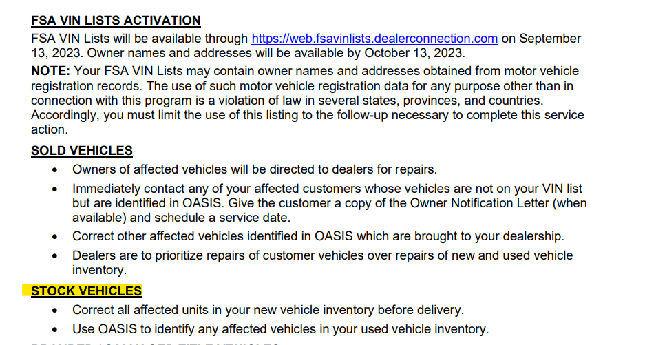

Just bought a new lightning to replace my previous lightning yesterday. Anyone know if 23B57 should have been performed before they sold it to me? Does ford not have a stop sell order on new on lot lightnings that have not had the 23B57 performed yet????
I am a bit upset at dealership to say the least for not having done this yet before the sale based on my previous lightning experiences…. I was told all updates and recalls had been done on vehicle as of yesterdays date. Obviously I did not find out this until this am when I called service department and gave them my vin to double check what the app was showing. Seriously?
Dealership purchased from is couple hundred miles from where I live. Not going to be convenient for me at all…!!!!!
Yes, it should have. I was in the same position when I bought my truck certified used from the largest Ford dealer in my state. I found out after getting it home the update hadn’t been done, and I was pissed. I had a 14-day return policy with the Ford certification, and I was going to return it if I had a module failure code. It went back for 23B57 the following week, and the module failure didn’t happen until a few months later.
I would be just as pissed off in your shoes. BUT your new truck should have much more recent build than your old, so hopefully the battery gremlins aren’t something you’ll have to deal with.
I’d suggest calling Ford’s customer service line, opening a case, and getting it in for that update.

If the Fordpass app is still showing the CSP alert, that's doesn't mean they did not perform the update, many of us still show the alert, while a very small handful of members have seen it disappear, IMHO they are the exception.
Thanks I called service and they said they wait until sold so it can be billed on warranty, really? I now know.
23B57 has NOT been done and has outstanding sync update they did not Install either… 23B??
Day 2 of new lightning ownership now…
Learn something new every day. Ugh!! 😩
