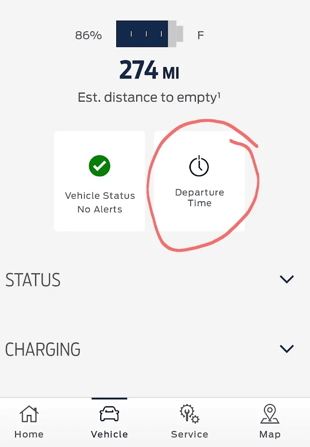

Are you not seeing Departure Time on the main "VEHICLE" page as shown here?

It doesn't. Just shows the vehicle status no alerts.
