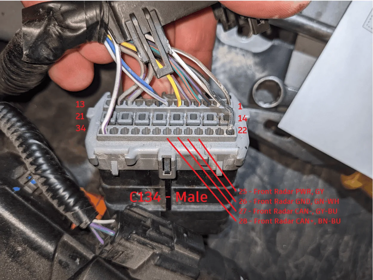

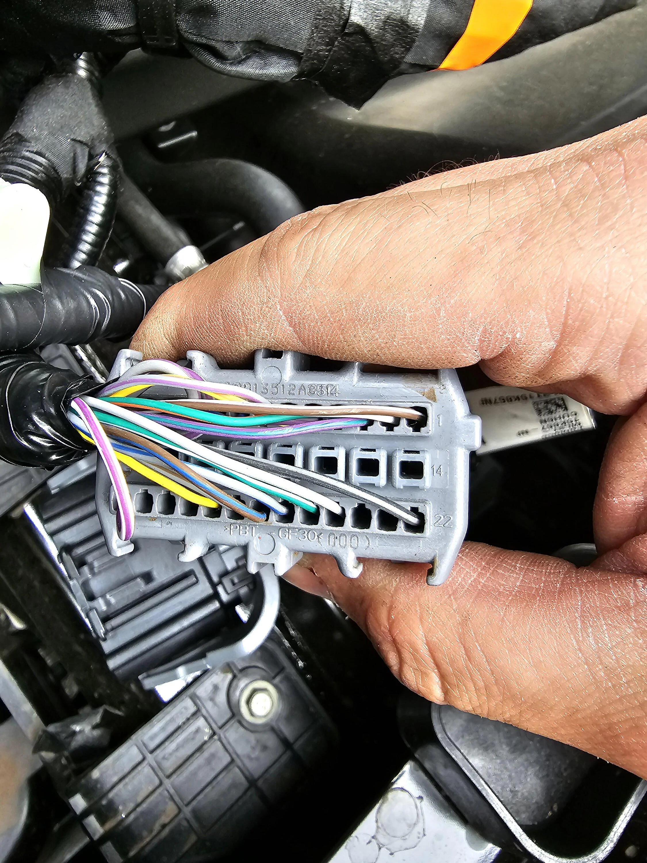

I'm in the middle of my install on my 23 pro (max towing and tow technology), and it looks like I have the wires at c134. Just want to make sure I'm not crazy, cause that would make things a lot easier and I guess I'd be done with the install now

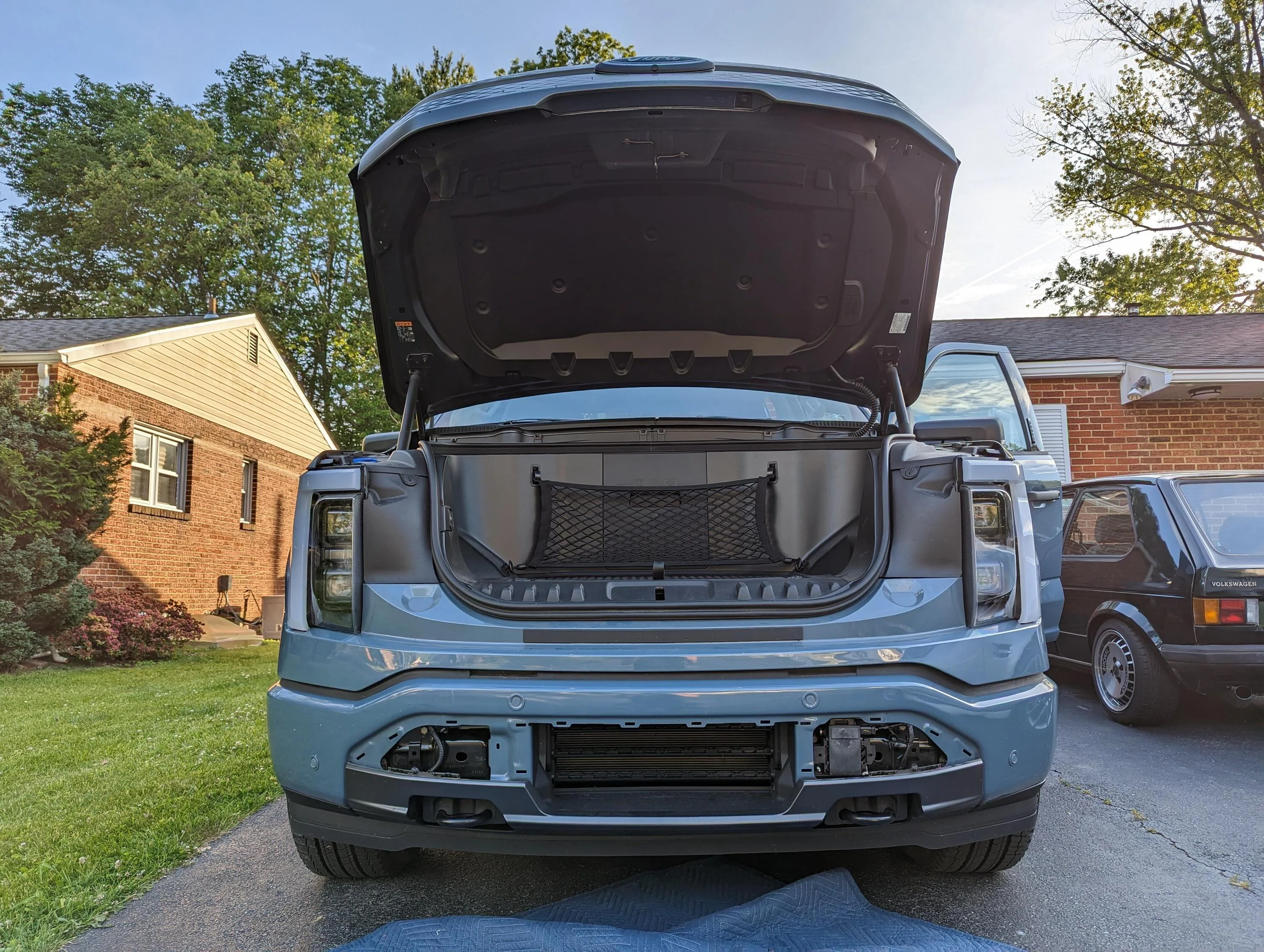

Got everything buttoned up a little bit ago, laptop died while I had it out on the seat going over this thread for some clarification on things. Only had the parts sitting in my office for a few months now; school and work getting in the way of fun things.
I'll get it charged up and try to make the FORScan changes tonight or tomorrow.
Got the trim piece snapped back in place and bolted in on the wheel wells only to remember I hadn't fully taken apart the C134 connector to check for the wires but it looks exactly like the connector posted by @jdmackes
Took 3 hours to get everything apart, harness routed in the bumper, and everything back together solo aside from needing the GF to give an extra hand getting the bumper mounted back up....didn't want to drop that on the driveway. :censored:
Looks like it, luuuuuuucky:
