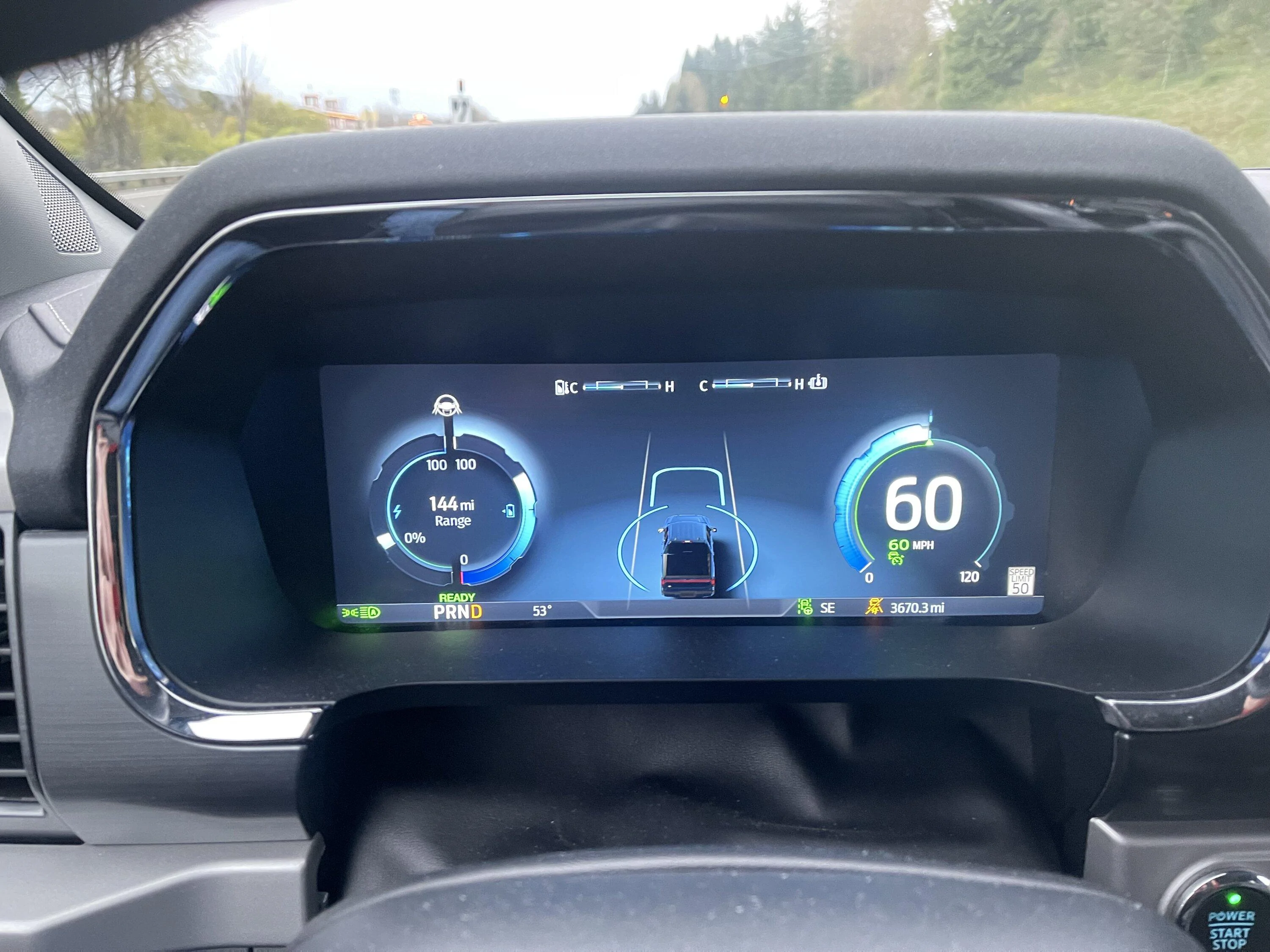

I'm happy to report that ACC and Lane Keep Assist were successfully installed on my 23 Lightning Pro today!!!
Like some others, I had to add the power and can bus wires from under the glovebox to the new harness in the bumper. 4 wires total. I was working with the original poster, Brotato, who put in many hours on this challenge. Once the wires were installed, the ACC module in the bumper was recognized immediately recognized in FORSCAN.
We did have some challenges after running Forscan and calibration of the module. We successfully calibrated the truck twice but it was not recognizing either the ACC or regular cruise control module. After about an hour and a half of going through everything we could think of, checking all Forscan settings, rebooting the vehicle, disconnecting the battery, it still didn't recognize the module. We had given up for the night and I was driving the truck home when all of a sudden, ACC just worked out of the blue. Maybe it needed to be driven a few more miles after the successful calibration, who really knows? Anyhow, I guess patience payed off. I believe this is the first reported Pro to receive this upgrade. I am stoked beyond words.
My sincere gratitude to all in this forum, but especially Brotato (Daniel) and ZSC100 (Zach) whose help pushed this over the top. Thanks again guys!
This was a 2023 Lightning Pro with the Tow Technology Package Package (with 360 degree camera).

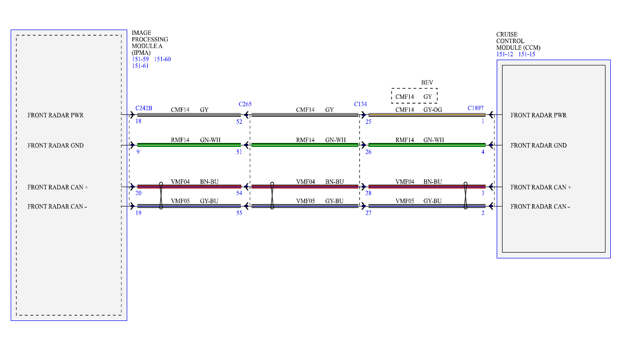

So, I actually tested voltage at the bumper CCM plug before I even plugged in my module. I did this because I'm an electrical engineer and I A: don't trust the engineers to have built polarity protection into the CCM and B: don't trust myself and all the pin work and wiring I did after midnight across several days and work sessions :). So, I did 100% verify that the IMPA changes turn on power to the CCM. This power can be tested for presence with a volt meter or 12v automotive test light. There are only 4 pins used on C1897 (the CCM plug) even though it's an 8pin connector:
Ford F-150 Lightning DIY: Installing ACC (Adaptive Cruise Control) and LKA (Lane Keep Alert) to 2022 F-150 Lightning XLT 1682726353607
Execute the IMPA changes then test the GY-OG and GN-WH for 12v power. If you don't have power and you've successfully executed and checked your IMPA config changes then I bet you have a section of wiring missing somewhere. Let us know what happens.

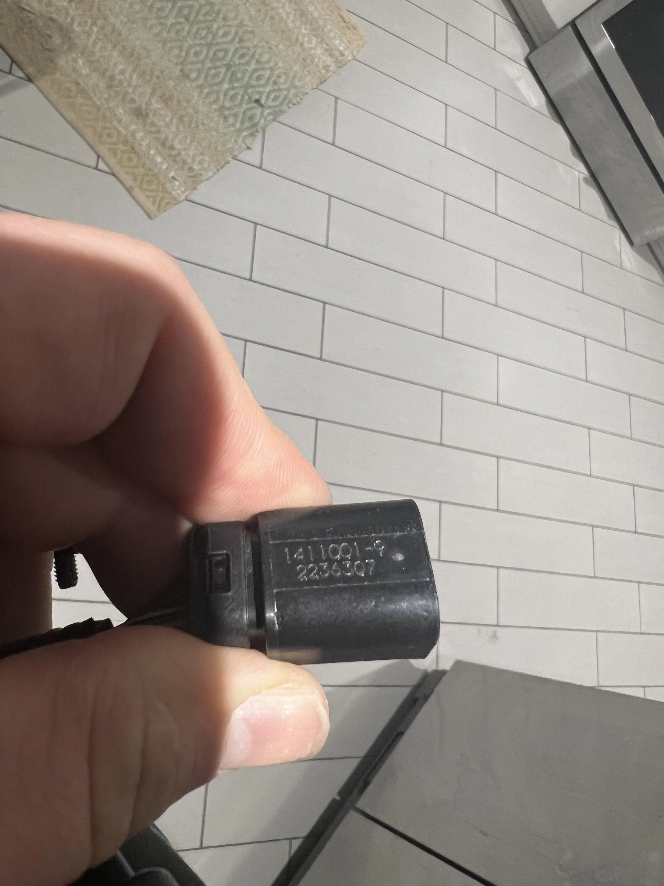

I finally got some time and performed this install. Everything worked for me with no extra wiring. I did check the c134 connector and found it populated already, so I was good to go. Calibration went ok, it did sit at 99% for a while. I have attached photo of connector for CCM if you wanted to build your own harness from the CCM back to C265. I have wires and pins available if some one wants to buy them. I didn’t need them for my install.
Sooooo I have one of the XLTs that had the wiring on the driver's side but nothing from the passenger side to the bumper. After running the four wires I magically have 12v at the connector who would of thought 😂 I got all of the settings entered in Forscan and programmed the CCM module twice to 100%. Throwing the message that adaptive cruise control unavailable. Hoping after being left alone overnight it works in the morning like a couple others seem to have happen. If not my laptop is in the frunk waiting in the morning 🌄. The project was fairly easy even with having to wire up with the CCM. The worst part was the lack of access in the passenger footwell and never removing pins from the connectors but YouTube helped my confidence pretty quick.
