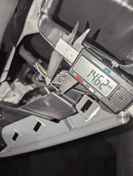

Thanks for the info. My last and final question (until I have another in 3 minutes), how are the pins inserted into the IPMA connector? Just slip right in the back, or is there some disassembly of the connector required?
ZSC100
Zach
Mar 29, 2023
306
220
Tulsa, OK
Electrical Engineer
It's really easy once you understand how the connector works, you have to retract the white retainer (or take it off completely if you want to inspect how the connector works). The pins insert from the back (wire end) and click into place with a spring loaded catch tine. You can look into un-populated slots to see how the catch tine works and even take a sharp pic and reach in and actuate it if you are curious. Here is a pic of one of the extracted pins so I could take accurate measurements:

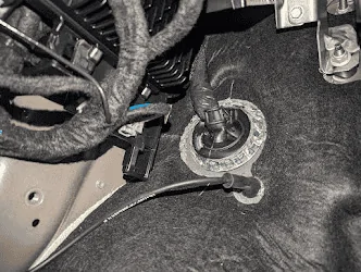

Get some black cloth tape to make your new 4 harness and it will be super easy to take it through this firewall boot:

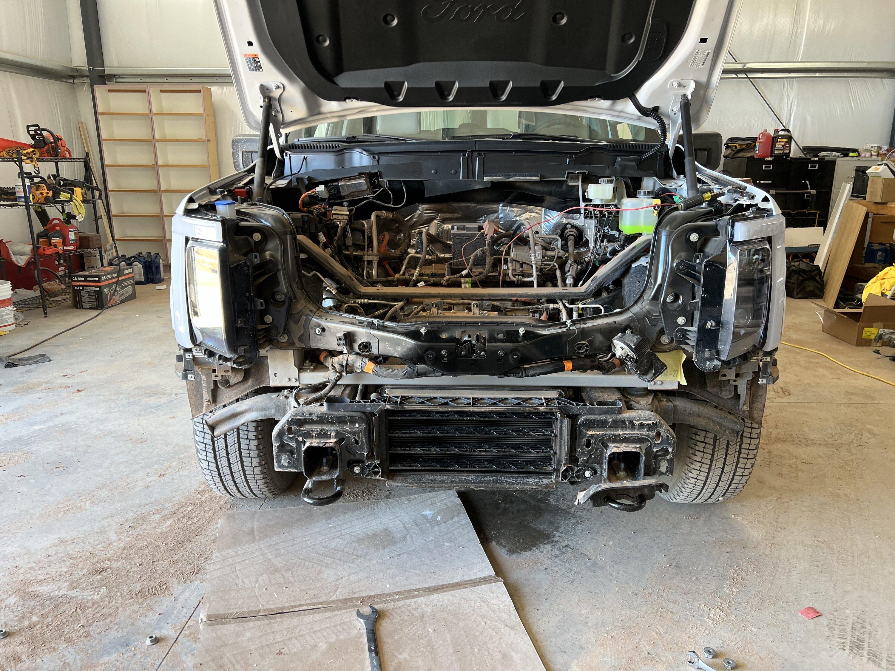

Hell yes! That's a nice work area!
Good luck! I take it you have all the parts at hand?
Thanks! I have an 80x80 barn I can work in. It’s smaller now since we built a house in it. But I still have tons of room.
parts are in town at the post office minus the steering wheel button, that’s still in transit.
