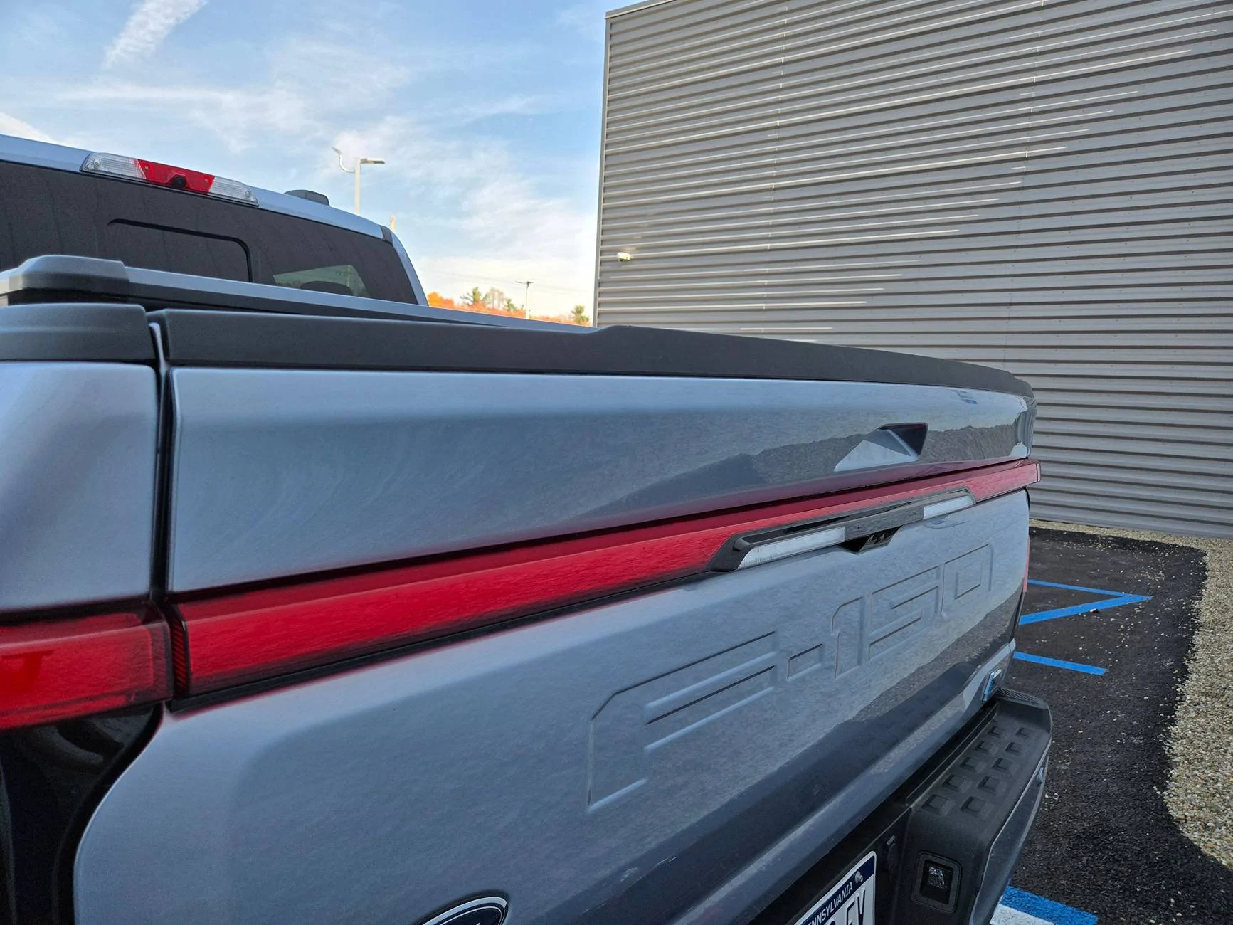

Currently at the dealership waiting on my truck, brought it in just for the lightbar and figured I'd ask them to replace the 12V BMS while they're at it. I told them explicitly, no updates and no other recalls. Fingers crossed they don't break any clips. 🤞

Just got my truck back from the techs. No broken clips and new lightbar successfully installed. New 12V BMS as well!
I was surprised that the tailgate top cap is a one-time use item that actually gets broken when it's removed. So the lightbar is new and so is that top cap they put on there. There's apparently no way to get a trim tool in to release the molded clips, so they break off if you try lifting it too hard.
Not in my case. Can confirm based off of red dust from south Dakota from my road trip, they reinstalled that upper piece.
