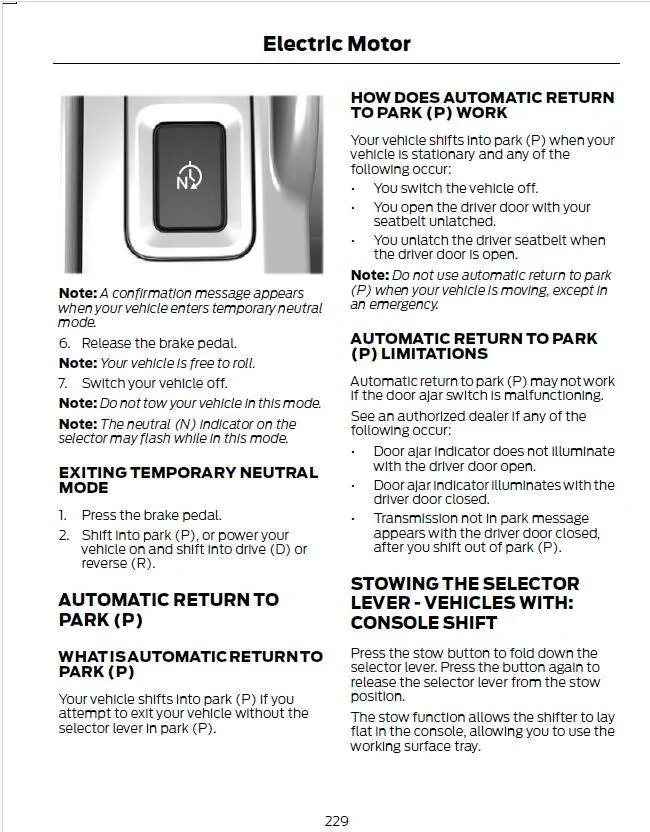

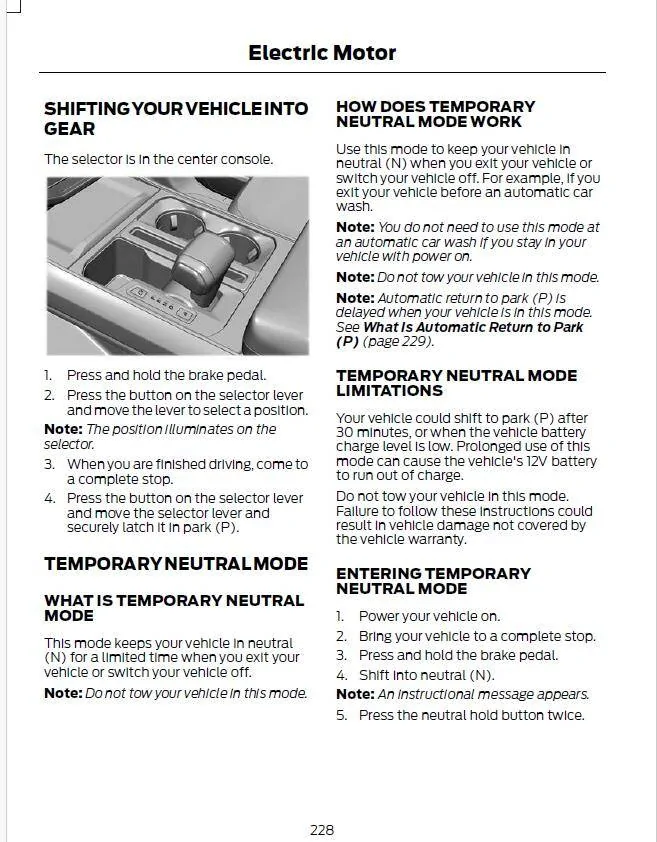

I wonder what the current draw for the parking pawl solenoid is?
Could it be high enough that it along with all the trucks control modules being active, it pulled the battery down quicker than anticipated?
208
15,372
17,099
Note the Temporary Neutral Mode Limitations warning
Ford F-150 Lightning Don't leave your truck in neutral with the truck -OFF- it will drain your LVB 1739738004128-fj
