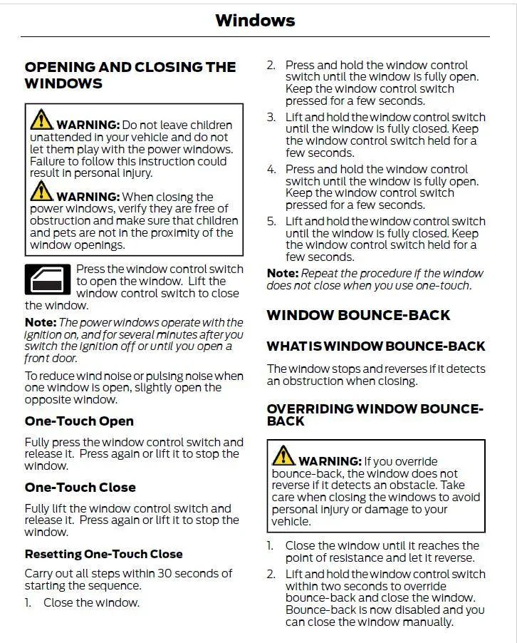

I had this behavior last summer. I had to reset the one-touch close for both windows (both fronts, but not acting up at the same time) but the issue returned. I sprayed some silicone lube into the window channels at the front and rear of the windows and haven't had the problem since. ??

I just recently had the same issue and I guess I disabled it in frustration by messing with the buttons.

Had the same issue, dealer said it's common with F-150's and reset it. No issues sense.

Ya, I found this out when I Installed my Weathertech Wind deflectors. It would go up, then immediately reverse. Quick fix for that
