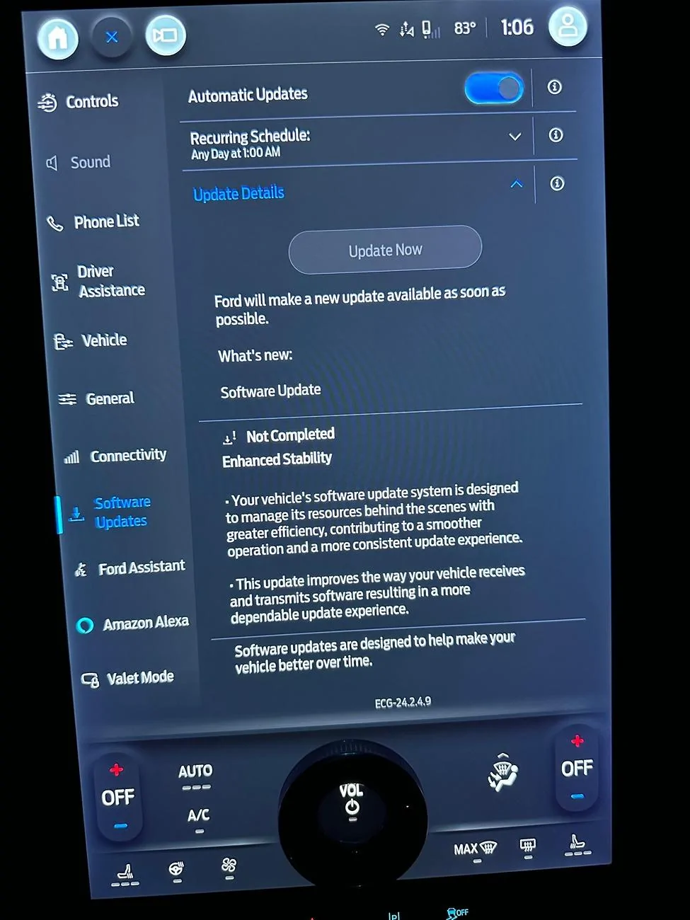

TLDR; In spite of all the below, while mucking around with the truck at 5 AM( :D) , I just got a successful update of ECG-24.2.4.9 after my initial truck-reported failure on 6/22/24. Time will tell if I still have a gateway module A software-level problem and DTC U019B:00 comes back.
Further twist in the road. Last night, when I turned on my truck, in spite of a previous successful completion notice on 7/3/24 for the ECG-24.2.4.9 update, I got a new NOT COMPLETED notice:
Ford F-150 Lightning ECG-24.2.4.9 Software Distribution Enhancement IMG_0997
Then, the truck tried to install Priority Update: 23-PU0813-DOR-UP2 (the windows, mirror, and lock controls update). The UP2 update failed, leaving my truck bricked in INHIBIT MODE (undrivable).
I wondered if somehow having the ECG update go "NOT COMPLETED" had anything to do with the truck failing the UP2 update and getting bricked...
