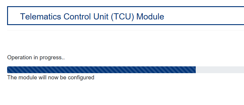

So my first APIM update was a success but kicked off a TCU update automatically after it.
USB completed and validate passed and then it failed on configure. Retried a couple times and now it's been stuck here a long time (30 mins?) and the progress bar keeps repeating.
Is this normal or what do here? The first two were very quick here so it appears stuck...
Still stuck here... Sorry that I'm such a newbie. Anyone?
As long as you were successful in the update youll be ok. Try to run a config in a few days NOT a PMI a config. The update was mandatory they were together to that update. If they were not done together the TCU wouldnt work
