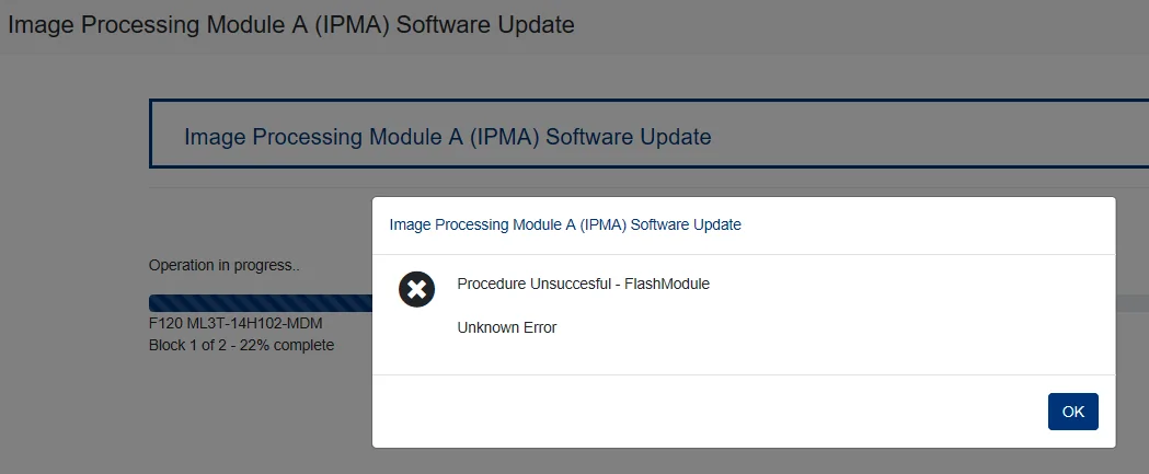

I've gotten everything installed until the IPMA failed and now I have DTCs like a Christmas tree. I've tried to run it again and it appears to be running but still fails. Attached is a PDFs of a print out of all of the DTCs now.
Ford F-150 Lightning ECU module programming guide using FDRS IPMA Error
