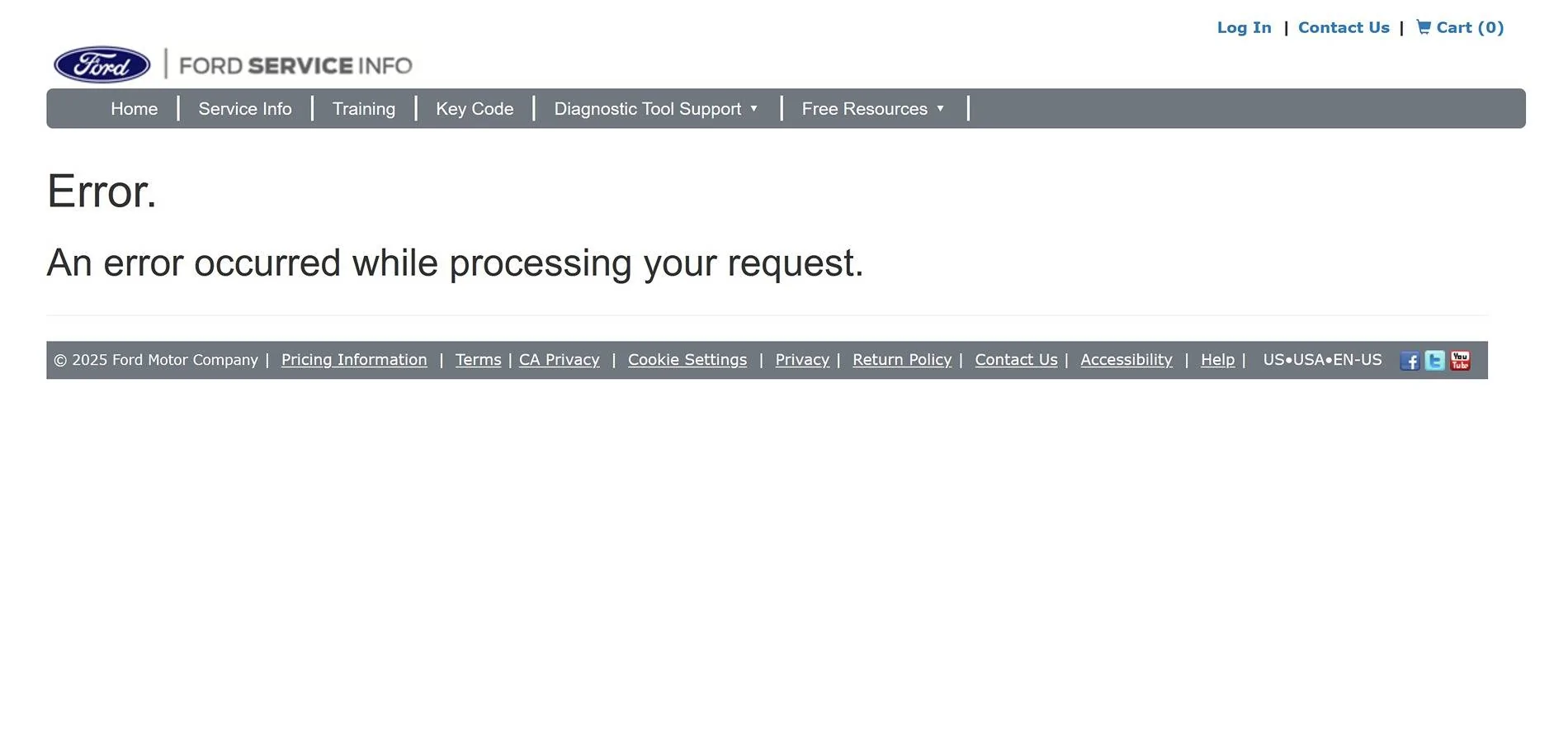

Alright, dumb question. Where did you create your account? Every link I've found either directs to motorcraft.com (which is giving an error when trying to login or create account) or I was directed to www2.helminc.com for license validation.
Which site credentials do I use to login with FDRS? Side note, neither work.
I feel like I just wasted $100 because the MotorCraft website is down.

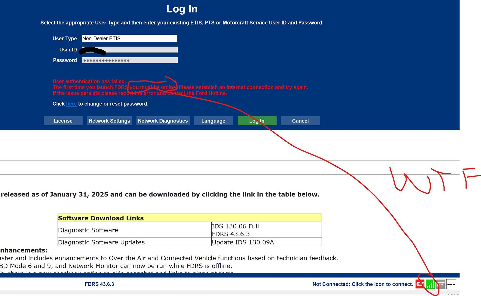

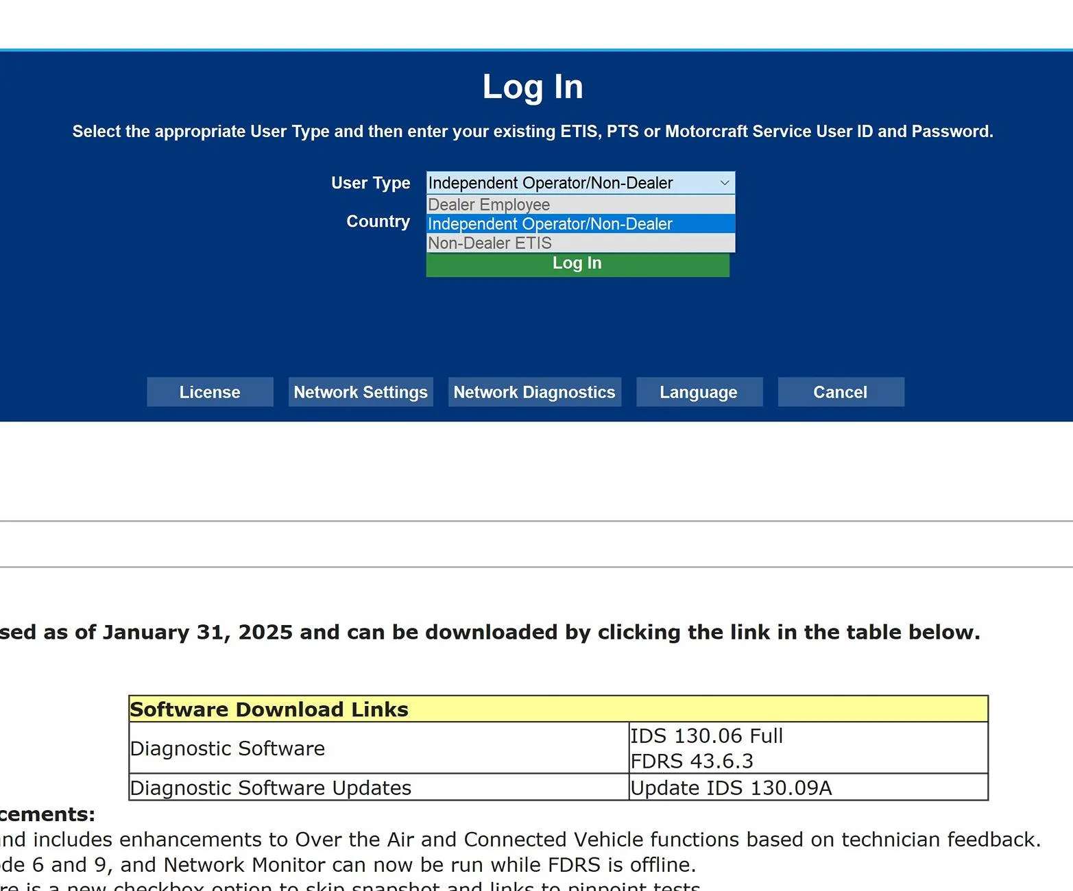

From the FDRS program, trying to login. All previous tutorials I've read indicate I should select "Non Dealer/MotorCraft" however thats not an option in the dropdown menu. I have the attached options.
Selecting Independent Operator/Non Dealer and clicking Login opens a seperate window requesting my Ford.com login credentials. I enter them and FDRS soft crashes. I say "soft crashes" in that the FDRS window just disappers. Alt-Tab does not register it as a running program.
If I select Non Dealer/ETIS, then I'm prompted or a Username and password. Best guess is I enter the credentials from the site I purchased the license from. Nope. That don't work. FDRS glitches somehow and says I'm not connected to the internet (yes, I am).
Not sure where to go from there.

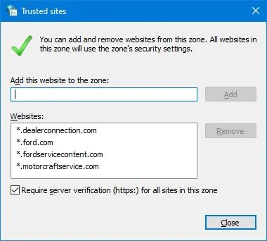

Yeah, that tutorial hasn't been updated (I'm supposed to work with the Admin to sort that out but haven't gotten to it yet), and unlike the similar page on the Mach-E site, the one on this site can only be edited by the original poster.
You do need to login as an Independent Operator/Non-Dealer. That's the only way you'll get in.
Having said that, and because I don't know what you've configured so far, I'll ask if you've added the relevant servers to your Trusted Sites in Windows?

Thanks for the tip. Added them as shown in your screenshot, but it didn't help anything.

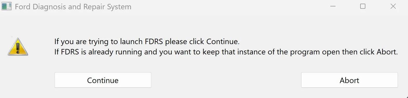

In the FDRS interface, I select "Independent Operator/Non-Dealer", click Login. New screen is launched requesting my Ford.com credentials. Enter the credentials and I'm taken back to FDRS window which pops up a messge "Logging Into FDRS", then the program just closes. No error message, no indications of success or failure. It just closes.
EDIT. CTRL-ALT-DEL does show FDRS is running in the background, but I cant open that instance of the program. If I just manually restart FDRS I'm given a prompt suggesting it's already running, but I can't figure out how to re-open it.
