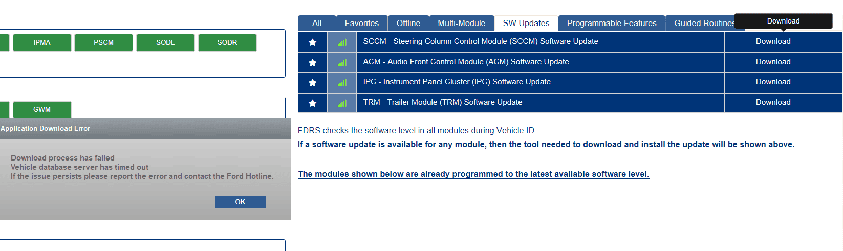

Now all I have is these 4 left and Download gives an error (also no modules listed as fully updated in the bottom right anymore?):
Ford F-150 Lightning ECU module programming guide using FDRS 1648243726897
All my modules are green. My wifi is fine. Is FDRS down? Is something else broken on my end? Have restarted FDRS etc...

I’m getting the error trying to download as well. Seems the ford servers are down or having an issue. ☹

I just got a login loop. Restarted FDRs and seemed to work. Downloading ok it seems

Yes downloads are back now thanks. GWM update is back now too.

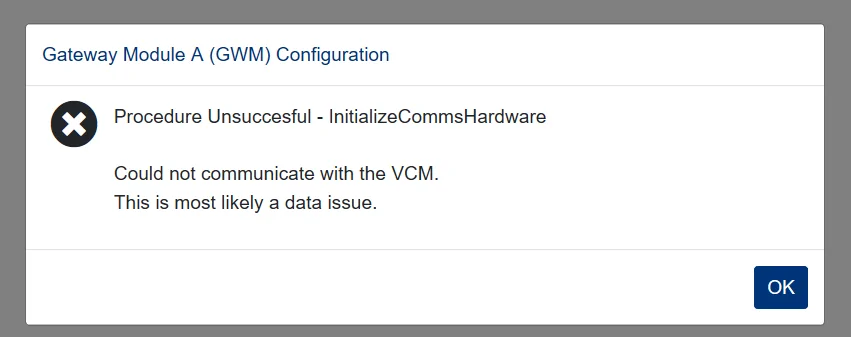

But I get an error,
ignition on step it communicates fine, ignition off it gives a comm error
Ford F-150 Lightning ECU module programming guide using FDRS 1648246043725
happens with either a GWM update or a config. have tried a dozen times. I'm still connected fine otherwise.
Jesse-Infotainment
Jesse
740
741
2024 F150 Lightning Flash
Leave ignition on.
jordandev
Jordan
Feb 26, 2021
107
Leave ignition on.
Thanks. Yep tried just leaving it on when it tells me off but same problem comm error
GWM update has dissapeared again so can't try again now. Something odd going on.
But I get an error,
I was having the same issue, I waited till the next day and it started working. I think your truck needs to report to the mother ship that it is good to go.
