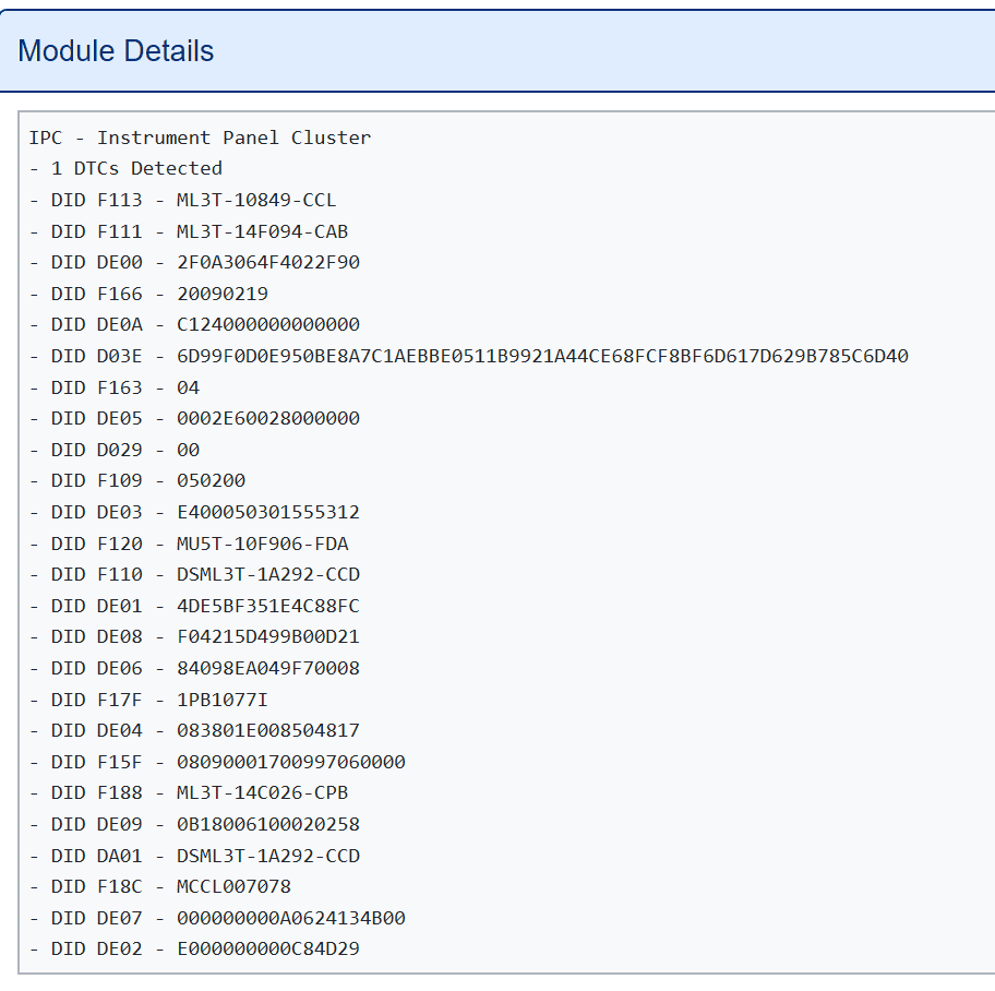

You have the same issue as the others with the update not completing.
Need to see what your files are. do a network scan go to IPC see what files are actually loaded.
When you go to FDRS and it shows the list of modules select the IPC and scroll down and show what the files are.
Here are the modules in IPC:
Yeap exactly what I said.. Notice 188 that is wrong. That will need to be corrected before you can move any further. I can correct it. Once its corrected all updates will proceed. Ill have to remote in through teamviewer. When I do Ill need you to be hooked up to the truck same as you would be for FDRS.
Do you have an active Forscan License?
