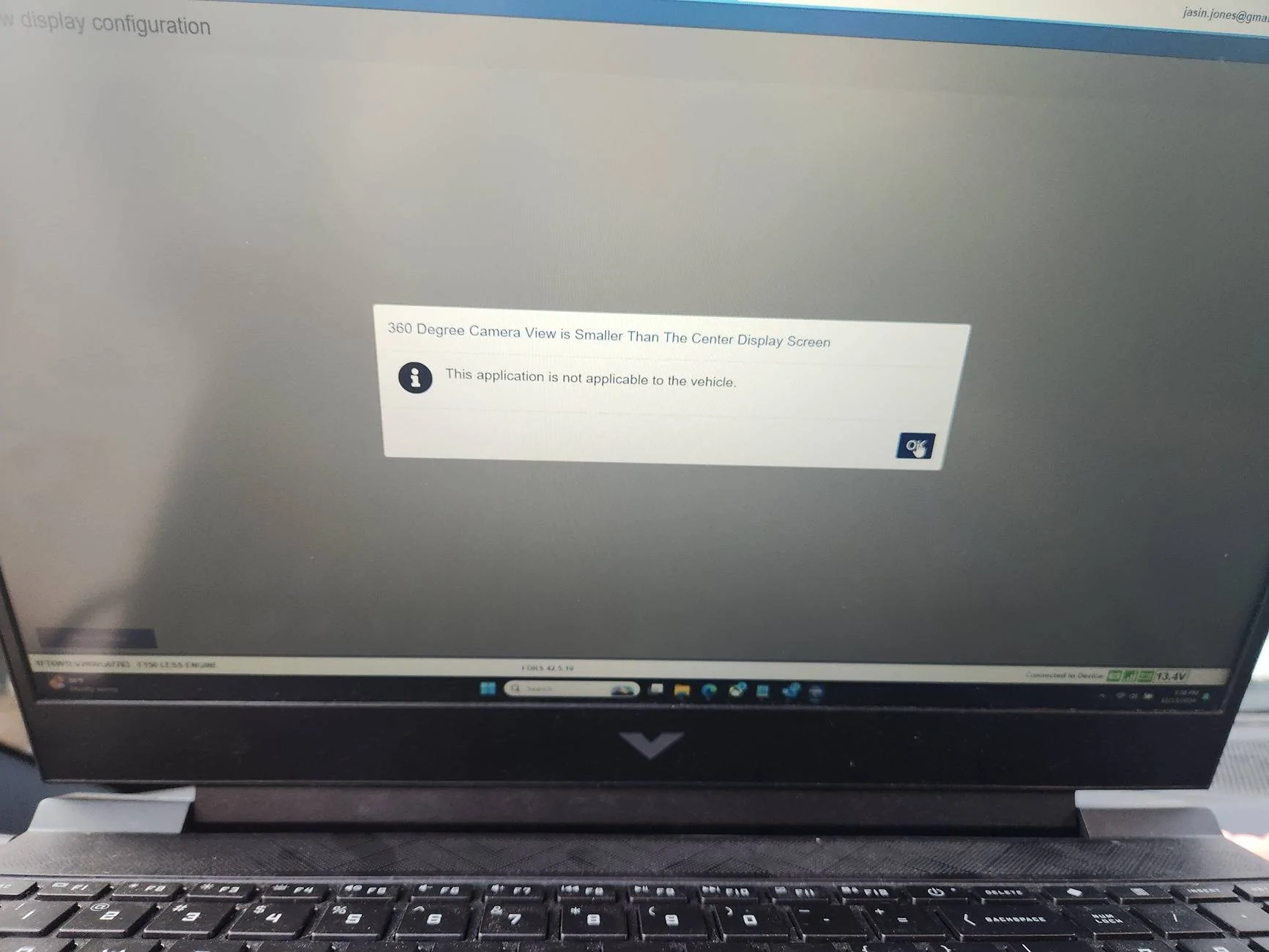

So I attempting the 360 camera fix and I am getting this
The bottom one is what I am seeing right now
Wait, what is it you are trying to accomplish here? Are you trying to get 360 view to be larger on the screen?
Yes. It is suppose to be fuller like it was prior to the 24b56.
I just did the FORScan fix under 7D0-01-04
It is fixed.
