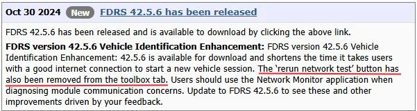

And yesterday FDRS 42.5.6 was released.
Ford F-150 Lightning Lightning Software Updates using FDRS FDRS_42-5-6
So no more spamming the 're-run network test' to see if new updates show up I guess.
Also since this is a major (41. to 42.) update remember to tick the box for 'remove user settings' during setup so you don't end up with weird results. They may have changed some of the layout internally.

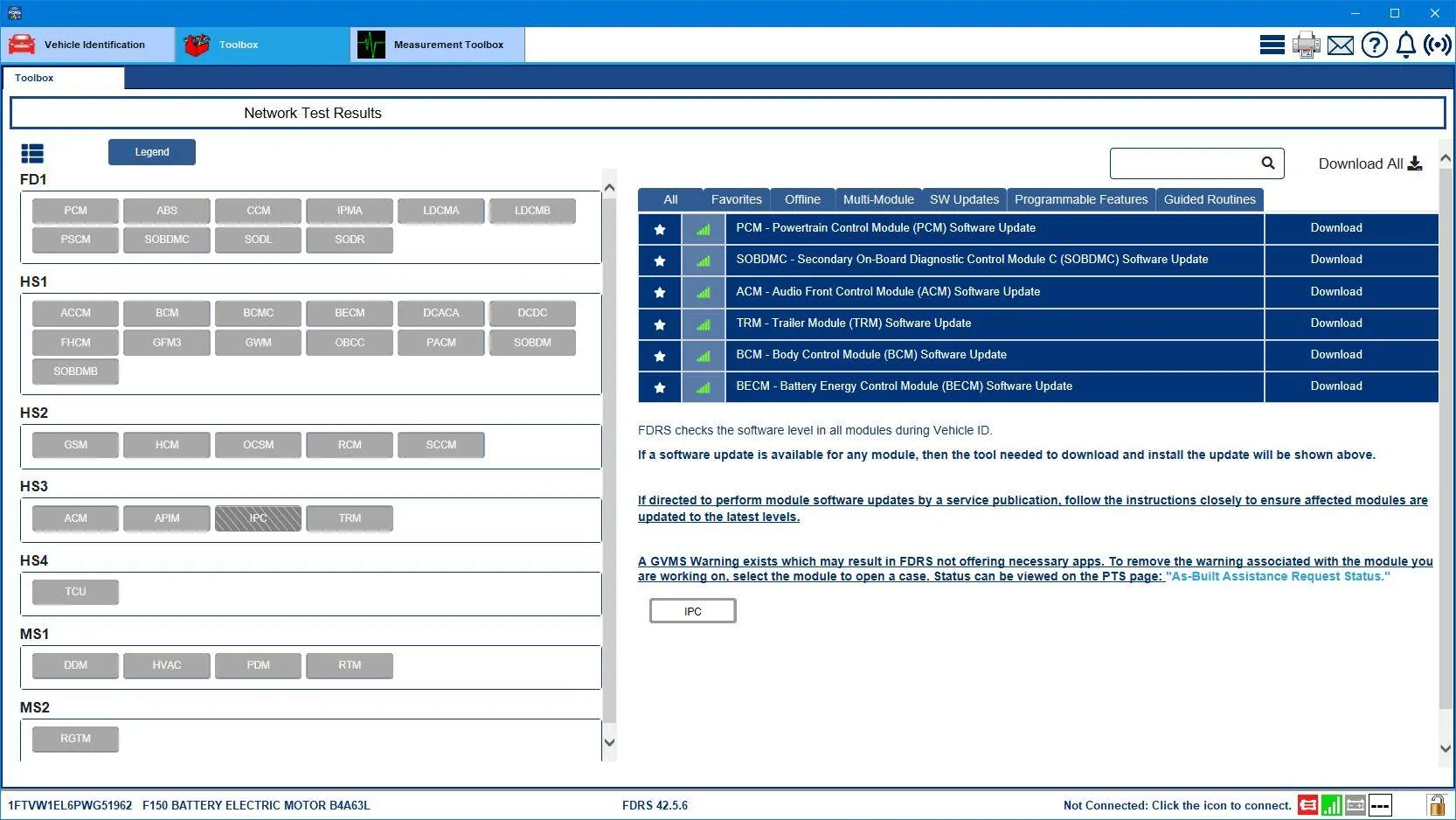

Tonight while out and about I noticed that the Power-Up 6.8.0 update didn't complete. I updated all the modules, some several times, in early Oct and I now have the battery percent displayed. Not sure why this update is trying to be installed or why it couldn't complete. 1FTVW1EL6PWG51962
Mike G
Mike G
Jan 6, 2022
1,583
2,262
N. AL, USA
Weirdness with your truck. It's not pulling up any connected vehicle info at all. No OTA history. No VHA history.
Assuming you haven't turned off connected vehicle toggles in Sync:
I recommend you go out and disconnect the 12V battery for a couple of minutes and then reconnect to see if that clears things up a bit.
Also, you show a GVMS warning on your IPC. Not sure what that's about. So that's either on Ford's end or on your end. But the server thinks your asbuilt settings in the IPC aren't right for whatever reason. You can try running a "Config" on the IPC using FDRS to see if that will put the server saved settings back into your IPC and clear the warning.
I'll disconnect battery for a few and check connected settings. I did use Forscan to turn on glare free lights per the Forscan thread a few weeks ago. Would that cause some of this? I save the original settings so can reverse, if needed. The glare free does work.

Disconnected the battery for 20 to 30 minutes, checked and connected vehicle toggles are on. Took it for a drive before I disconnected battery. Do you see any changes?
