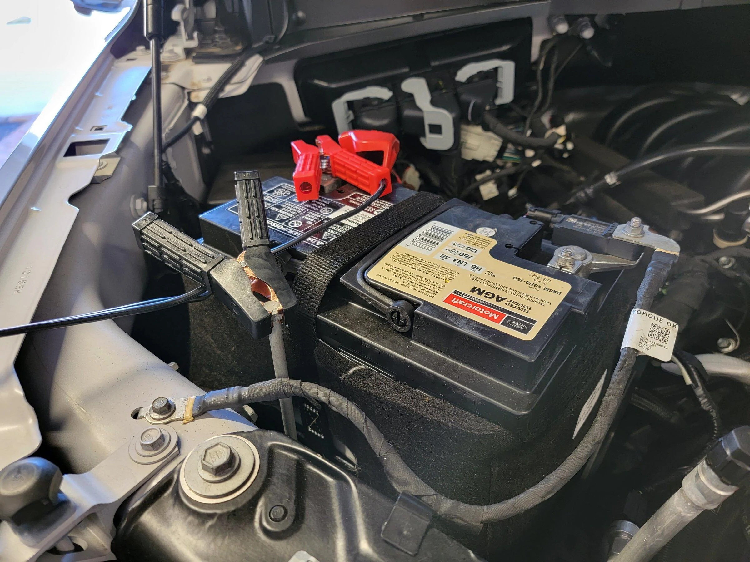

Can someone please tell me exactly where the two battery charger ends are connected to, and in what order you connect them to the truck?
I see in the FAQ picture that the black cord goes to that little post... but where does the red one go? The linked PDF didnt shed any light.
Connect to the positive battery terminal first then the ground post last.

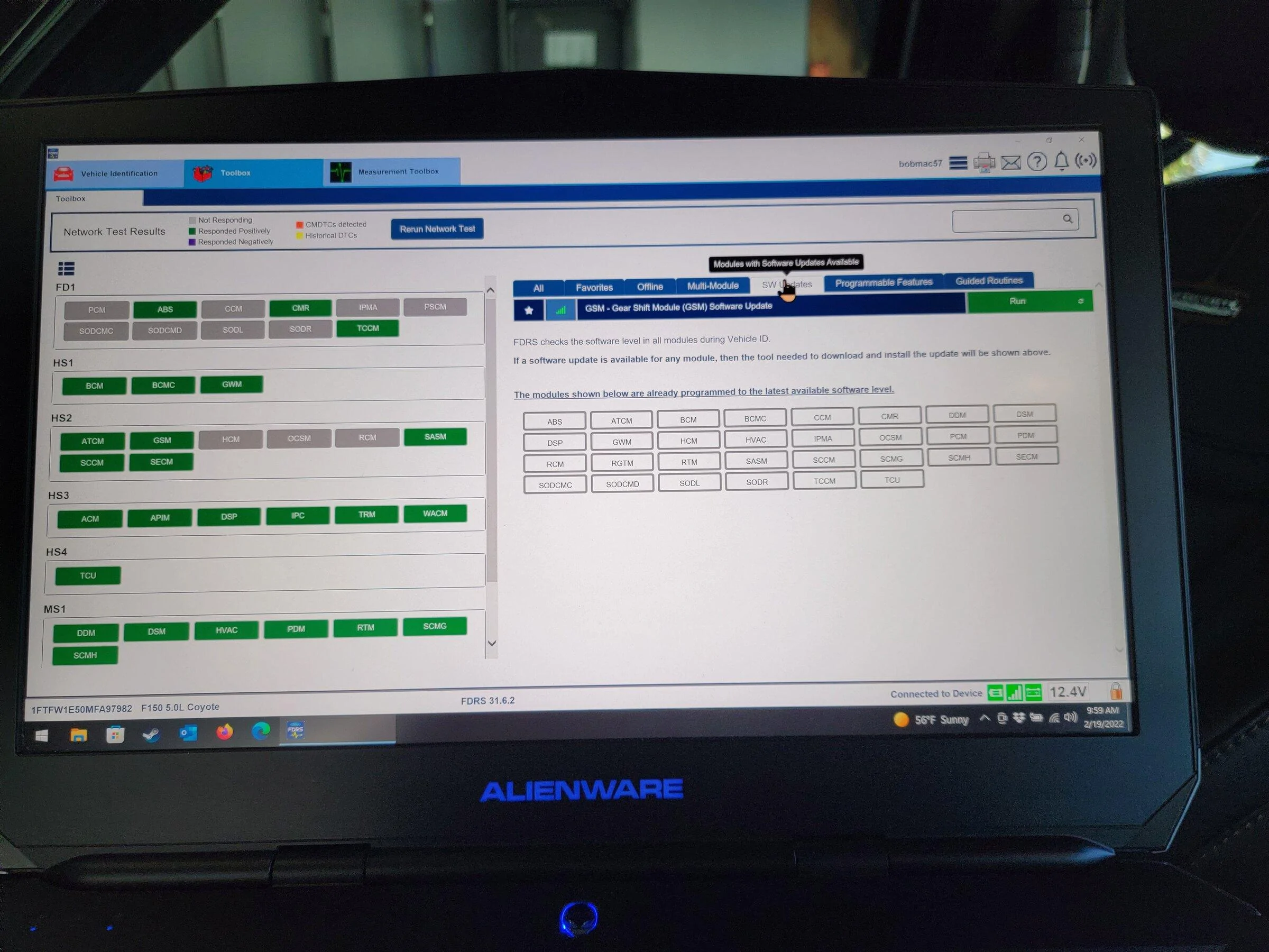

Appreciate the doc update. The technology stuff isnt an issue on my side, but I dont want to fry my electronics by hooking up the charger incorrectly.
Another question: Inside FRDS, when I select my VXDIAG - J2534 and hit ok the box never disappears. I have to hit cancel to back out. Is that normal? The setting sticks fine.
Does the device show connected (Connected to Device) in FDRS on the bottom right corner?
What step are you at?

Sorry @Bob_Mac
newbies like me at this are taking your instructions doc to the letter being cautious.
My first mistake - thinking I need the VX Manager running and online, we’ll it doesn’t. Reason I thought that was what @windowsmedia10 posted and I was at the step and thought something was wrong so hit cancel and move on.
second is the steps to connect I think are a little off like when to plug the VCX nano in and power up. Then hit the connect to device in the lower right corner.
also when you refer or do not run network scan do you mean do not hit the rerun network test button?

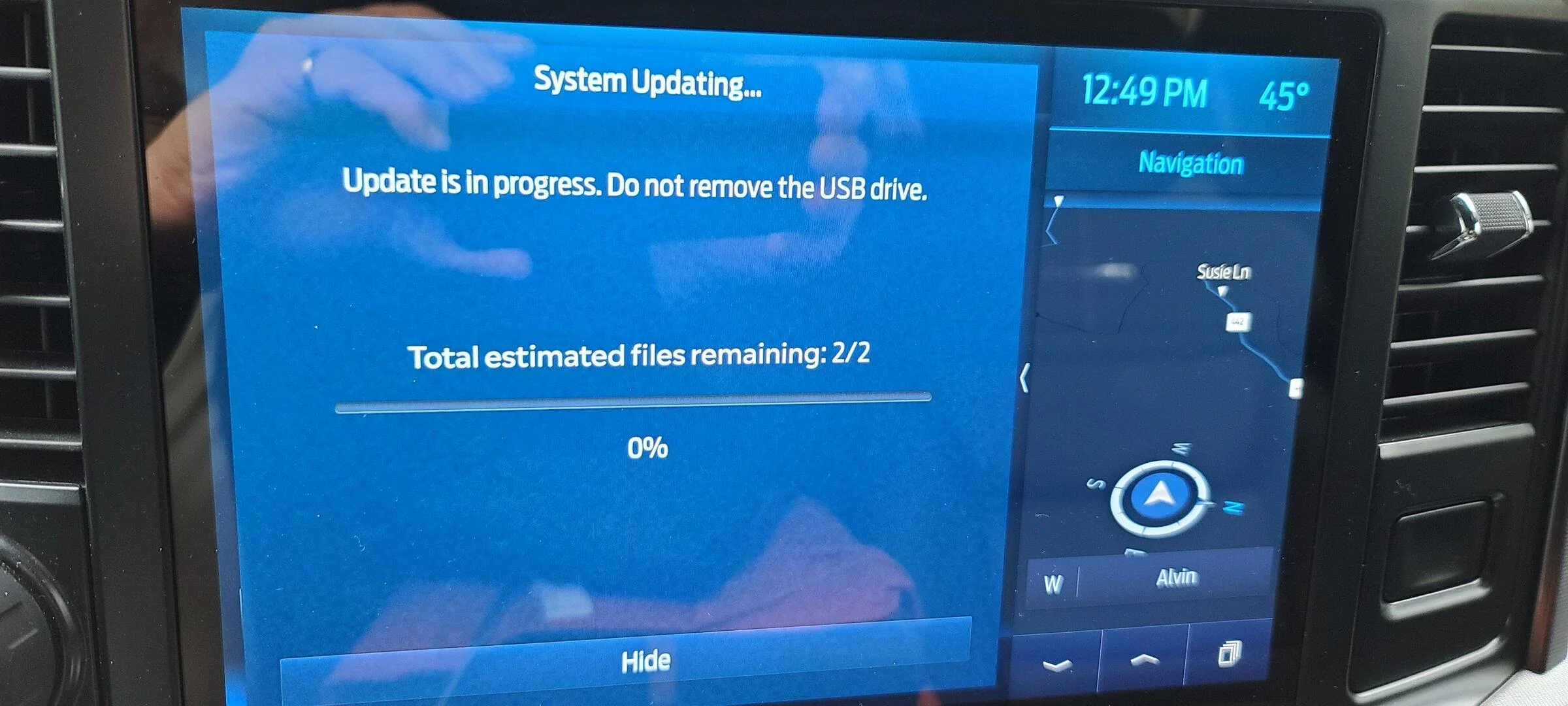

It's a little nerve racking to hook into the BRAIN of your sweet truck the first time, but it gets less scary as you succeed at a couple of digital surgeries. :)
Hang in there. Grab a warm cup of something and enjoy.
I'm back at it myself.
Ford F-150 Lightning ECU module programming guide using FDRS 20220226_124920
And yes @JEB it's the IPC, not IPM. Lol
Got a GWM update too. Wasn't expecting another of those.
