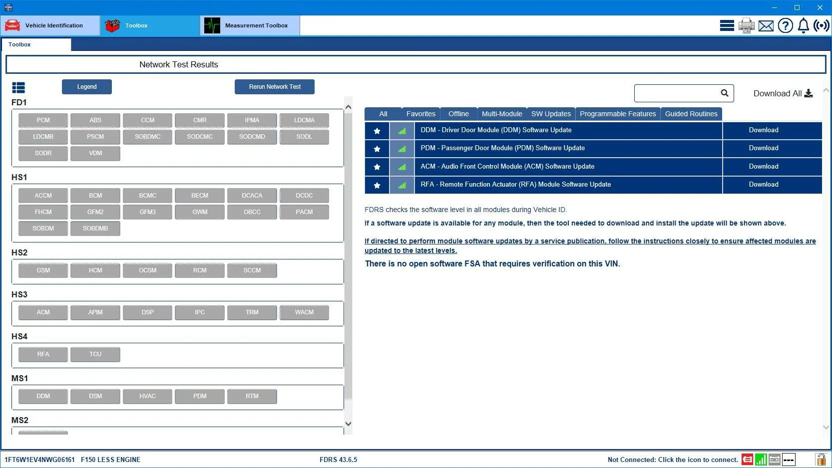

Good morning, Overnight release of DDM and PDM module updates today. No idea what issue they are meant to address.
Ford F-150 Lightning Lightning Software Updates using FDRS Lightning-DDM-PDM_22-Feb-25
I have checked at least one '24 model, and it has these as well. And I checked about five '23 models and all but one of them had these as well. The two '22 models I checked besides my own also had these listed.
Ran both updates and my truck made lots of noises (none near the doors) and used a lot of juice out of the 12v quickly, but each update only took 7-8 minutes. Could have probably ran both updates wirhout the 12V charger if I knew my 12v was really at 100 percent each time .
Both cleared FDRS and of course with an update like this , I noticed no difference.
