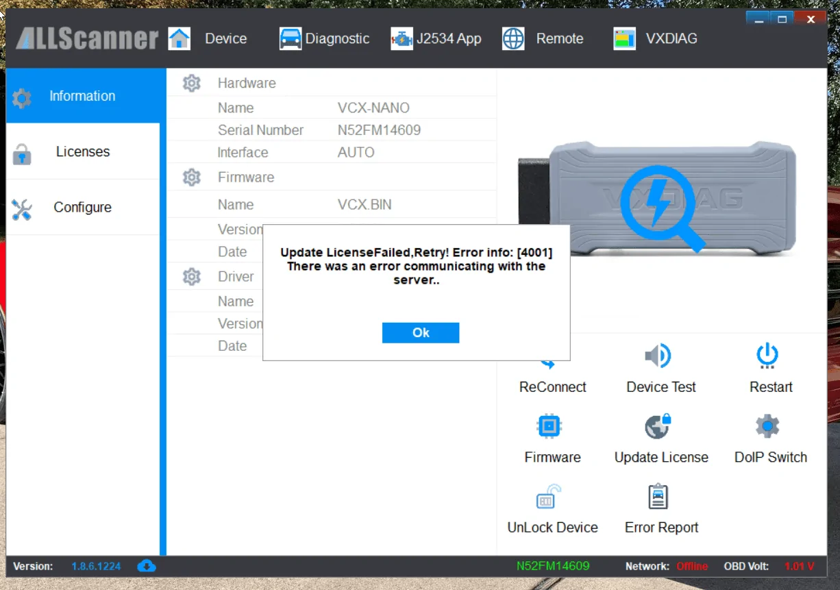

Anyone have connection issues with the VCX Nano? I got it online the other night but can't today.

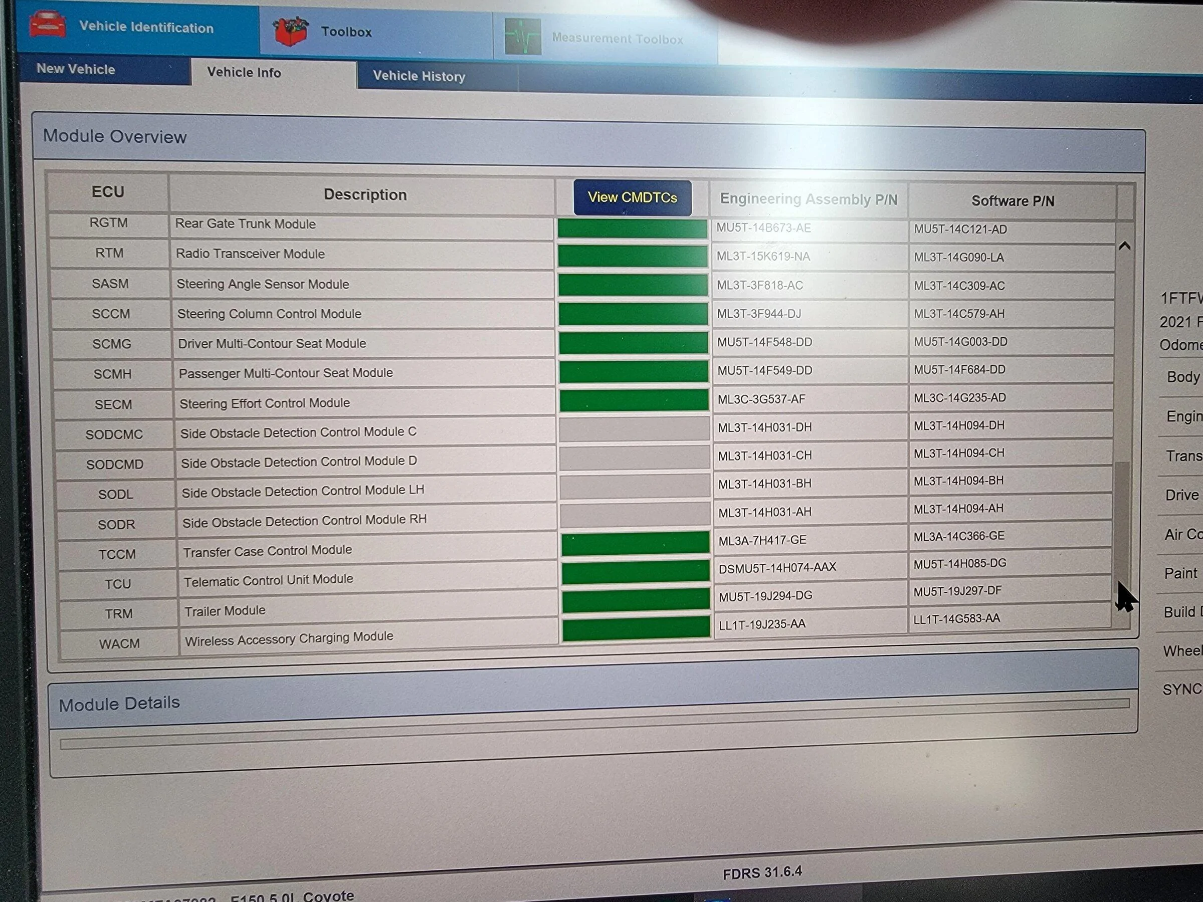

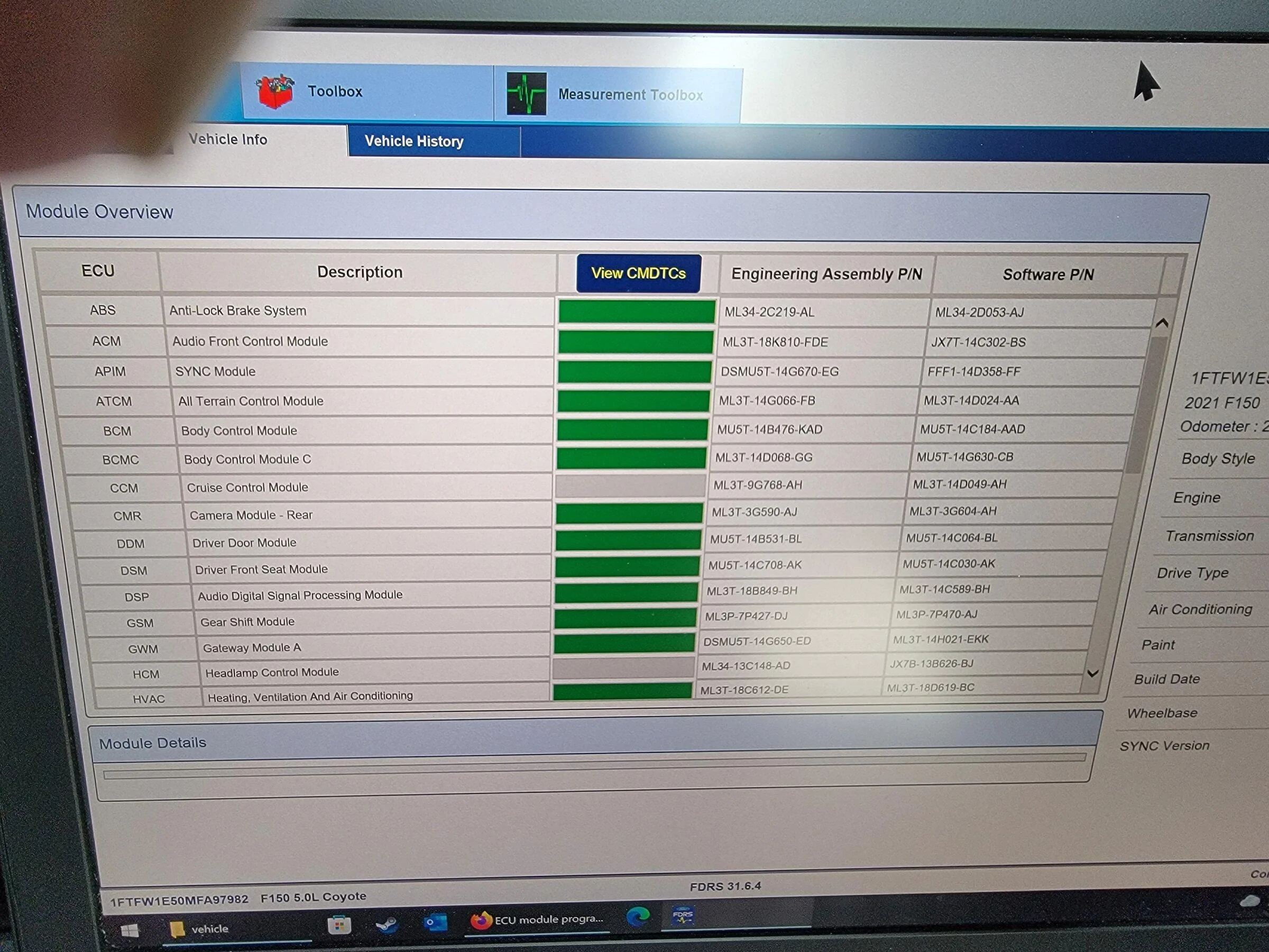

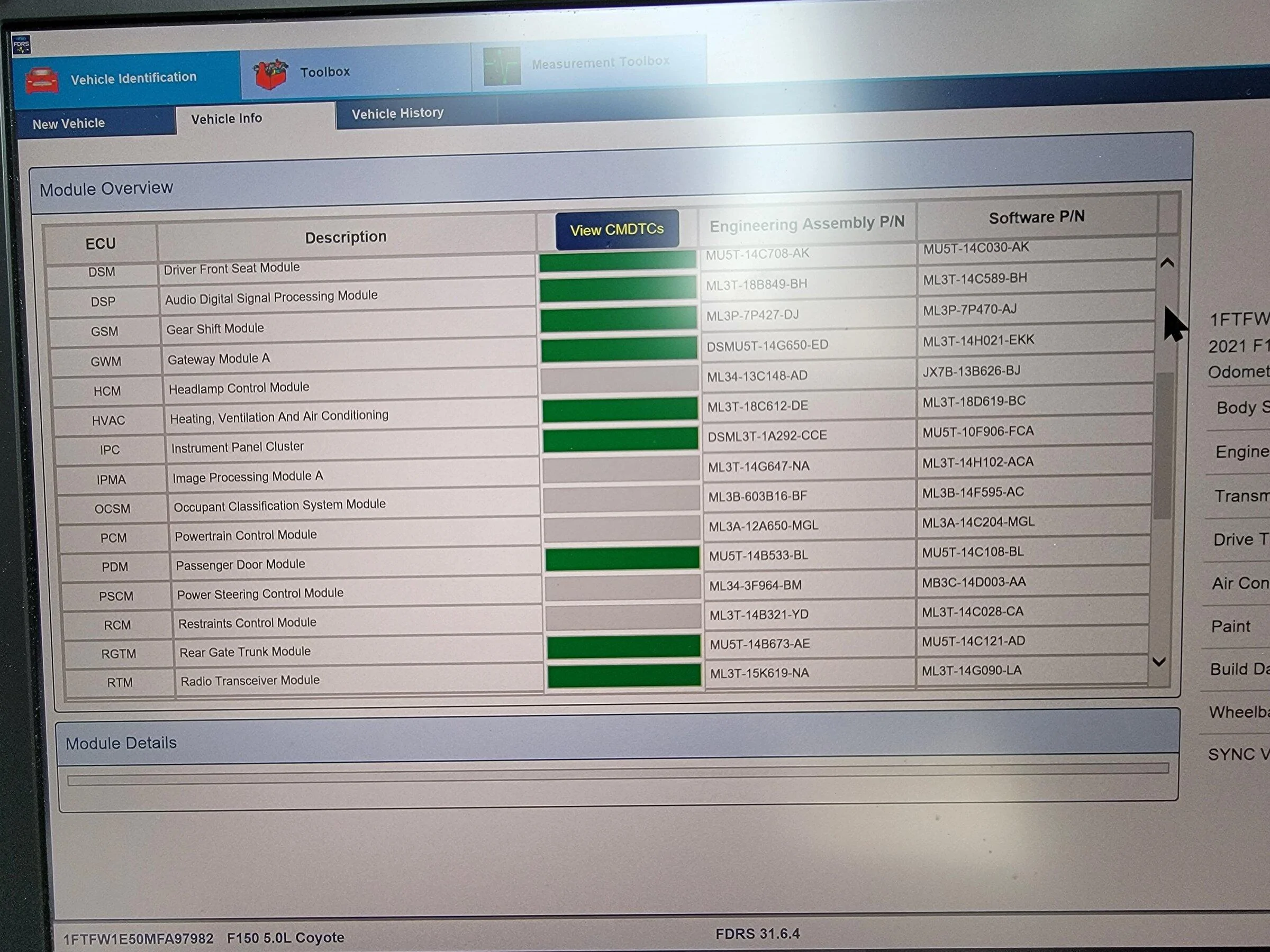

Ok everyone, my theory about the corruption issue being FDRS or Ford appears to be correct and not the J2534 adapters. I copied the JSON file which showed errors from the other day when working with @tonesto7 and connected this morning via the cloud and everything now appears good when doing a compare. I also compared the ab from the other day and one that I downloaded this morning and today's now shows no errors i.e. Software P/N, Strategy, etc. Also, FDRS no longer has the banner indicating issues... pics below:

I can’t connect, tried different laptops, reinstalling software Something blocking it from connecting to the server.
